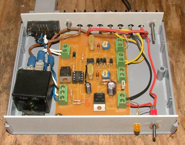

Teaser photo...
As you can see there isn't much to it, most of the work is done by the software in the PicAxe chip and the attached computer. A computer is only needed for logging, the controller will work fine without it, though you will need a PC for the initial setup. I use a relay to switch the load across the battery. I did consider MOSFETs, but relays are cheap and easy to use.
The controller sends logging information every second. I did consider increasing this period to reduce power consumption of the PicAxe, but total current draw is only 8mA, bugger all.
GlennEdited by Gizmo 2006-06-20

Gizmo, You say that it sends the info to a computer. Is that USB or RS232 or? Joe.
"Failure is an option."
Posts: 5188
Posted: 09:47am 20 Jun 2006
RS232 port. The PicAxe chips dont support USB, and serial port comunication is very easy to program. The speed is 4800, meaning you can use a LONG serial cable. The cable I'm using is 20 meters, but you could go several hundred meters. USB is limited to 10 meters tops. The picaxe sends the following every second..
[<V000V><A000A><R000R><M000M>]
Replace the "0"'s with real values . V=Volts, A=Amps, R=RPM, M=Mode ( dump load ). The V and A values are approx 500, calibration is done at the PC. R is pulses per second, again converted to RPM at the PC.
GlennEdited by Gizmo 2006-06-21
