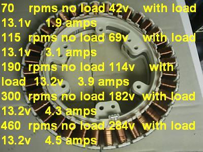

windman1000
Joined: 21/06/2009
Posts: 91
Posted: 06:42am 11 Nov 2009
This is a motor i was testing a while ago and i gave to my dad,it had very little cogging if any, i can buy the same for 50.00 , but i figured going from a 36 pole to a 42 pole i could gain a amp or two at the low rpms.
p/n 04ca44448
e21 5786 ss-130
ins class b cont
mb 4oc
model pom1300
dc 310v 094hp 5.5a 1200rpm
newmotech co ltd
2009.01.02 11:30:29
GWatPE
Joined: 01/09/2006
Posts: 2127
Posted: 08:06am 11 Nov 2009
Hi windman1000,
A typical iron cored alternator has an unloaded output voltage approx double the loaded voltage. This means that with the correct loading, that alternator should be able to produce about 600W at 460RPM.
This means that as a windmill, the loading should be approx 80W at 250rpm and 10W at 120rpm and approx 1W at 60rpm.
This is possible with a rewire and the magic of caps. This alternator should produce approx 50A into a 12V battery setup at 460rpm. This setup is calling out for a rewire. Reactance limiting is cruel, unless you don't need the power.
Were the figs above taken from lathe testing?
The unit looks like an LG.
Gordon.
