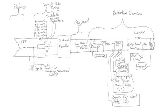

Hi All,
Just spent a while reading the Series Cap threads, and thought I'd jot down some ideas.
Hopefully the image appears ok.
Major sections are:
F&P Stator, producing 3ph AC
Switchable Series Capacitors on each lead from stator, with a shorting relay as well.
3phase rectifier the convert to DC
Very large Electrolytic caps just after rectifier to act as flywheel - potential energy store
zener diode to drop high voltage from genny and cap bank(could be in the hundreds of volts)
Small PicAXE chip to perform a few tasks:
Measure Cap Bank voltage(Vsense0), and
alter series caps(A-F) to obtain highest voltage for available RPM(from AC coupled Opto-coupler).
Can also bypass Caps(S) for testing/discharge
Measure Output Voltage(Vsense1) to determine load on system, and adjust PWM between 0 and 100% to suit.
Inductor, Schottky(s), and MosFET(s) form standard Buck Switchmode.
If PWM is 33%, consider it a 3:1 gearbox - 100V 5A from turbine becomes 33V 15A(ignoring losses) for charging 24V batteries. Cap Bank(Flywheel) continues to charge(speed up) while PWM is in off state.
In theory it might combine the ideas of the series cap, and buck PWM converters into one solution.
Load matching from Stator to Rectifier, then from Cap Bank voltage to required output voltage... I wonder.
Any ideas?

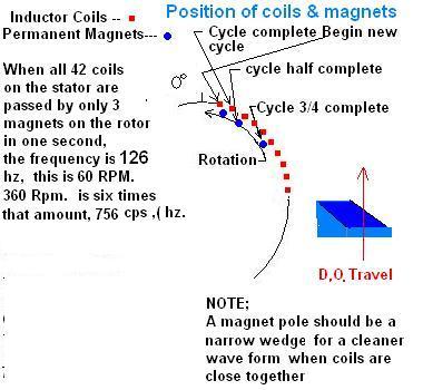

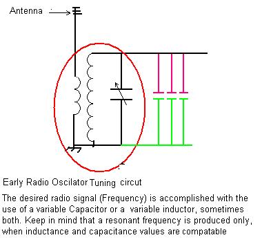

In radio a resonate circuit will pass the maximum current when the frequency of the signal remains constant. If the Frequency changes, then the circuit is un balanced and the inductive reactance is out of phase with capacitive reactance. The values must change to make the new frequency resonant. (Flywheel).
When The Coil of a alternator moves past a Magnet and moves on, an electrical cycle has been created, ( Dubbed Hertz (hz .) a few decades ago.
When using the number of coils found on the F&P washer Motor and many magnets, This alternator is capable of exceeding the household frequency at less than 60 rpm (1 rev. per second).
At 360 RPM, Well, Count your magnets and coils.
How about 650 rpm.

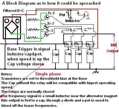

Now back to the Capacitors with variable wind speed and different coil windings?? Now a tiny radio receiver compared to a thousand watt generator sounds ridicules , But Here! How do you get 30,000 watts on a transmitter antenna to pulse at 1.7 megahertz.
In the case of wind turbines with Capacitors on the output it would seem that a means of switching a series, not series but parallel, of caps. adding and removing a cap when the wind changes would assure a closer match to a resonant circuit at all speeds. Perhaps a picaxe or similar chip with three or more outputs could switch a power relay for this purpose.
Note, this post is meant to convey a thought and minimal effort to the math I,m certain errors exist but the Mill
needs a tuneup. I am hopeful this will bring out the radio engineers.

Greenbelt...
If you read the caps thread in full... you will be very old.... but you may find that adding caps is far more complex than first blush.
The caps can change the PF of the alternator, change the effective MMF of the magnets acting on the coils, change the inductive reactance of the circuit with frequency and change the synchronous impedance of the system and armature reactance in particular.
They can push back the current limit curve, they can alleviate stall problems, and be used to boost voltage... or all of the above concurrently.
All thats not bad for two plates separated by a gap.
Gordon was able to mix and match caps and loads to get I think 1kw out of a 100 stator .... single.
This is without relays, without pwm, and without complex algorithms..... and the caps are dirt cheap if you look around for them. (when they are on special at Rockby's... cents each...)
So my recommendation is .... don't do it. Keep it simple. Use caps only, or at the most a boost converter like Bob's recently posted one, but never dynamic switching with relays.... I would add buck converting here too, but the F&P is current limited, so there is a finite current to design for..... otherwise no buck converters unless your a power engineer or have shares in fet companies..... it will end in tears. The relays will be clattering all the time... and if you add hysteresis, you will be so far behind the game as to be useless.
Rant aside, you already know the answer to your question. Being an old Valve buff (from your opening comments), think of your plate circuit. You have 400vdc on the plate "biasing" the coupling capacitor.... did it interfere with your audio signal, or change the cap value?
I don't wish to ruin your fun, and it is cool to dream up all sorts of high tech solutions to problems that have been solved simply before.... but the caps seem to solve the dynamic dilemmas better than our algorithms so far.
With Gordons axfx, the load matching is crazy bad . Without capacitors it would be unusable. But he has cube law buck and boost control with no electronics, and no magic smoke.... and has managed to match the load very well for miserable cost.... good outcome.
Have fun with it though.

About resonance. I have wondered why you steered away from it? After reading your post about loading problems
at resonance, I recall something I read in this Book. In effect, it says a resonant circuit contains infinite current and voltage is Zero??? this was in the very first
chapter, (tuning circuit). Without voltage to the load there would certanly be a problem.

  Greenbelt said  After reading your post about loading problems at resonance, I recall something I read in this Book. In effect, it says a resonant circuit contains infinite current and voltage is Zero??? this was in the very first chapter, (tuning circuit). Without voltage to the load there would certanly be a problem.
Hi Greenbelt,
This would be a node, probably be in relation to a filter design.
I saw this in parallel resonance, with the cap becomming effectively a short cct. Cap heating seemed to be the biggest problem, and we need to keep the caps cool for long operating life.
