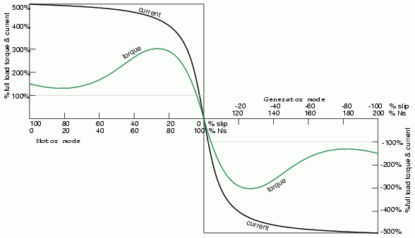

would somebody be kind enough to tell me , do i need to energise the field of an ACIM to use it for a generator ?
if this 5 kW 4 pole has its rating at 1450 RPM , then would i be getting approximately 2.5 kW at 700 RPM ?
is it roughly linear ?
(and 10 kW @ 2900 RPM if it was geared to get that fast)
i know efficiency will drop off below a certain RPM threshold
any experience with this setup ?

Q: do i need to energise the field of an ACIM to use it for a generator
A: Yes
Q: then would i be getting approximately 2.5 kW at 700 RPM
A: No
Q: is it roughly linear
A: No
If you want to use mains to energise the field then look at this site: breezy5.5
If you want to use capacitors to excite it, you will need to select the caps for the resonant frequency it will run at... usually around the label RPM. (1450)
Also, older motors will usually be better then newer cheaper motors. They used to worry a bit more about the laminations quality, and eddy currents were much lower. As this system uses the remnant magnetism in the rotor to start the sloshing in the tank circuit, eddy currents may hamper startup, as will some steels that hold little to no remnance.
Beware of over exciting (too much cap), as the voltage can get out of hand very quickly.
This system falls down if the load gets high or is inductive, as it kills off the resonance in the cap circuit... and it free wheels. This is a mill killer.

You don't specify how you intend to mechanically power the motor, but I'll assume for the moment it's with wind. If so, this site may interest you too. It's a windmill that's a tad more sophisticated than the Breezy:
http://windmolensite.be/generator.html
(see 'generator' for example)
For the benefit of other readers, 'ACIM' apparently means Alternating Current Induction Motor. Never came across this acronym myself, and took me a while deciphering it.
You can energise either by using the grid (when grid-connected) or by using capacitors (stand-alone).
More information on what you intend to do and why would be helpful in properly answering your questions.
The relationship is far from linear - when grid-connected, at 1450RPM it would motor...at 1499 RPM it would motor... at 1501 RPM it would generate.... at 1550 RPM it would generate even more. The term you're looking for is 'slip'. Googling that term will answer many of your questions.
The link below also provides a wealth of information:
http://www.allaboutcircuits.com/vol_2/chpt_13/7.html
You normally operate at maximum -2...-3% slip (motor) or +2...+3% slip (generator), or roughly between 1440-1499 RPM as a motor and 1501-1550 RPM as an alternator.
Peter.Edited by Dinges 2010-01-03

The other thing that complicates it a bit, is that the torque to slip is effected by the rotor bar resistance for a given power rated motor
The higher the startup torque design, the less resistance will be in the rotor bars. So compressor type motors which need high start torque will have very low resistance rotor bars, and so the torque changes hugely for a small change in slip.
Centrifugal pump motors which need very little start torque will have more resistance in their rotor bars, and seem more forgiving ... and so a little more likely to break away.
What this means is that the motor you choose will have a bearing on how you drive and control it.
