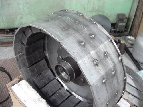

G/day Oz (and all)
Firstly . TY for your posts over at Fieldlines.
I had hoped to post earlier, but have spent a lot of time reading the entire board (66 pages)so my head hurts,my eyes hurt,my back hurts, and my a#$ hurts from sitting on it for so long .
To paraphrase Tom - that drum is "downright sneaky" and "thanks for the share'
Is that a F&P inside that drum ?
DO you have any more pics of it (and or the project) ?
You did say "the easy part is..stator the hard part is ..drum".
I have the sheetmetal and toolroom facilities to make both- just lack the know how
How would one go about producing the lams for the AWP stator and in particular the pressing of the slots.Then there is the ? of how to wind it.

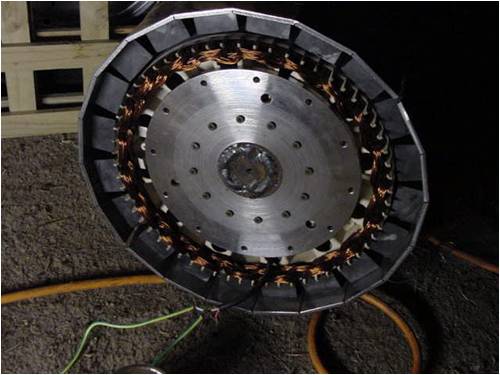

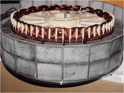

Here you will find a lot of pics of the drum.
It was a simple idea born out of desperation, and turned out to be the simplest and best way to do it I can think of.

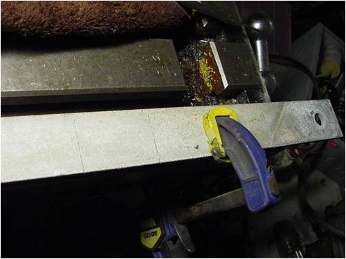

Those pictures should say it all. Keep in mind to make an accurate jig to measure the bend each time. Cut the bend lines through 1/2 to 2/3 the thickness.... and they must be square...If you line up three wide (I needed three) and cut them at the same time, suqarely, they will alll turn out fine.. If you do this you can make any size drum easily and very accurately. The cuts make the bend both easy and predictable. This means it forms itself, and you just tack it together. Don't weld heavily until it is completely assembled, or it may warp and distort. It is very very strong with just tacks.
So, start with your strip steel (mine were disused power pole braces) and cut the marks into it 1/2 way through with a hacksaw (or those 1.6mm cuttinng disks)... squarely. Like this:

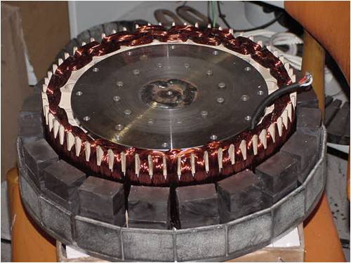

I mounted the axle and stator on the drum plate, so it was in the proper position...like so:

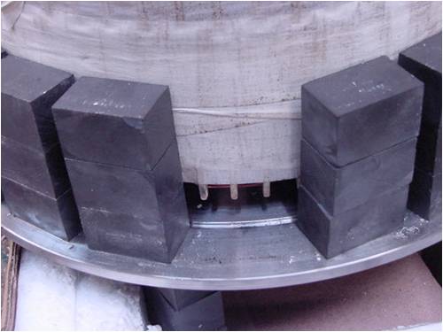

I then used as many turns of masking tape as I wanted air gap, and held the strips to it to form the drum.. spot weld and your good as done.
Second layer mock up.
what it looks like:
More odd stuff here
stuff
It is not simple to cut out AWP type stator stacks. It is very simple to get better results than the AWP by using the ststor from a big motor as Flux has shown. The stator is the easy part, the drum is impossible to find so that it gives you the airgap you need. Usually you have to compromise for what you can find.
The flat steel drum, allows you to design for what you want, and what stators you have available, and build the drum to suit after the fact...
I used 3 mags glued together to make each pole. It is not too simple trying to keep them together until the glue set.

Now I'm totally confused that stator Oz looks to me like a seeley not a AWP. I did do a search on FL for your files and the only drum story was on the seeley. The big concern I have found here in south oz is the plastic used in the f&p and the seeley have gone brittle in like 3 months out in the sun and weather. I suppose thats the main reason I've gone the motor conversion route and oneday I'll do an axial flux using 50x25 round N50's.
Cheers Bryan
oztules
Joined: 26/07/2007
Posts: 1686
Posted: 10:09am 15 Jan 2010
Bryan, that is the seeley..... be confused no more it's a 20 pole radial seeley with extra magnet. I trusted the plastic housing as much as you.
It was aired to show Angus the drum formation, the seeley stator needs a rewind and neo's to be a useful performer I think.... and then the iron drag will be excessive from my perspective..just something I played with.
.............oztules
