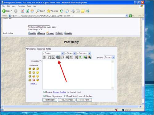

I couldnt find the 1KW turbine post a link to the specific page using the world with chain button in the box above

Agreed. If you are a machinist, have a lathe and mill, that is light years more than many of us have. That's why I used the car parts for my first genny (brake disk, wheel bearings and spindle). Karl, I can't find the world with chain button, but if you google the words "diy 1000 watt wind turbine" it is your second entry and takes you right to it. www.instructibles.com is the site.

[Quote=smithbr67]Karl, I can't find the world with chain button . . .
I think KarlJ is talking about the 4th little box in the "Post Reply" box at the bottom of the page. It's the link you use to set a "hyperlink" into your post with.

This is what you are looking for.
Follow the instructions provided when making the hyperlink.
