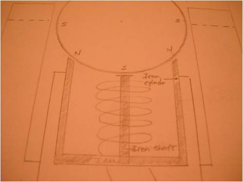

What if there were a way to get the electricity from the generator atop the tower down to the ground without having to rely on brushes (which fail miserably) or by letting the output wires from the generator simply wrap around the tower, having to be unplugged and unwrapped when they restrict the windmill from yawing?
I haven't built this yet, but it looks like it may have some promise.
The idea is fairly simple. I will build a carrier, which will hold the windmill shaft while pivoting about the tower. The shaft will have a wheel loaded with alternating "N" and "S" pole magnets facing out radially. The wheel will be suspended above the top of the tower through an opening in the carrier.
A large-gauge-wire coil will be inserted down the center of the tower in a stationary position; its output wires traveling down the inside of the hollow tower and exiting through a hole.
As the shaft spins the wheel containing the magnets, they will alternately charge the canister with either "N" or "S" fields, while the center pole of the coil will have the opposing pole all at the same instant. As it rotates, these poles bounce back and forth, causing the magnetic flux to run one direction, then change and run the other way -- back and forth, inducing an alternating current in the wire of the coil.
As the windmill yaws (spins about its vertical axis with changing wind direction), the magnets continue to spin over the center of the tower (into which the iron canister and central core are immovably positioned), so as their position swivels, the relative orientation of the magnets to the poles does not.
Take a look at this diagram and you'll see how it works. As soon as I can scrounge up some iron pipe and a welder, I'll put one together and see how well it works.

You may be right. I was merely trying to make electricity and then get it down off the tower without wires wrapping around things or having to use carbon brushes.
Theoretically it should work, but I'm not sure how well. I'll make one and then we'll know. For now, just study the little picture and if you've ever taken apart one of those little bicycle generators that has a knurled wheel, which rubs against the tire, you'll recognize the insides are arranged very similar (magnetically speaking) to the way this is set up.
I think it will work; I'll let everyone know either way.

Of course I know perfectly well how those bicycle dynamos work - they were the source of my first magnets at age 6 or so. You'll find such a dynamo on practically every bike here. Recently replaced the one on the recumbent, a fancy one with dual ball bearings (Sanyo). Runs *very* smoothly. I love those dynamos - very simple technology, no batteries required, always there when you need them. And back in high school, when I used to have a kink in my front wheel, school mates could recognize me from miles away by the rhythmically on-off flashing lights at about 1-2 Hz....
I think I'm getting your idea, but the stator would require a hollow spherical shape. Bit hard to make, though milling, grinding or EDM could work. Also think it would make less-than-perfect use of the magnets, as only the very bottom of the rotor sees any coil. And you'd have to find a way to prevent it from cogging.

As for the spherical shape of the area into and out of which the stator must swing, I intend positioning the central core slightly lower than the edges of the iron canister -- to match the radius of the stator's swing.
I cranked up another way to utilize a coil wrapped around both "legs" of the iron core and canister, but it really is weird!

MacGyver,
Take off your thinking cap for a moment and put it back on sideways How about solving your electrical mousetrap conundrum with a mechanical one?
A bevel gear comes to mind (I have a nice one here). Feed your HAWT input in and get VAWT rotation out for any wind direction.
Should be all straight forward from there - no more thoughts about twisted wires or slip rings to loose sleep about [LOL.
Very little efficiency lost for relatively little added mechanical complexity.

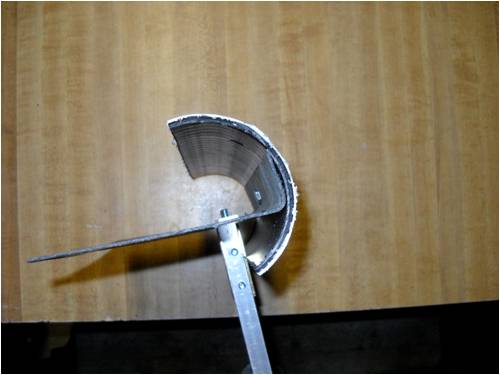

I think it's time for a little VAWT update:
I made a small design change to the "Lenz" turbine blade. I added a half-pipe tube to the leading edge of a flat wing and it seems to help catch wind on both the outside and inside surface of the blade, although the VAWTs operation is still nothing to write home about. Maybe I should have enclosed the top and bottom, but I didn't. Here's a shot looking down from the top of one blade.
As much as I wanted the VAWT to work well, in that it was so simple and easy to build, sad to say, even with the design change, in actual operation, it just doesn't cut it.
We're having lots of rain and high winds and even though it scoots when the wind's screaming, as the wind slows, the mill's power drops off drastically. This is likely due to the fact that the momentum is left to push those half pipes through the air, eh?
If I can get this thing to "fly" like something special, I'll try to put up a video somewhere.
I'm keeping it around for a while. Heck, I took my time making the bearings run like a champ, might as well watch it whir. Maybe the windmill fairy will smack it with her magic wand in the night!
That means I'll switch gears and try to get this "Better Mousetrap" HAWT off the ground. Really wish I'd called this thread something else!
