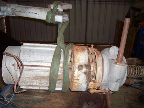

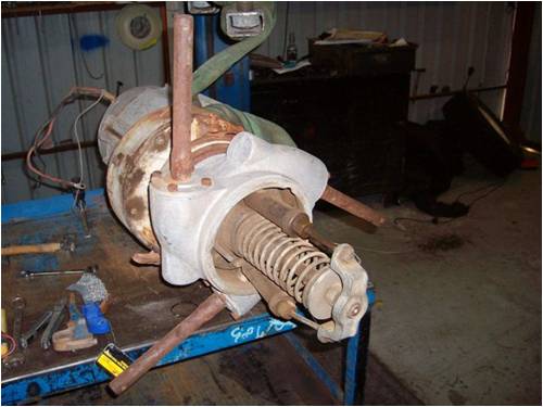

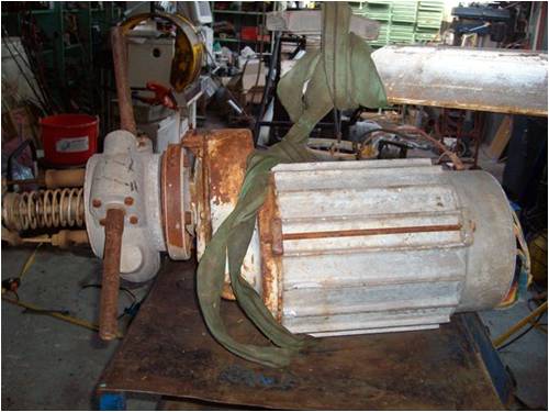

Hi Guys I hope someone can help Identifying this old wind generator.
It has no name plate only stamped 48Volt

Hi Jim
There is lots of moving parts but they are all very well made.
Iam well into recondition this unit now after testing to generator and all seems to work fine i decided to fix the old unit and put it back into service.
I currently have a few other generators runing at the moment so it will be good to see a old girl run again.
It is going to be a big project having to build tower to handle 450LB weight when laying down.
I will keep you posted.
