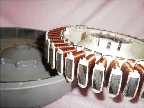

did you de-cogg like this
This shows poles twisted then high spots removed.
Should have take you about 15mins.....

For filing the stator I use an angle grinder with a flap wheel, normally I just knock off the high spots as shown in the pic or bolt the stator to the bearing block with the shaft, hang onto the shaft and use the angle grinder to true it up whilst spinning, doesnt take much and takes probably 20mins all up.

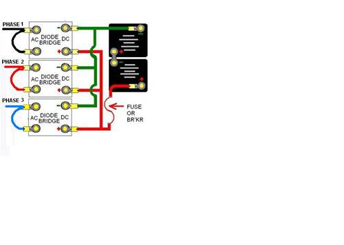

Buy some of these from Jaycar or equivalent Ebaybridge recs
FOr 7 phase you will need 4 of them and for three phase you will need 2 of them, now that I have some experience under my belt I'd go for three phase and have each Phase on its own REC as shown on the otherpower forum
F&P rectifier
That massive heatsink is not required for F&P size mill but I would recommend bolting them to a piece of Aluminium angle 1"x 1" with an inch between each one at or some heatsinks extracted from a PC power supply (hard rubbish they are everywhere)
Jaycar do have some that suit the square ones nicely but you'll spend almost as much on the heatsink as the recs.
Something like this may be a cheaper option and work just fine for three phases 90A bridge rec 3 phase

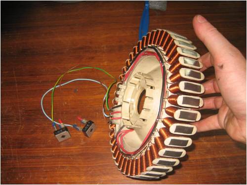

I have took some photos of the stator and I have no idea how to post them.

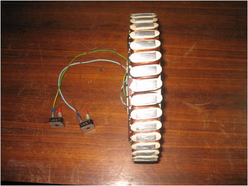

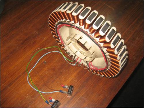

Here are the images of the stator.
Greenbelt
Joined: 11/01/2009
Posts: 566
Posted: 06:57am 14 Feb 2010
dvn8;
I have never seen a modified F&P other than pictures,
The one you have pictured here appears to be short on the number of output wires, I see what looks like 6 output terminals which I would expect but no wires coming off them to the diodes.The phases may be short circuit at the
diode connection. this would surely make it difficult to spin. The 2 black wires circulating the stator is probably the pair of one phase The Red another phase, The third is
not visible here, may be at the terminal strip solderded
directly. I don't understand the bare wire connected to the diode, maybe some one can enlighten me on this.
I'm waiting for the ozzie ax to fall!..
This is how I see it.if this be wrong? Let it fall. PS. You can learn about the back to back capacitors when you get some voltage showing. Hang in there you have a good start.
EDIT;
Re draw image to show terminal jumper wire on AC. Output X Y Z.
Edited by Greenbelt 2010-02-27

What is the stator wired for star or delta??
What config of coils have you used.
Pete.
Sometimes it just works
KarlJ
Joined: 19/05/2008
Posts: 1178
Posted: 08:24am 14 Feb 2010
Looks like the stock rewire for 7x2C in Star to me
Well Done!
Chopped every six coils apart and wired accordingly.
OK to share a rec across two phases.
I trust you have bolted the magnet hub on the shaft and bearings and given her a spin now the rewire is done?
If she still spins (generally you have got it right)
Now that she's reconnected no more lethal voltages being generated, thats good to.
