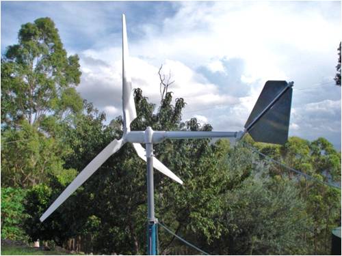

Hi Folks, Well ,after many years of playing around with F&P's I've now got an Exmork 2.5 Kw unit from China.
I'll still play with the LG and Seeley types that are stored away,, just now it's Exmork time.
The machine is very well engineered,very robust,a bit on the heavy side after the F&P , needs a bit of cosmetic work,(just nylock nuts and epoxy paint ).
I'm going to raise it on my existing 50 foot tower,after a bit of strengthening.
The machine comes with "everything" --controller,dump load, 30 foot tower, base and anchor fittings,guys,turnbuckles..
I've set her up on a testpole next to my workshop under the house with a 30 Mtr 10mm square 3 phase cable.
I get 1 Ohm between phases and can hardly move the armature by hand when shorted out.
They do say in the instruction book that the high end is 3.6Kw..,so ,we'll see.
as I said , i'm not deserting the ship ,just trying out something different and would love to put together one of Phill's ax fx in the future.(still have Trev's huge F/G blades to run yet).
Ok,,bye for now ,raining cats and dogs here....
Bruce

Now there I can see some REAL value.
what a beast!
Make sure she's well balanced before flying.
NOw lets hear some specs
Blade diameter?
Neo's or regular?
Whats with the funny lookin tail.
Heavy? How Heavy?

Yeah Karl, she's a beast allright...
3.8 diameter fibreglass blades that have a very nice airfoil section,,all ground for tracking in the factory,just ,maybe a shim here and there.Mine so far are very close 1/4 inch..
Neo's for sure,,you can hardly turn the shaft by hand when 3 phases are shorted-they have an electrical brake (Manual) and an over voltage brake.
Funny lookin tail ---sort of 3 inch tube to 2 inch tube ,then a 45 degree angled fin that I guess pivots to create the furling -watch this space..
Heavy ,,oh yeah. not your step ladder stuff,,the head would be a 3 man effort ,I used a gin pole and come-along...
The fin , a 2 man effort,that fin is 2 mm s/s sheet ,cut your leg off ,quick smart , if it fell.
The fin has this long axle with 2 bearings ,,just sort of furls when the wind gets too windy,I guess.
They say ,expect 3.6Kw in a howl. We'll see .I'm hooking it up to 48v triple bank of ,say ,3 banks of 800 Kw's,,
It came with "everything"
Bruce

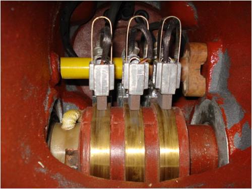

I'm curious about a couple things. First off, since you said it was really hard to turn when shorted, do you think it will cog heavily?
Secondly, how is the power transmitted to the ground; through slip rings or do the output wires merely dangle and have to be unwrapped from the tower now and then?
My turbine should be flying in a month or so and when it's up, I intend putting "stops" at each side of a 180-degree arc to stop the thing from winding the output wires around the tower. Our wind comes out of the west 99% of the time, so I'm not worrying about the occasional wind direction reversal.
Copeville, Texas
RossW
Joined: 25/02/2006
Posts: 495
Posted: 05:58am 17 Feb 2010
  MacGyver said   brucedownunder2
When not shorted, it turns reasonably freely, without any obvious cogging.
Nice, chunky sliprings.

Hi , I think Ross has answered all the questions. I'll add a few remarks, here are the slip rings ,real professional,,Oh, there are 6 slipring brushes in total 2 for each Phase
hard to turn ,,yes when 3 phases are shorted. Cogging ,very slight,can just feel it . With 3.8 Mtr blades it won't even be felt.
there are huge N35 neo's in there,for sure..
Bruce
