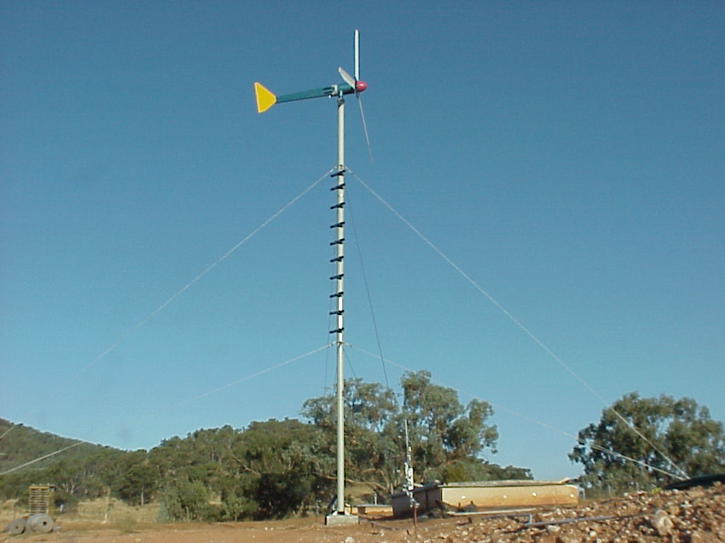

Hmm. I got one of those "cheap" turbines - the 1KW/1.5KW 3m dia jobs with 8m tower. (The first lot that came in aparantly). Yes, the blades were out of balance, but worse, they were out of line. Even with near-perfect static balance, the thing shook badly until I set to and shimmed each blade manually to get them all within 2mm at the tips (one was nearly 40mm out!).
What do you mean by "ripples" on one blade?
Mine has slip-rings, perhaps it's the smaller ones without?
Not too many sharp edges on mine, fortunately.
The wiring was indeed pretty ordinary though.
The electronic "regulator" it was supplied with is complete junk. Not worth using at all. In the first 2 weeks, I never, ever, saw it putting any current into the batteries. According to the importer, it dumped load until the frequency was stable. *WHAT THE??!* So I pulled the damn thing out and replaced it with 3 decent 35A bridge rectifier packs and an ammeter. It's been great ever since. We haven't had enough wind yet to put me in an overcharge situation, but I'll use the PL20 as a shunt reg if it comes to that.
The mast however well,... it seems adequate - just.
Supplied as 4 lengths of thickwall steel pipe with bell
ends, the mast is quite strong (but only 8.5m), but it was supplied with wire rope that was (a) too short and (b) too thin for my liking (4mm gal rope). They also only supplied enough "Crosby Clips" (wire clamps) for *ONE* at each end of each guy, and NO thimbles at all. I added a heap of clips and thimbles for each end, and sourced 6 or 8mm gal rope locally. I also got a length (6.5m) of 4" gal pipe to use as a gin pole to raise and lower it:
Oh, and the "steps" up the side are just 40x40 RHS held on with large U-bolts. It starts as far up as my ladder will reach (about 3m) - to stop the locals climbing up!
Here it is flying:

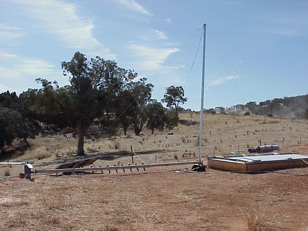

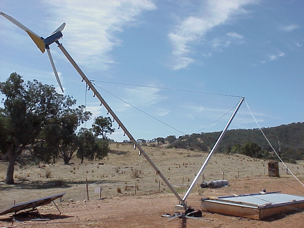

I didn't fabricate the mast - it was supplied in the "kit" from China. If I were to do it again though, I would use 4" thickwall gal pipe from a local source.
My old mast (comms mast, I'm an amateur radio operator, and use microwave radio comms in my day-to-day work) is a 47 foot self-supporting tower. I was always nervous in high winds, although it never moved.
I know guys are ugly, and can get in the way, but I like the confidence. I can walk around it and *FEEL* tension. I KNOW that if the guys are firm (but not at tight as a guitar string!) then things are good. I KNOW how hard I can pull on it before the guy snaps or the footing moves, and given basic trig, how much force that can "hold" at the top of the tower. In this regard, guys appeal to me.
We have a mob down here who make the concrete light/power poles up to about 30 metres I think. The smaller ones, about 10m are quite expensive - I think about $4K each, plus transport/installation.
The thing that scares me is if you have a decent size prop on the top, in a decent breeze, that is a significant (horizontal) force. Problem with that is that the turning moment at the base where it's mounted is vastly higher (think "leverage" - with a 10 metre lever!)
You probably won't know how close it is to keeling over until its too late! (I'm not just talking about the pole buckling, it's also the footings and/or attaching bolts)
If you just "dig a hole" a metre deep in the dirt, what happens after a week of rain and the dirt gets all soft and squishy?
