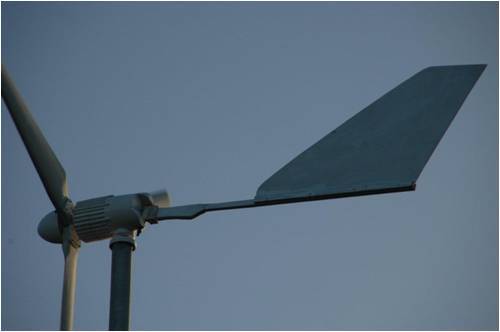

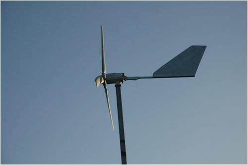

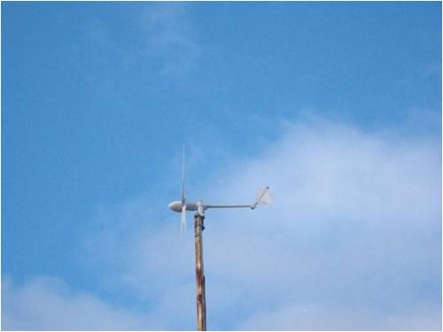

Bolty
Joined: 03/04/2008
Posts: 81
Posted: 11:41pm 26 Feb 2010
Hi Darren.
As mentioned mine is only the 1kW not 2.5 kW like yours. However by your description, the tail arrangement sounds the same as mine was originally albeit larger.
I live near Gordon (GWatPE) and he immediately recognized that the tail was far too heavy and like yours, it did not track very well. The excess weight meant that it would not furl early enough. Gordon explained that it was not worth chasing the high energy due to possible over-revving at high winds. Also at my site, the wind is very seldom over 10m/s. Thus it was considered better to forego the small amount of strong wind power in the interests of safety and reliability. To achieve this I cut my tail arm as close as possible to the pivot point, just where the twist became vertical again (around 25cm from the pivot) I then welded a 50 X 30 mm piece of tubing to the remaining cut tail arm. The new piece made the total length of the new tail about 400-500 mm longer than the original. As for the tail, I have a marine ply tapered shape that rises above the tail arm like a 747 tail plane. It is about 4 times the area of the original metal tail, and looks much better! Apart from weight increasing the furling point, I cannot see any disadvantages of having a massively larger area tail.
This has helped dramatically with tracking. As for furling, I never saw the original tail furl even in strong winds!. However the new lighter tail furls nicely before the wind gets too strong. I would be amazed if I am losing as much as 3 kWhrs a year through the earlier furling!

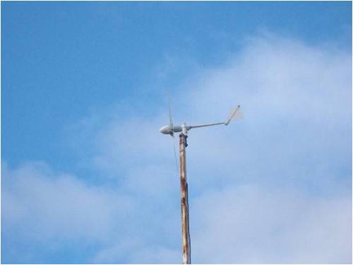

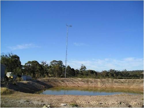

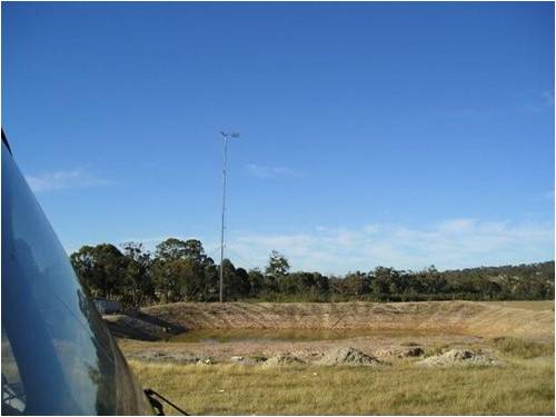

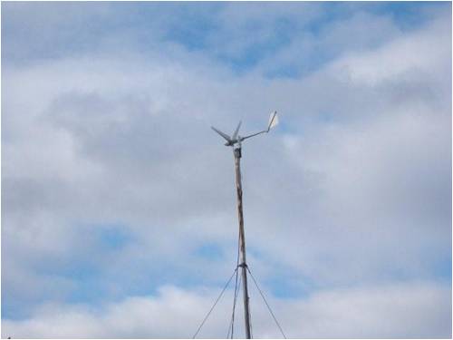

Posted: 12:47pm 01 Mar 2010
Here are two photos!

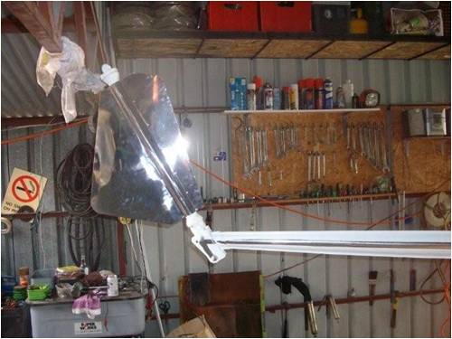

Darren
Joined: 13/07/2008
Posts: 20
Posted: 12:56pm 01 Mar 2010
Thanks for the pics bolty
Mine is very different in the tail section. I forgot to take my camera with me on saturday but I have some pics at work so I will post them tommorrow.
Darren
PS I like your Tail.

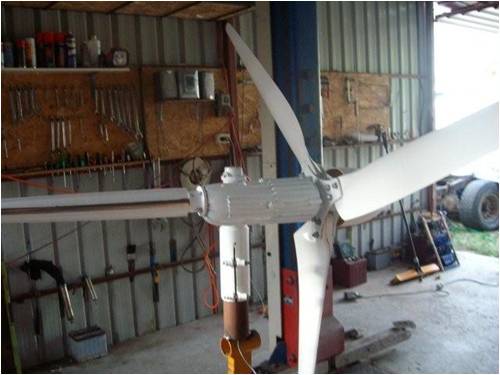

brucedownunder2
Joined: 14/09/2005
Posts: 1548
Posted: 08:00pm 01 Mar 2010
Hi Crew,
Yes,that boom is the pivoting type,smaller machine than the 2.5Kw. It's boom is at an angle (offset) fixed. The fin blade is fitted to a 45 degree sloping axle ,the fin furling on this axle . I've never seen this before ,but if it works,and I'm sure it does, then it could be a different way of thinking for the rest of our mills. I expect there are advantages in that less reaction around the gennie end,the only movement is out at the fin.. We'll see.
as these are very heavy for one man lift,65Kw , I picked up a hospital person mover from the junk shop,(lucky,i guess) $10. Will bolt a little boat winch on it and extend the boom ,should be able to move the gennie around the concrete to and from the workshop ,easy..says a safe working load of 150Kg.

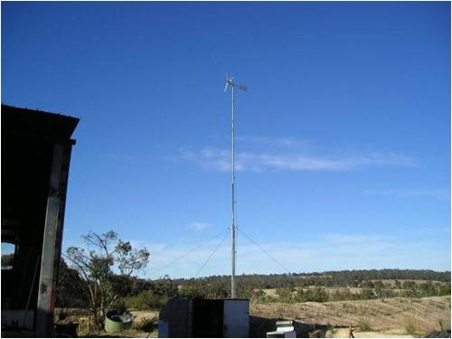

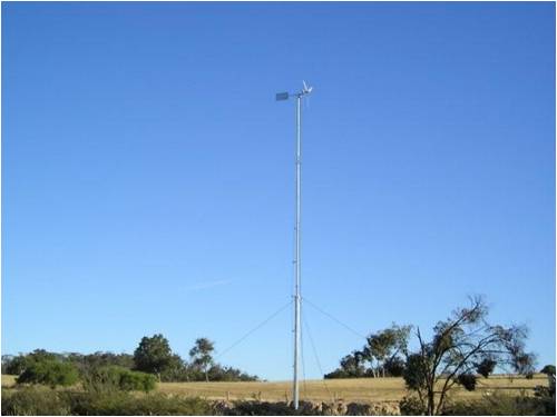

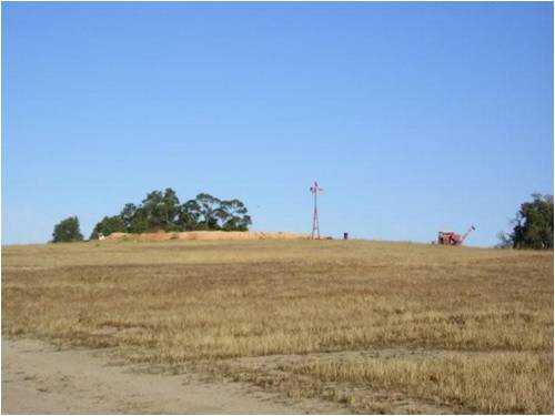

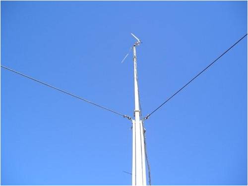

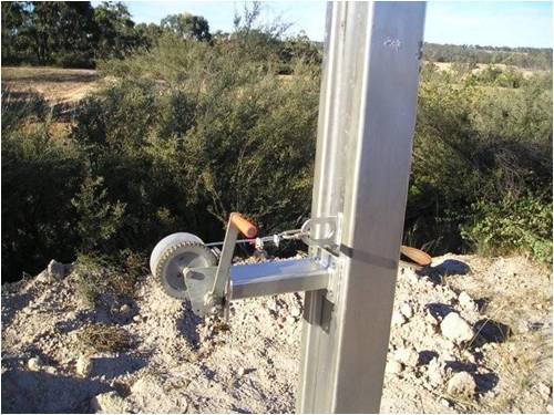

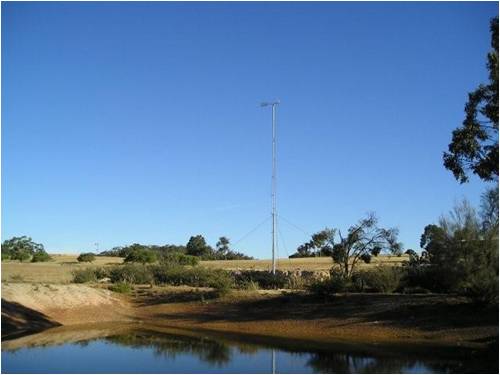

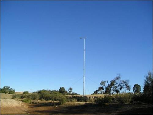

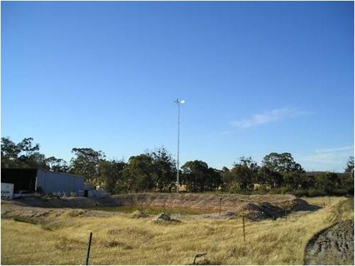

Posted: 10:40am 02 Mar 2010
Hi guys ive acttched some pics for for you all as well as Karl
Darren
KarlJ
Joined: 19/05/2008
Posts: 1178
Posted: 11:06am 02 Mar 2010
mate that is one kick ass tower
Darren
Joined: 13/07/2008
Posts: 20
Posted: 11:49am 02 Mar 2010
Thanks Karl I built it for a F&P so i made it easy to put up and down
