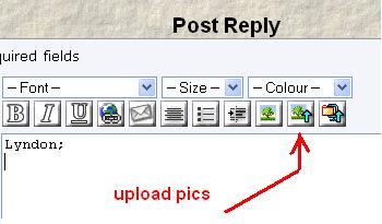

Photos would be nice and to post a photo use the button second from the right with the green arrow on top of the reply window.

When you upload an image it will need to be in JPEG Photo format. MS.Paint, as pointed out by "DOWNWIND". is a good program for shrink and stretch.
so when you use it, click, save as, and when the window opens enter your picture name, and the second linebox down, open this drop down menu and choose JPEG. it will be saved in this format. It defaults as bitmap if you forget and will not be accepted by the server when you try to upload. Welcome aboard.
