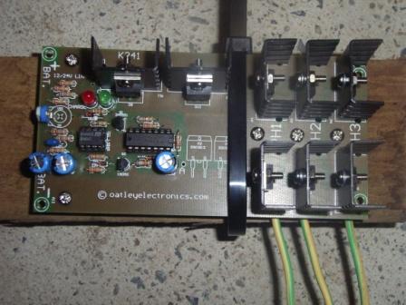

Posted: 02:36pm 07 Mar 2010
Got the charge controler put it together and it looks like this.
I have hooked it up and it does what its ment to. I say that with surprise in my voice as some things i have made, Hindenburg. ( crash and burn )

It looks a neat kit, Hindenburg
I was wondering where the [quote] that it includes 10 x 20A Schottky diodes [/quote] fit in on the board that they quoted as supplied in the kit.

Downwind if you look closely at the 8 large black heat sinks the 6 have 1 each bolted to them and the 2 heat sinks on there own have 2 each bolted to them.
