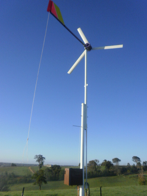

So the fix, reduced offset back to 70mm, added a GEEZUZ rope to the tail to pull her out of the wind if anything got too exciting!
Lastly -swapped the 100S in star out for one I had prepared earlier 80S 2X7C star.
Put her back up after a healthy application of grease to everything, a quick re-torque to everything, some self amalgamating tape to the blades where the spinner rests on them and a few dobs of silicone sealant between the blades and the spinner.

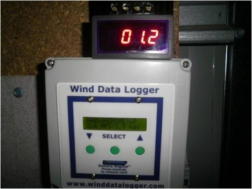

80S 2X7C vs 100S cutin may have dropped a fraction but tough to tell, the night before I studied it in the old configuration very carefully and the wind was from our ideal prevailing direction (accurate on the anemometer as no tree shading in that direction)
in as little as 3.3m/s (~12KM/hr) I was seeing 64W (not much I know) but i think for a 100S this was just outstanding
When the wind picked up to ~5m/s (gusts to 6.5m/s) I was seeing a solid 250W+ with peaks of 400W

GEEZUZ rope

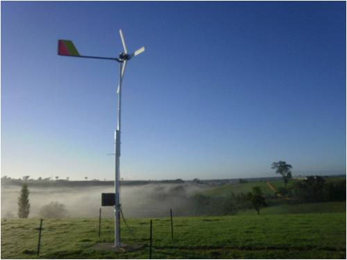

Morning fog, almost dead calm, not enough to even move the rope OR the anemometer !!
BUT spinning the blades to 20W!
In short.....
these blades are truly AWESOME low wind performers,

BTW: Took Phills advise and put a streamer onto the tower, blades as close to the wind as I could manage with the tail rope so pretty happy with that too.
I tried very hard to get the turbine to pick up speed by using the GEEZUZ rope but could never beat its natural state. A real credit to the hard work Phill has done. Edited by KarlJ 2010-03-03

I even understand it except for the streamer? is this to control the hunting or keep the slack out of rope?

There is the tail GEEZUS rope which can be use to pull it out of the wind in case of me going overboard with the now lack of offset (although you need a rake to grab it as it flies well aft of the rig even in 7m/s wind.
Streamer is attached to the tower to show wind direction so it can be compared to the blades into the wind.
I didn't think i'd see anything alarming and in fact Phill has done an awesome job setting it up with the tail kicker to keep it into the wind whether there is no wind or heaps of wind.
I'd say it tracks and furls as good as anything based on the streamer.
