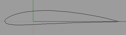

I'm working with Trev to design a set of fibreglass windmill blades. We want these blades to be the "ideal" set of blades for a F&P or similar sized alternator. Once the design is complete, if we get enough interest Trev will be able to supply them as a set for sale. To keep costs down, the blades would most likely be sold as unfinished, meaning the buyer would need to clean up the edges, sand and paint.
What we need is some info on the best airfoil to use ( or even a dxf file ), diameter ( 2.2 meter, 2.4, etc ), tsr, etc.
Any info would be appreciated. Currently there are no reasonably priced blades of this size on the market.

I have blades similar in length to Bush boy's
1.8 metre long 250mm at root 95mm at the tip
carved on a duplicating machine using a modified NACA4412 profile.
they provide plenty of "grunt"
wind output at about 8m/s

Yeah I'm the same when it comes to carving blades. I've only ever made one set, from ply wood, with no twist. I did attempt to make a set using the correct profile and twist, but it took so long to make just one blade, that I gave up. I could never get the next two blades the same as the first. Lucky for me I ended up with a set of blades carved by Dennis Latham in Adelaide, very well made. I agree blade carving is one part of windmill construction that puts a lot of people off. Some of us are gifted when it comes to shaping wood, I'm not, give me a lump of steel and a welder anyday.
The NACA4412 profile Peter suggested is a good starting point I think, its got lots of space in the middle for strength, and a nice rounded nose.
There are two "calculators" I've used in the past, and both give different results. The work by Hugh ( www.scoraigwind.com ), and the Warlock calculator. Has anyone got an opinion on which would be better to use.
