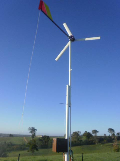

Hi guys,
not sure if yous seen this. Its availiable at a lot of the RE shops in NZ. http://www.thebatteryclinic.co.nz/WindRB900.html

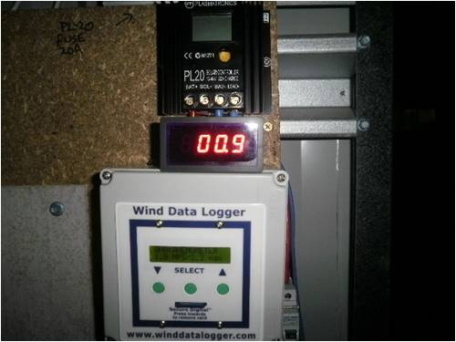

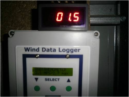

I hadnt seen that sucker.
I do note that in 4.5m/s it makes 80W
thats about 1.5A @52V

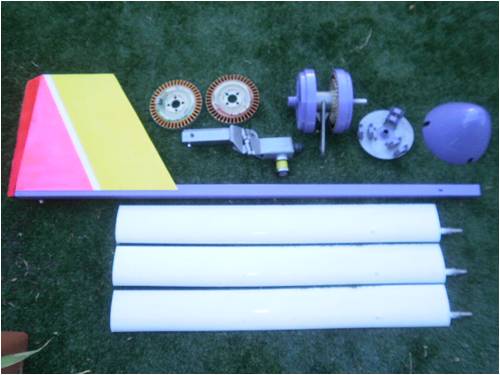

The Phillm Machine, with furling @3m diameter
makes pretty much double that I'm seeing 3-4A in the same wind.
I get the same 80W in just 3.5m/s
and 50W in just 2.2m/s
900W @14m/s is fairly howling for windspeed too, compared to the 1KW at 9-10m/s out of the Phillm dual.
Cost looks prohibitive at $3500.
Phills all up with blades, ready to roll with stators, and install on the pole with CAP voltage doubler is basically half that. (and if you build some bits yourself like the voltage doubler and supply the F&P's -much less again).
I do like the shiny appearance but I need more details on stators supplied to believe the output.
Gordon has only ever seen 890W out of the 100S in Delta and for this turbine to run in delta without a voltage doubler or MPPT type of thing would have a very high cutin rpm making it not suitable for low wind sites.

Limiting the rotors to 2000 rpm sounds a little scary to me.
It would appear to only be running 1 stator from what i could see.
If that is the case than the output is not so bad.
Rather tidy looking mill over all.

I am mystified why round pipe is used. I would have thought that a 75 x 50 RHS tube would be stronger and less affected by wind (particularly with a 50MM semi-circular piece of plastic pipe screwed to the front edge.Edited by neil0mac 2010-03-09

Neil,
[quote] (particularly with a 50MM semi-circular piece of plastic pipe screwed to the front edge.
[/quote]
And what front edge would that be, the one at the back to front , side to front or front to front, if a wind mill rotates 360 degrees then there is many fronts.
You lost me.
As for profile strength round or triangular are the 2 strongest profiles for loadings in all directions.
I think you have viewed it as a still shot and not a variable position machine.
Pete.Edited by Downwind 2010-03-09
