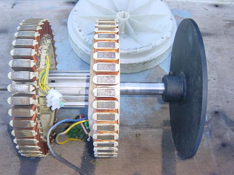

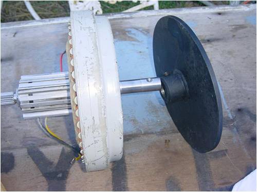

New member needing some help destroyd first windmill in high winds so must improve next but first some info so you can help have buit dual 1/80 in star and 1/100 in delta will use gordens cap mods but will use someone to help with this.am going 24 volts.my question is blade size am going with wood and have made hub for this am thinking 3 meter with tsr of 6 have used hughpigots info to build last mill

After reading more at this great site I do have axflux envy but this mill will have f&P stators I have a thing for wooden taperd/twisterd blades most blades on f&p mills on this site seem two be plastic or alloy am not wanting to set any records just improve on last mill .
As for my first mill I had wooden blades Hughs specs 4 meter diameter with tip speed ratio of 8 on a horse float hub with pushbike gears/chain running 2 f&p stators = poor startup and when real wind blows is overpowerd buy blades not a good mill but I did not know about this site then.

100Sdelta is good for 600-800W at 55V bat at 24V i'd be splitting in half ie 2X7C for the
80S I'd be going for the traditional 7x2C rewire in star but Phill has just built one just like yours so wait for him to chime in.
Direct drive and MAX 3.0M is the go, slightly less say 2.8m you'll mill a little down the bottom but will rev up harder than a 3m mill and thus funnily enough you'll get more power.

Thanks guys yes 80s I rewired 7x2c star and 100s 2x7c delta. will take your advice on blade max of 2.8m now shaping them mabee 14 deg at base 5 deg at tip????

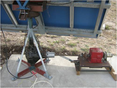

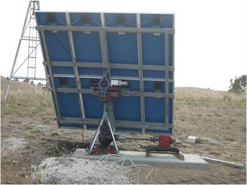

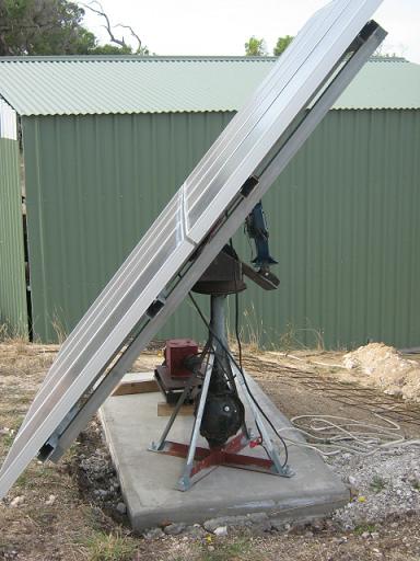

Posted: 11:54am 02 Apr 2010
Hi Shawn
The best solution is as Karl surgested the most practical solution for your setup is what i thought above.
The reason i asked about moving the solar panels closer to the mill was to consider putting them on a tracking system which will give you around 25% more power out over the day.
There is this funny stigma that the panels on the roof is the best place for them........What is 15 foot going to change in output?
If you have the space and ability to build a tracker than i would go this way.
I built one for a friend who lives off grid, it might not be the best design but it works well and gives 25+% return.
My thoughts were strong and robust on a very cheap budget. It needed to with stand a high wind area.
I used a car diff and a gearbox that was lurking under the bench with a 400:1 ratio.
We had intended to have tricky electronics tracking the sun and wind, but with tests done, we settled for a manual adjust tilt (once a year) and a basic system that moved in +/-15 minute intervals a set distance throught the day, then returns to a given point at sun up.
There is 2 travel times used ..summer and winter.
There is many trackers others have built on the forum.
Some have many more features, and all work to a positive result and is a credit to the people who constructed them.
Mine was agricultural, strong and cheap that gave a 25% more output return.
Some more food for thought while you weigh the options up.
Maybe it is worth running a 240v ac cable 600mm deep, if a tracker suits location.
Pete.
