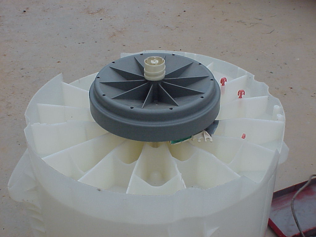

OK, I finally found a machine! Electronics are dud but thats fine - I want the motor, damnit!
I must say, in pulling this thing apart, I have to take my hat off to the F&P engineering people. They've done some really smart stuff. Things like water cooled heatsink for the electronics, and the myriad of bits held in with a twist or one screw and a couple of clips. Sounds cheap, probably is cheap to make, but I can see no indication of "nasty" in the final result.
Having gutted the thing, I now have the motor itself (complete) solidly attached to the large, outer plastic "shell". The agitator came off easily, as did the bowl itself.
I can see the bearing and seal that holds the shaft to the shell, but I can't see an easy way of getting it off/out. Is there a trick?
I can't see any clips, screws or bolts. Cutting it sounds just way too butcherous given the way everything else obviously went together and came apart.
I'm reluctant to give the shaft a whack with anything too substantial lest I damage it, and I don't recall who I lent my slide hammer to (15 years odd ago!).
I don't have a hydraulic press, and even if I did, I doubt I'd fit this great big thing in it.
Surely there's an easy way. The pump motor came out with just a half-turn (but of course, it doesn't have the main seal to contend with either)
Hoping someone can give me a pointer, or better still, a step-by-step instruction site, with pics :)

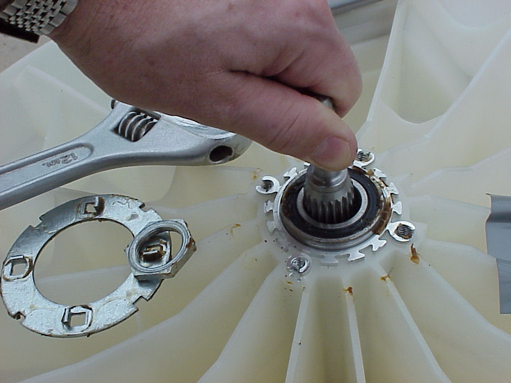

On the end of the shaft the hub and stator cam off, there is a big nut. With the machine up side down, after you have removed the hub ( undo the plastic nut ) and the stator ( 4 bolts ), you should have the shaft looking at you. There is a large nut on the shaft that needs to be aken off. They can be tight, you need to grab the shaft with a pair of multigrips and use a large shifter on the nut. Once off, then tap the shaft down and it should fall throught.
There are no reverse threads to worry about.

Just came back in to say "I went back with the mindset that it HAD to be simple" and found just that! Was about to post some pics!

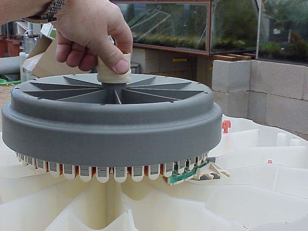

For anyone else whos in the same boat (and I suppose, for historical reference)...

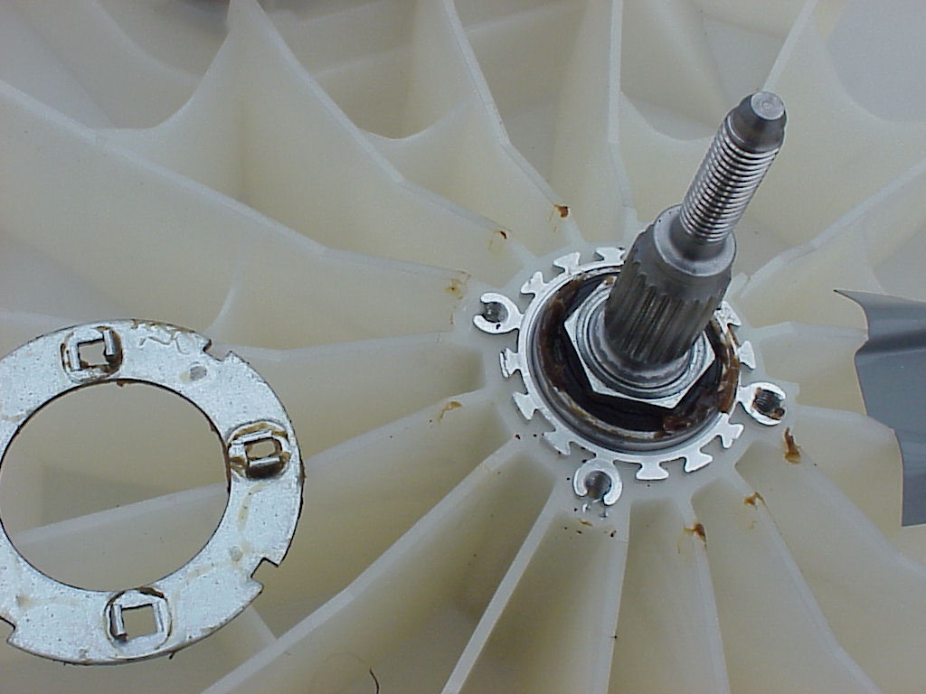

Looking at the complete assembly from underneath. The transport locking ring (pale thing on the end of the shaft) can be turned anticlockwise while holding the motor rotor steady.
As you turn it, the rotor comes off the shaft, exposing more of the coils. Eventually it is fully undone and can be lifted off.

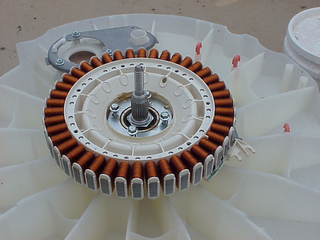

The 4 bolts can be undone (I used a 3/8" socket, but it's probably some mongrel metric size!)

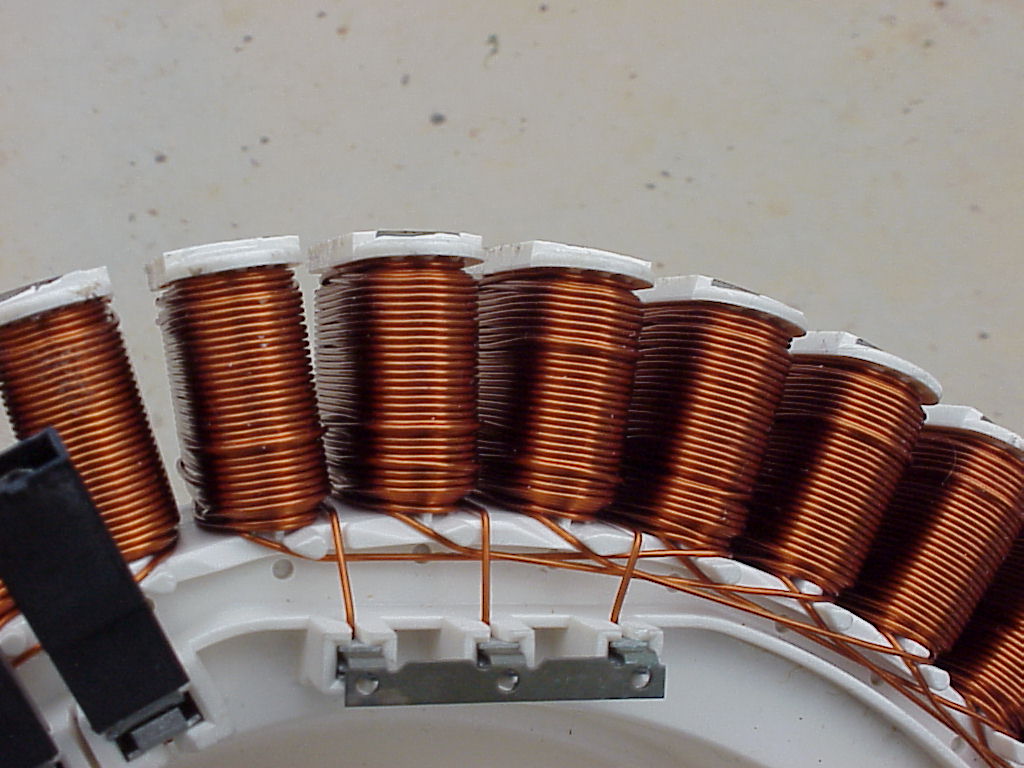

(Can anyone identify if this is a 60, 80 or 100 from the closeup of the windings?)
With the bolts undone and the coil assembly removed, the shaft and bearing housing are visible. Hold the shaft with multigrips or vicegrips (use some brass or copper shim or similar to avoid damaging the shaft) and undo the large nut with a large shifter. Don't smack your knuckles into the spanner like I did when it finally lets go).
Then ease the shaft down, through and out.
I'm still trying to work out how to get the bearing and its bits out. Looks like it's going to require brute force. Something I was trying to avoid!
Posted: 07:34am 19 Aug 2006
To remove the bearings I just use a drift ( or a long old bolt ) and tap the bearing out from the other side. There's also a spacer sleeve in there.

Thats a 80 series Ross, a good all rounder
