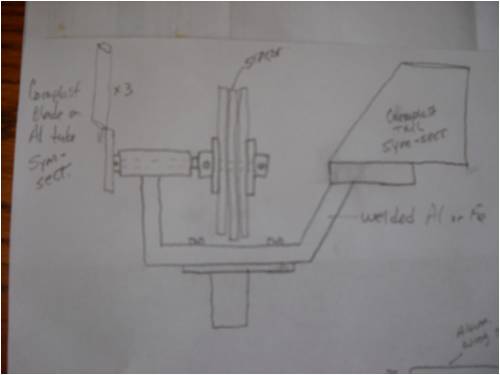

I couldn't figure out how to post a picture in the PM, so here's the sketch:
Sorry it's a little blurry. Also, disregard all the "notes to self" all over the thing along with the little bit of a picture at the lower right-hand side. I build R/C gliders and that mess in the corner is part of another sketch for a new plane I'm designing.
Anyway, the basic windmill layout is a welded aluminum frame. A Delrin bushing will house the main shaft and the magnet wheels as well as the stator are the standard ax-fx design. Blades as well as the tail fin are being manufactured out of coroplast (corofute to some) plastic. The blades are one meter long with an aluminum spar and will weigh in at around 12 ounces each. Both the tail and the blades are to be symmetrical section. I am not using any yaw gear as the thing is so light, I'm just not worried about over-speeding. This is an up-wind design.
I will be installing "stops" at 180-degrees atop the tower to limit the rotational movement so as not to have to worry about tangled wires or having to use slip rings. The mill will have free rotation within these limits and will be mounted to face the "typical" source-direction for my area.
I'll do a complete step-by-step tutorial with pictures as I build it, posting my progress here on the 4m and a You-Tube video when it's flying. It'll be a while, so if you're a part of the "hide and watch" crew, make sure your cookie jar is full!

MacGyver,
Looks like it would work just fine but a few comments.
-You won't have any means of furling. 2m rotor is pushing the limits of a turbine with no overspeed protection.
-You'll need to mount that stator to something. Should be easy enough to tie it to your main frame, you probably just didn't get around to putting it in your drawing.
-Delrin bushing? Is that for your main bearing system? Bushings would be a non starter and you'll want some good tapered roller bearings. Cheap enough but a little extra work.
Just some thoughts.

Mac it sounds like too much work for a 2 meter
turbine. If you are not worried about over speed
then you must be thinking of just flat straight
blades at and 5 degree angle or something with
a tip speed ratio of about 4.
If you are going to all the trouble to build
an axle flux alternator you will want lift
to get power out of it and you will need it to
furl unless you don't mind it burning out.
For a 2 meter machine you might be better off
just finding a suitable motor and let her rip
with no furling and a cheep prop. Been doing it
for years for a close to the ground unit.

Thanks for the comments, but I like to build stuff and especially like to build stuff from scratch.
I design, build and fly R/C gliders and pretty-well know my way around wing design and aerodynamics. These "blades" will be made of 2 mm coroplast, which is similar to plastic cardboard only with square holes.
In response to the "lift" comment, I've tried that and what I found is that as the speed of the rotor gets really high, the amount of lift created by say a Clark-Y wing section, will try to bend the blade. For that reason, I've decided to use a symmetrical-section design. I can build one of these blades in about 10 minutes start to finish (though that took a while to get good at!).
The blades will be on the order of "high aspect-ratio" design and no wider than 3 inches at the root (inboard edge). When I said they'd weigh in at 12 ounces, that was a guess, but each blade will certainly weigh no more than 14 ounces. I'll weigh one when I put this thing together and show a picture of it on my mini electronic scale so folks can see its actual weight.
As far as burning out my alternator, I plan on taking care of that with switching gear. Again, this windmill will be atop a very short tower (no more than 20 feet tall) and if the blade length becomes problematic, I'll just shorten it; easy!
As far as building an ax-fx alternator being a lot of "trouble", relax. It's no trouble at all as have a great coach who lives on Flinders Island, Tazmania. There's nothing he can't fix and he's always willing to lend a hand. You know who you are, coach, and thank you in advance!
[Quote=Perry]-Delrin bushing? Is that for your main bearing system?
I'm a big believer in bushings. My motto has always been "simple is best". Bearings are dandy, but when they are sealed away and riding around in moist air, sooner than later they need attention, whereas a bushing just needs a squirt of diesel oil now and then. I use a steel shaft (painted where exposed to the weather) riding in a Derlin chunk, which I cut with a .0005 running fit using my lathe. So far, bushings have been far and away better than bearings when I've used bearings. Thanks for the comment though.
Thanks again for all the comments. I'll post my progress as it happens.

Looks like the basic layout is a fair design from this picture.
Perry is correct, stator needs stabilization, and if you wish to use journals for bearings, then you will need to guarantee the thrust bearings/washers (or whatever you have in mind) will hold the rotor disks with well less than .25mm linear movement.... or you may interfere with the stator..... not pretty.
Now it is a matter of building it, and finding out how many turns/coil you will need.
From scratch is more fun for sure.
Do you have a guestimate of the TSR of your chosen blade design?

[Quote=oztules]Do you have a guestimate of the TSR of your chosen blade design?
Well, no. I have a free-wheeling (no load) mill in the back yard down below fence level, so the only wind it receives is an occasional gust here and there and when that happens, it screams! It goes scary fast in just a few mph wind (like 3!).
Up in the wind flow, these blades "siren" in no time at all (especially if they are in close proximity to anything stationary, like the tower). I'll have to wait until I have a load attached to adjust length, width and pitch.
The blades are made of 2mm "coroflute" plastic and are so simple to build, I can throw one together in just a couple of minutes. It's merely a matter of choosing the shape, making a fold and applying "ca" (cyanoacrylate) glue to the inside trailing edges. That goes off in a few seconds and it's a done deal. What takes time is pop-riveting the blade to the aluminum tube, which runs up between the sides and terminates about 7 inches from the tip. This early termination allows me to close off the end and make it taper down and look cool. The only down side to the "cool" look is it makes the tip kind of sharp. If it were to hit you at high speed, I'm sure it would do major damage (like cut off a limb)!!
I'll be throwing up pictures as I do this build, so everyone can glean information for their own builds. And the part about each blade weighing in under a pound is absolutely true. A 3-foot "wing" section (from my planes) with a root of 8" tapered down to 5 at the tip weighs right at one pound.
The plane wings use either a balsa or a thin basswood spar for support, but it only extends a few inches from the root up through the wing. The wing spar is used to bolt two wing halves together to maintain a 5-to-15 degree dihedral (for stability), since using a completely flat wing tempts tip stall at low speeds (take-off and landing -- each close to the ground!). I'm working on making an aluminum rod and tube design for this part, which will enable me to slide the wing halves together and secure them with a set screw. The tempered aluminum is extremely tough and light-weight to boot. It'll make a perfect dihedral keeper and wing joiner.
A hollow coroflute wing or blade is extremely robust and would be nearly impossible to fold with wind alone. That's why I use them; strong and cheap!

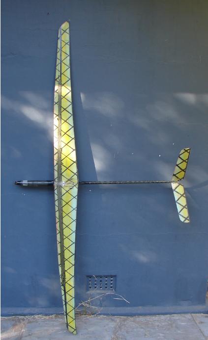

coro-plas is not what I would be making any wind turbine airfoil from. It is not that good for an aeroplane wing either. The only redeeming feature is crash survivability, but EPP foam is still a better option.
Here is a pic of one of my own design gliders, I made in 2004. All hand made, including carbon/kevlar composite boom and fuselage. This is 1.8m span, and weighs in at around 400g, with all gear. The 1piece wing tapers from 10mm thick section at the root, to 3mm airfoil at the tips. The tail feathers are 3mm tapered to 2mm foam cored. All the black, is carbon fibre. The criss-cross surface spar system is now used by top commercial designs.
I tried making a foam core, carbon/glass bagged airfoil turbine blade in a similar fashion to these wings. Wood is better, and much cheaper for a turbine blade. Weight is not as critical a component.

if you must use delrin block as a bearing I would suggest making a ring oiler in it as you only need to add oil every few months. I have seen wooden block bearings with a ring oiler in old saw mills that where still working after 50 years. The core flute blades could be made stronger once formed by some of the expanding foam liquid used for flotation cells and insulation. Be sure to use a steel tube insert for the root out to at least 30% to take the torque as alum tube will fatigue quickly with the forces on the blades, and you don't want a sharp ended stuck in the top of your head, or worse someone else.
All the best
Bob

I agree with Gordon, I too have built lots of gliders, pylon racers and fun machines.
The only thing I would use in the mill would be a similar design to the pylon racer or my southern sailplanes eclipse (a 3m glider) where I use carbon and glass for skins.
Aluminium tube for the support is a bad idea, might as well use exhaust tubing.
There are some serious forces and fatigue issues that a sailplane just doesnt see.
a little movement here and there on a glider is no big deal but failure in a windmill application where loads are variable and continuous will break them in a matter of weeks.
Plenty of experience with that here. If tules is helping out, cut some with a chainsaw and be done with it...

I thought you would appreciate the lines of my glider. This model had a Fluoro RED leading edge I painted onto the foam wing core prior to bagging, but in the 1000 or so hours this model has flown, the sun has faded the colour. The curved wing trailing edge while maintaining the knife edge thickness was pretty hard to get right as well.
Good luck with the Coro-plas, and if it doesn't go so well you can cross it off the list.
