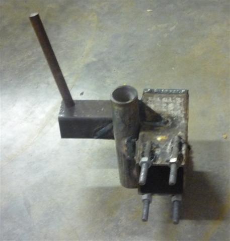

Hi,
I am currently making the F&P windmill with the directions that i found on this website. I currently need to construct the tail but i have no idea on the size that it should be. any help would be much appreciated.

Hi Geoff,
Tail size in my opinion should be a Min of .5~.7sqmt and also having the tail as long as you can with whatever construction mehod you are using , of course as you lengthen and add size to the tail fin it will have an effect on your furl piviot angles .
Going with a long tail allows you to keep the fin to a minium size and allows the mill to keep into the wind with a smoother yaw action .
As you have not given any info on how big your mill is, then at a ball park I would recomend a tail length of 3/4 of Blade Dia

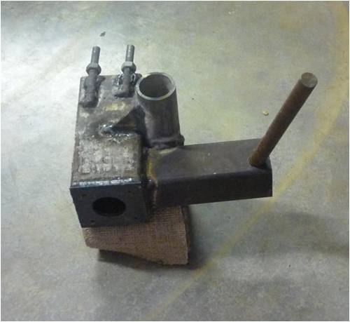

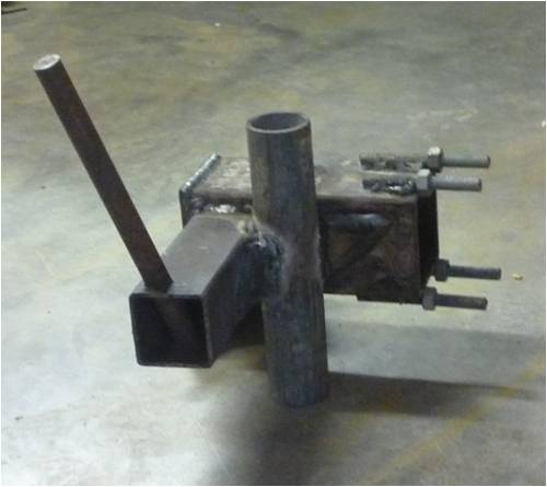

Here are some pictures, hope they can help.
Geoff

Posted: 12:07am 29 May 2010
Geoff
Ridge(heavy)is good, if you feel a little unsure about reliability or strength then do not hesitate to go a bit heaver especially with your yaw assembly.
Looks as though you've decided to base your mill on Glens well crafted machine. Not knowing the size of your mill makes it difficulty to tell for sure but I am thinking that the angled rod extending from your yaw assembly might be to light for a auto furling tail mount. On closer observation you will notice that Glen placed extra support in this area.
Be sure to allow enough room between the support mast and the blades, 5% to 7% tilled (blades)back away form the mast will usually help with blade to mast clearance.
