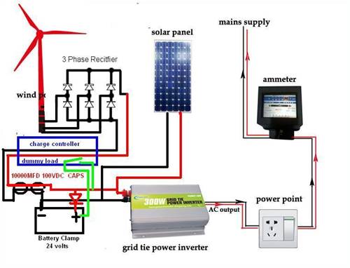

Hi all, (first time poster, long time reader)
I would like to use an Ebay Grid Tie inverter with a windmill which has an AC motor which I'm currently building as a "first windmill" build.
Ebay item click here to view
Question is the output from the motor I'm using is AC not DC. Where as you see on the grid tie inverter it says DC input.
Is the solution to this a "Rectifier" to then plug it into the grid tie?
e.g. Windmill -> (AC to DC, "Rectifier?") --> (DC to Ebay Grid tie) --> House mains.
Sorry for I'm not up with all the technology. I do appreicate all the information the members provide on this forum.

I think that everyone who buy these units should connect these units up as per the advertising blurb, and make a warranty claim when it blows up. This may then force the companies that sell these units to offer a more complete solution. They really are only good for solar, and in a batteryless system. The unit pictured in the link was labelled 300W, but the blurb stated as a 600W unit.

I am swayed to thinking from your tentative question that you have little experience, either electrical, or electronic. You mention a first windmill build.
You give no indication where you are from, so I will assume a western world location with some rules with grids and electicals. Grid connection requires certificated installation to the grid, with a licensed electrician, and all the utility requirements being approved.
These small grid connect inverters pop up as an option for a windmill. The biggest problem with a small grid interactive inverter is maintaining the connection when the winds are variable. A multi kW inverter/windmill usually has enough inertia to power through the lulls. Not so with a <1kW system.
You will also be very dissappointed with the power output unless you live in a windy location with >5m/s average windspeeds. This would need to be proven with a wind distribution graph. My own windmills in a 3m/s average windspeed location produce only 1/10 the average power of a similarly rated solar system.
As you are new to all of this, I would suggest starting with the smallest battery connected system, and possibly start with some alternative lighting. Going grid connect without any experience will likely result in damaged equipment due to overvoltage, the first big storm that comes through, and no one is home to shut everything down.

The output from your motor will be AC single or three phase, one assumes here you are converting it with magnets on the rotor, it needs to be rectified to DC for battery charging.
I would not touch one of those inverters with a 10 foot pole, the blurb made for funny reading though, I especially liked the "how to install" Put female to the inverter first, make sure it is connected, then put male plug to the home power. I had visions of a mating ritual, Ok I will go wash my mind.

GTI is a big learning curve even the "pros" get it very wrong and most are either troublesome or just dont work.
First up, spend 12 months gathering wind data.
I did this but not in exactly the location of my mill.
this was a mistake as although the results were indicative enough for me to bite the bullet, they were in now way accurate.
In my opinion you need a minimum average windspeed of 4.5m/s to be even close to viable.
In most cases you need to have a genuine interest in wind as it requires love and care as opposed to the install and forget you get with panels.
