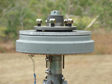

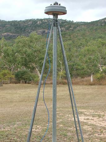

Prof
Joined: 01/12/2005
Posts: 33
Posted: 11:22am 02 Sep 2006
Hi Guys,
RE the central bearings - this is my $50 complete solution which has a 39mm shaft. An adapter plate holds the F&P rotor. I have a way to go yet building the Lenz H rotor (1.2 dia x 1.8 tall.)
Considering what the original purpose of the bearing assembly was designed for I think it should be strong enough to handle a fairly big H type turbine such as ED has in mind. For a few dollars more even stronger hub assemblies are available. I will leave you guess what the bearing/hub assemble was originally intended for.
Prof
I know boats!!
dwyer
Joined: 19/09/2005
Posts: 575
Posted: 12:17pm 02 Sep 2006
Hi Prof
i had a look on your design is no big problem as it will hubs will hold nearly 1 tons and years ago l use to manufacture trailer for my customer and they all pretty good as my last trailer made was 2400x1200 tipper trailer has single 40mm axle and did carry 1.6 ton of sand without damage the bearing or blending the axle so l cant see anything wrong with your design
