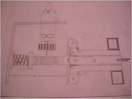

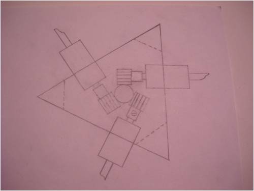

Study the following two diagrams I've drafted. I'll leave this here until I have the time to machine the thing. Right now, I'm waiting for materials to finish my axial-flux toy windmill as well as one that is iron-cored (and will likely cog like there's no tomorrow!). In the meantime, if anybody has any thoughts, post them here and together we'll iron out the details so when it's time for the build, the final product should work. At least, that's the plan.
This is the hub end. The large triangle is made of welded aluminum. The blades pass through a bushing, which is pressed into an aluminum tube welded to the aluminum triangle hub frame. A stop at both the inboard and outboard side of the bushing shaft keeps it in the proper position. There is a spur gear fastened to the end of each blade shaft using a set screw. I see now I forgot to draw two of the set screws in, oops! The spur gears are locked into a rack gear (like rack and pinion steering) which "floats" freely on the end of the windmill's shaft, positioned by a spring trapped between the outboard side of the hub and an inner, moveable hub wall that is controlled by flyweights (see second picture). The little dotted lines in the corners of the triangle are gusset welds inside the hub. These hold things true under stress.
From left-to-right we see the "A" portion, which floats freely on the windmill's shaft. The spring tries to force the rack into the "default" blade position (45 degrees to the wind direction). The "B" portion is locked onto the spinning windmill shaft. The two round things are little wheels, which ride on the "floating" hub wall of the piece carrying the rack gear -- the "A" part -- which pushes tension aft via the spring. The two dark square boxes on the "B" side are flyweights. The "B" part, being locked to the spinning shaft, twirls as the blades provide the motive force. As the weights spin, centripital force throws them outward and as this happens, the action moves the bell crank (lever) and the little wheels work in unison pushing the moveable rack hub plate and change the position of the rack, which in turn rotates each of the blade shafts in unison (or so the plan goes!). The picture shows two flyweight setups, but in reality, there will be three, each set 120 degrees from the other two.
Well, that's it. Now it's everyone else's turn to shoot at it and maybe we can come up with a better mousetrap, who knows?

Hey Mac, sounds like a runner. I'm wondering about over-speed protection though. Traditional furling? I don't know how having a system that promotes an ever-decreasing angle of attack as wind speed ramps up will survive long term, from what I've read (and understood).
Don't self feathering hubs start at slight attack angles and rotate away from the wind (towards larger attack angles) to decrease their efficiency? I know that a higher attack angle improves yielded torque (great for start-up) but at speed it is countered by the dramatic aero inefficiencies as air flows badly over the blade. I'd welcome correction on my understanding if I'm way off here.
I understand where you're coming from with the "start large (angle of attack) and progress to efficient" but I suspect you might need to limit the attack angle you end up at if you live in a windy region. Indeed, if I'm actually on the right path, the windier the set-up, the larger the final attack angle will need to be for longevity.
LukeEdited by montyLalor 2010-05-27

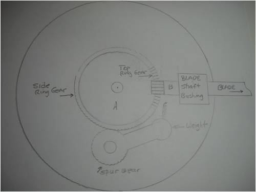

Simpler Design
Okay; I'm back with a much simpler design. The only really hard part is either finding and adapting the gears or making them from scratch. Broaching a top ring gear with a spur ring gear on the side of the same piece would be quite a "weekend project" but if anyone is up to it, be my guest. Here's a barely-visible sketch of what I'm up to:
The way this works follows:
First off, what is shown here is only one blade-pitching mechanism. In the final build, there would need to be three such items, each placed at 120 degrees from the other two, pitching each of three blades simultaneously.
As the whole shebang turns in the wind, the flyweight (labeled "weight") would be thrown out against the little spring, which tries to hold it inboard near the central hub. When it begins sailing outbound, being attached to a spur gear, which is meshed to the side ring gear of the main hub, it rotates the spur gear, which in turn rotates the central hub. The central hub sits on a ball bearing at its center and everything is mounted on a plate which also supports the blade shaft bushings.
On top of the central hub (A) is another ring gear cut into it's top face along its circumference.
At "B" there is a spur gear attached to the blade shaft. That spur gear is meshed to the top ring gear of the main hub and as the hub rotates, due to the action of the flyweight rotating the spur gear(s), it in turn rotates the blade shaft, changing its angle of attack to the wind.
That's about it; easy huh?
Like I said, the only "real" problem is broaching that central hub so it has a ring gear both on its side and on its top circumference. Because of this fact and that I already have way too many plates in the air, I'll likely use levers acting on pins for my first build of this sucker.
Stay tuned and as I find the time, I'll try to fit together something that works and I'll post it here. I'll likely just post the finished project and not a blow-by-blow build simply because the design will likely change by the time it's a done deal.
. . . . . Mac
Edited by MacGyver 2010-06-03
Copeville, Texas
wind-pirate
Joined: 01/02/2007
Posts: 101
Posted: 04:10pm 02 Jun 2010
Hi mac
Will that be able to control all three blades at the same time?
or will it be 3 seperate controls...
Ron
THE Pirate.
stealing wind & solar energy is fun
MacGyver
Joined: 12/05/2009
Posts: 1330
Posted: 04:19pm 02 Jun 2010
[Quote=wind-pirate]Will that be able to control all three blades at the same time?
Yup! It'll do all three at once and as a matter of fact, that's the ONLY way this will work. All three blades have to trim at the same time and the same amount or it throws the mill out of balance and it'll thrash itself to pieces sooner if not later.
I only drew in one section, cause I'm a bit lazy is all. Imagine, if you will, two more flyweights and two more blades attached 120 degrees apart on that same hub and you'll have it.
. . . . . Mac
Copeville, Texas
