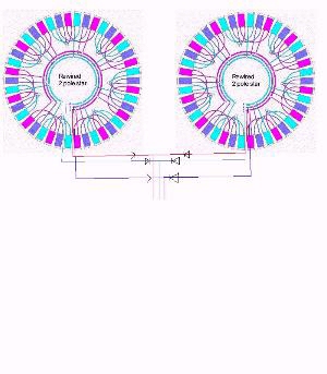

I HAVS BEEN GOING THROUGH THIS WEB SIGHT FOR 2/3 YEARS ANLY RECENTLY BECAME A MEMBER. I AM ABOUT TO FINISH BUILDING MY FIRST DUAL F&P WINDGEN. I HAVE THOUGHT OF COFAZING THE AC AT THE TOP, THUS SAVING RUNNING SO MANY WIRES DOWN THE MAST. I'VE THOUGHT OF USING DIODS IN BETWEEN TO STOP VOLTAGES FROM FAZE TO THE OTHER. ANYONE HAS ANY IDEAS ABOUT THIS?

What I meant is to join output wires from one stator to the other ( from each faze) thus having only four wires (3 active one neutral) coming down the mast. I would prefer AC to the shed rather than then DC (less losses)

If I understand you correctly, joining the different phases together will only do one thing, it will go bang. They are out of phase and consequently at different voltages referenced to each other. It should not / cannot be done. Pursue at your own peril.

I understand what you are trying to achieve, and while it is possible to run two alternators together, in a coupled two rotor F&P it wouldn't be practical because even if you could synchronize the phases of both units any small differences in the stators would cause eddy currents to flow between the two stators, and cause power losses that would be translated into heating of the stators, while if synchronized accurately it would only be small loss any losses when you only have a small amount of power it is significant.
To synchronize two alternators you need a coupling that is designed to allow small amounts of Phase angle to be accommodated. One alternator would become the master and the other the slave alternator.
Good thought but not practical at this level of power.

Hope the image comes throu as this is my first time. If it does would it work with the diods

Pic is not real informative, but looks like you have a series diode, in each phase lead from each of the stators. Not sure what you are trying to achieve with this?
I presume that you are hoping to use the star point as a centre tapping point for a 3 phase rectifier, on each stator. This is like a 2 diode arrangement for a centre tapped Xformer with full rectification, but for 3phase.
You may be able to clarrify.

Basically you are trying to reinvent the wheel....Why????
Just use 2 x 3phase rectifiers, 1 for each stator.
Then join the 2 DC positives together and the same for the negatives.
Dont worry about the star point (or neutral as you called it) there is almost no point in using it with 3 phase.
If your method was worth doing than many here would have done it years ago and it would be widely posted to the forum.

If the intention is to run two alternators and avoid the problems that Bob mentioned how about running the phases of one stator in series with those of the other stator?
Higher voltages may or may not be what you need!

Good point, as then two 12v configurations series-ed in phase for a 24 volt unit, however the accuracy of phase angle of the two still exists as there would be a lead lag effect on the waveform of AC and eddy currents again, I think it would negate the concept of a simple little system that could be got going for peanuts.
To go to to that amount of trouble to get a bit extra power as compared to running a single stator with neo magnet rotor, I think a neo rotor would win hands down.
It would be an interesting project to do the twin but not practical for a unit to do a job with minimum hair loss.
My twin that I am building isn't even rewired its just two stators reconfigured to delta coming down the mast to twin 3 phase rectifiers with a down converter from 110 volts to 30 volts when I get it finished I will post the project.
