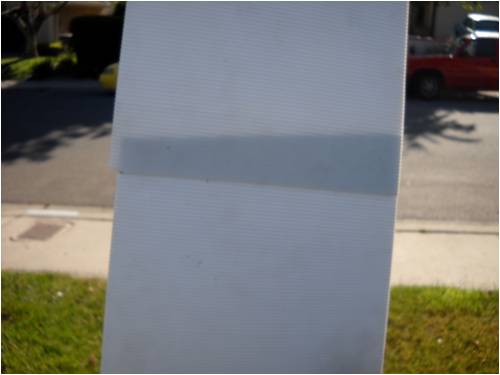

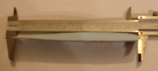

As many of you already know, I make my blades out of a plastic sigh material called Coroflute. In the USA, it's called Cloroplast; same stuff. It's basically the same as corrugated cardboard only it's made from very tough plastic.

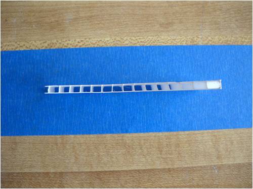

This is a small piece of the stuff. I'm using the blue tape as a background
so you can better see how it's made.
Here it is stand on its end. See the little ribs? This is 4mm Coroflute.
I use 2mm as do many who build and fly R/C gliders and sail planes. In fact, I'll be building a new plane for myself out of it soon. The plane will feature an 8-foot wing span with one dihedral. The wings will bolt to the welded aluminum fuselage, which will also house the electric motor (for days without thermals), speed control, radio receiver, flight as well as power-assist batteries, servos and anything else I've forgotten. It will use "wingerons" which are merely ailerons (a little flap along the trailing edge of each wing) and a "mixing" radio. With only two servos, it'll go up, down, left, right, roll, etc.
Anyway, back to the Coroflute. What I'll do here is post pictures and a running tutorial telling anyone who wants to build their blades the same way I do exactly how I do it. I took pictures all the way through an entire build.
For those of you who think these blades are too flimsy, let me set you straight; they're bullet-proof!

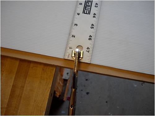

Layout is key here. Once you dab on the CA glue, it's history. You
must be accurate in laying out, marking, cutting and gluing.

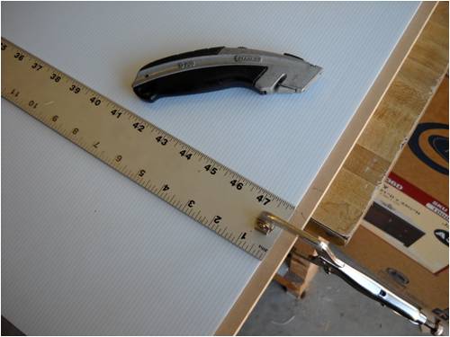

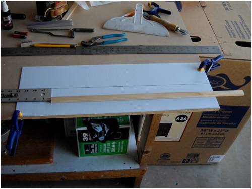

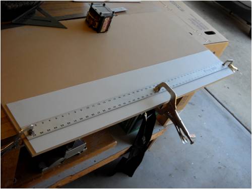

I use a 2' by 4' piece of "MDF" as a cutting and laying-out surface. The
Coroflute is held in place using a metal ruler and a vice-grip clamp.
This stuff is really slippery, so you have to make sure it's down tight
before you draw on, cut or glue it; really important, even crucial step.

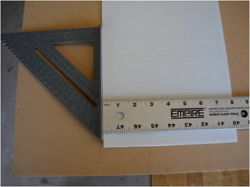

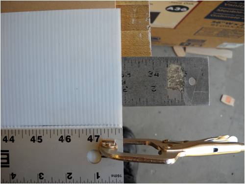

Accurate measurement means starting in the same place each time. I use a
flat surface (carpenter's square here) on one side and I butt both the work and
the ruler against the same vertical surface to make sure each is equally places.

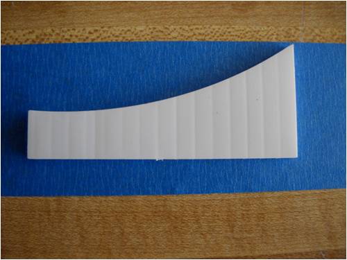

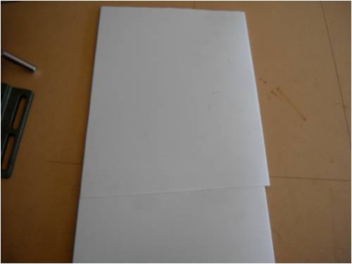

This shows a sheet of Coroflute cut into a square, which is 8" wide parallel to
the plastic ribs
and 48" long. It will make two 4" x 24" blades when it's done.

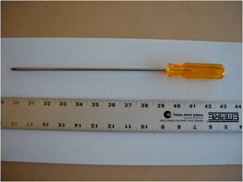

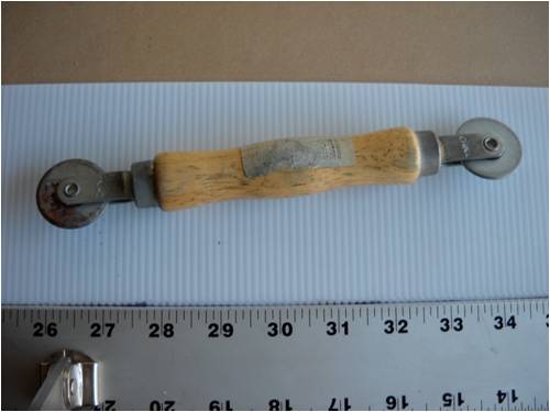

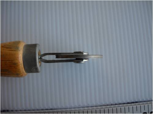

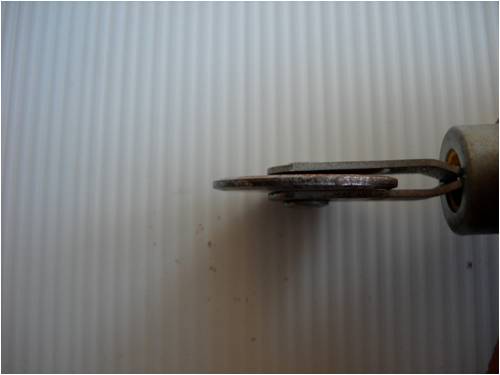

The yellow-handled screwdriver is what everyone else uses to crush the coroflute.
I do it another (easier!) way:
This is what I use. It's the little tool you use to shove the rubber welt into the slot
when you re-screen an aluminum window screen. Note it has two ends. We use the
rounded end
and not the grooved end.
This is the end we use and all it's used for is to "crush" one side of the coroflute so
it will fold easily along the line. More on that later.
Look closely and you'll see a little valley between the two sides of the wheel.
This makes two little "knife" surfaces, which will cut the coroflute.
We don't want to cut it, just mash it. Use the other end!
Really, really, really important: The fold is made so that the ribs of the Coroflute are running front to back. That is, leading edge to trailing edge. This makes for built-in "ribs" as well as adds to the strength of the blade (or wing). The wood spar takes up the load along the length of each blade preventing it from bending under load.
So when you're cutting things out, remember which way the ribs are running and don't cut things out the wrong way! Basic Rule: If it folds really easily, you've goofed; start over! Sorry, them's the rules.
Note here that there is a metal ruler on EACH side of the coroflute.

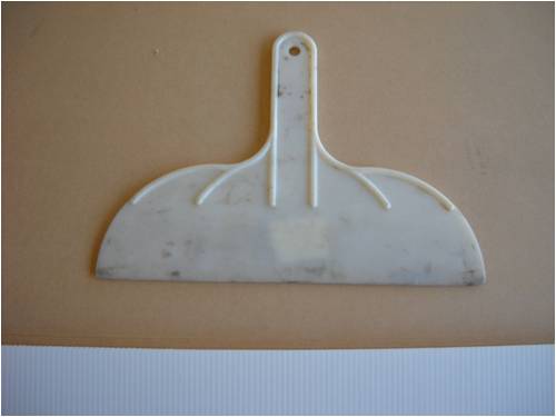

I did this to show that there needs to be a large flat surface on the back
side of the fold or you'll "crinkle" the fold and that's not part of the plan!
Here's what I use instead. It's a plastic drywall applicator (less than $1 @
Home Depot). It spreads the bending force over more surface area than
if you were to use merely your hands.
The next few pictures show how to lay things out prior to making the folds. Pay strict attention that your work is always clamped to the work table. If it slips, you start over; it's that simple. No room for errors with this stuff!

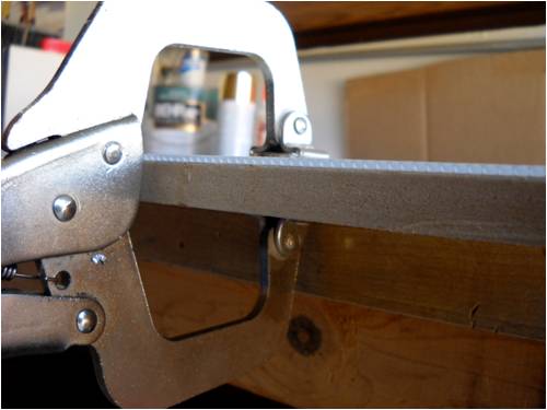

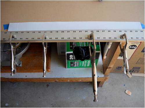

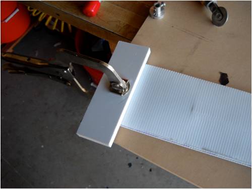

This is an end-view of a locking clamp securing the work to the table.
There is a metal ruler on top of the coroflute, then the plastic sheet,
then the work table and the clamp sandwiches it all and holds everyone's
place.

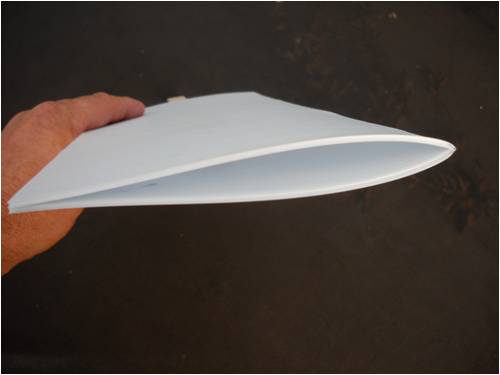

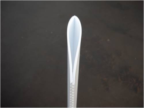

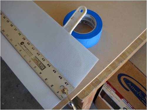

This shows a sheet of creased coroflute plastic just prior to its being folded.
I've begun the fold and am using a roll of blue tape to hold up the handle
on the plastic drywall knife so I can take a picture of the whole shebang.

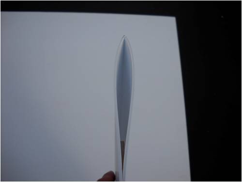

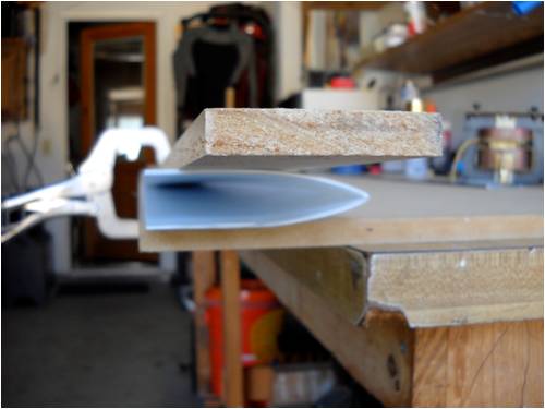

This shows a flat piece of wall-trim board clamping a 4-foot blade section.
Here's where we're headed; a nearly-perfect symmetrical-section blade!

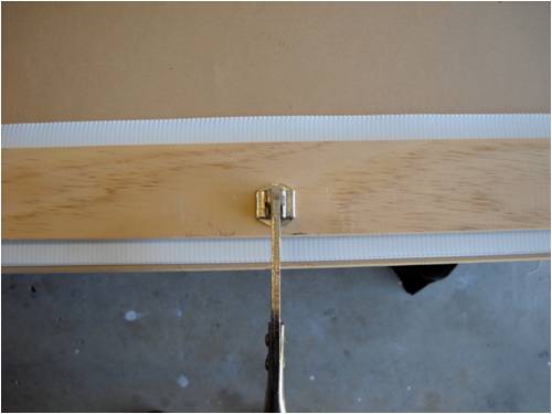

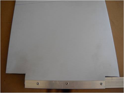

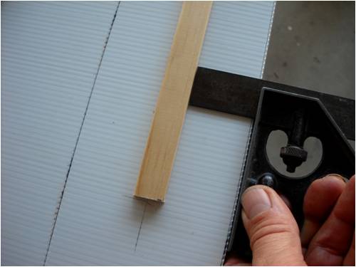

This shows laying-out and positioning of the blade spar. It is centered
and is 24" long, but sticks out the root 4" and is 4" shy of the outboard
end (tip) of the blade. Glue it in place using clamps before you fold the
other side over and glue it in place.
This is a close-up of the spar layout. Go slowly and make everything nice.

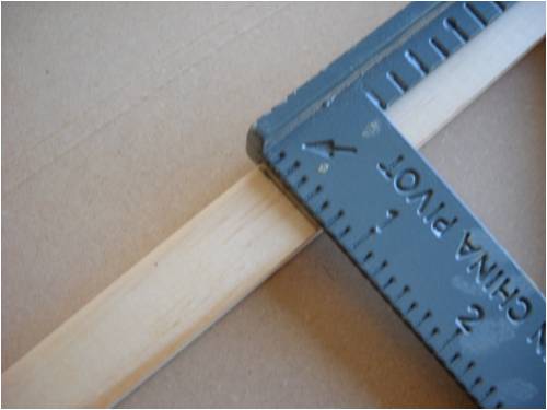

Here's a little trick I use to make sure the spar is parallel to the edge. I
set my square to the exact measurement, then use it to check the other
end. Don't glue things until you've placed them and marked them with
a pencil while they are clamped in position. Doing this, all you then have
to do is dribble the glue down the marked out area and use the same
lines to place the spar, then clamp it down. If you're in a hurry, while
the spar is clamped and glued, re-glue the edges and use "kicker" for
an immediate glue set!

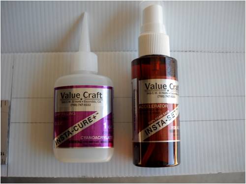

This shows the glue. The one on the left is "Gap-Filling" (thick-ish) CA
while the tall bottle is "Kicker". The CA achieves full strength in 2 hours,
but if you spray it with the kicker, it hardens immediately. It's not
always possible to spray the glued area with kicker; it's used mostly on
edge and exposed seem glue joints.

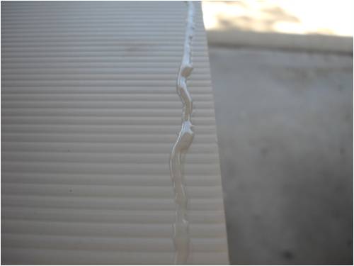

This shows a little trickle of glue before the opposing half of the blade
is mashed together. Nothing fancy!

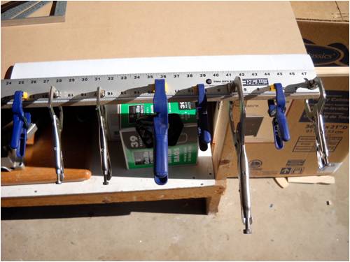

This shows how after glue has been applied to both the spar and the
trailing edge, a flat board is clamped on top and the whole thing is
left for 2 hours to cure.

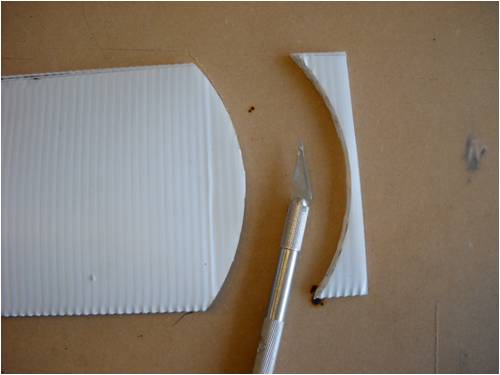

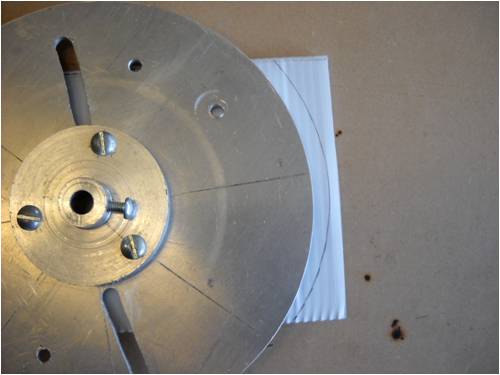

Once the glue cures at the wing tip, find a suitable radius to use as a
cutting template (I used my faceplate) and first trace the cut with a
pencil, then clamp the form in place and use an exacto knife or razor
blade to trim off the end.
Here's that tip cut off and that's the exacto knife in the middle.

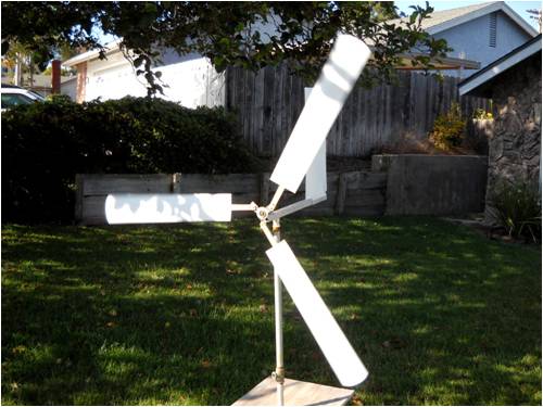

I fashioned a tail using coroflute as well. Unfortunately, I made the
tail too small and when I tested the windmill on my test stand, it
tended to "precess" in the direction of spin when the wind slowed.
To cover my mistake, I merely cut a higher tail section and overlaid
it onto the existing tail, smeared it with CA and "kicked" the seems.
Hey, it's a "test" windmill so a little oversight is okay this once!
My "tail goof" is only really obvious when you look "through" the tail
with the sun on the other side.

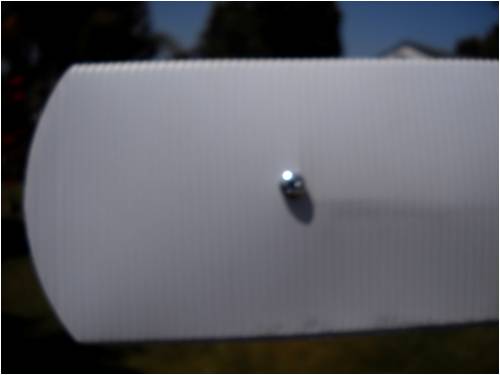

Finished project: Here is is on the test stand spinning around in my
front yard further convincing my neighbors the guy next door is a
nut case!
I'll try to figure out how to make a movie and post it on You Tube!

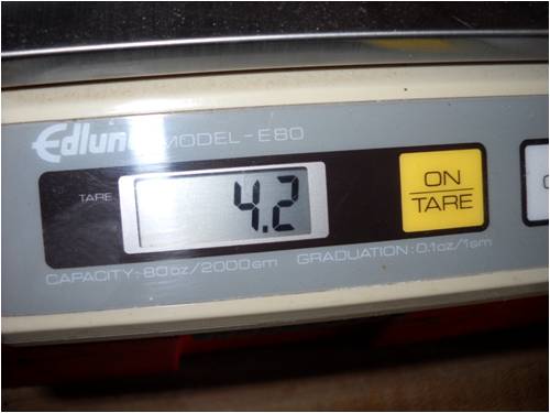

Oops! Almost forgot to show you how much one blade weighs:
That's 4.2 ounces for a 4" x 24" blade with spar. Due to different
wood densities, the 3 blades weiged 4.1, 4.2 and 4.3 ounces.
. . . . . Mac

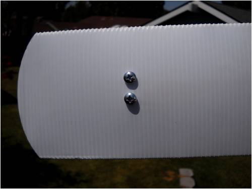

Balancing Act
Just so you know, Saturday was my 61st birthday and I told everyone what I wanted most of all was to be left alone so I could re-build my little backyard windmill. I got my wish.
Remember I said the blades varied in weight? One was 4.1 oz, one was 4.2 oz. and one was 4.3 oz. I dug through my damfino drawer (damfino what's in there!) and found that a half-inch 8-32 screw weighs exactly 0.1 ounce. How handy is that?
At the top of the spar on the two heavy blades, where the spar holds the sides of the blade surfaces apart by about 1/2 inch, I drilled a hole and threaded the screws in place to balance things out. It worked perfectly; the thing is balanced to a tee now.
I shot a couple of movies of it running a bit and will try to upload them here to the forum. If that doesn't work, I'll have to see if I can figure out the You Tub gig and if it goes that way, I'll come back here with a link for everyone.
How's that for a "senior moment"? Forgot to download the damn pictures:
. . . . . Mac

wind-pirate
Joined: 01/02/2007
Posts: 101
Posted: 09:01pm 31 May 2010
Hi Mac
You will be putting that Gennie on a 60 ft. 19m. Tower?...Right...
It spins pretty easy in the light winds. You should try to get it higher, to see how good it will do.
Ron

  MacGyver said  The spar in the glider wings I make out of this same stuff are cut a bit differently, but glue up the same. To make an asymmetric section "Clark-Y" wing (or blade), I cut the fold-over part 1/2" wider than the bottom section. When the trailing edges are matched up, with the spar about 1/3 of the distance back from the leading edge, it makes a near-perfect air foil.
I am surprised at your comment about the quality of the section being a near perfect airfoil.
I decided to cut one of my glider wings to a X-section. Here is a slightly blurry pic.
This is what I would call a reasonably good airfoil. It is hard to imagine the folded plastic you are using being near perfect at the trailing edge.
Folded plastic I would call quick though.

I don't know, man; it doesn't get much sweeter than this:
Side-view of a 6" x 16" symmetrical-section blade on a black background.
That trailing edge looks pretty okay to me; it's the leading edge I'm
concerned with though, so the view from the back porch doesn't
matter much as far as I'm concerned.
Same section from a different view on a black background.
Similar view using a white background just for kicks.
Bottom line here is just this: These blade sections pictured take me about 4 minutes to lay up and glue together. I'm sure that's a far cry from what it takes to make your wings and as far as I can see, it's pretty symmetrical. These are "driven" blades and what I'm after is a smooth pathway through the wind. The faster I can spill the wind, the better this thing will fly.
These three I just made today will be going on a (very) small axial-flux generator. The magnet wheels are only 4 1/2 inches in diameter, using 6 pairs of 1" N52 neo magnets and a new stator design I cooked up (details when it works!). I expect this little windmill to turn around 500 rpm no load!

my first post here. I am looking at using the airfoil you made but using it for a VAWT design for a very small turbine (just starting with all these neet projects). what would you suggest for closing off the trailing edge (since it would become the leading edge)? and love your post!
thanks

Noel
Not sure I understand your question.
The leading edge is smooth, since it is just a bend in the plastic.
The trailing edge is where two flat surfaces come together and are glued in place with CA glue. The trailing edge is rather abrupt, but when you tuck in an aileron tab, it "steps down" the bump and makes it a bit closer to a thin edge. With the type of flying I do (motor assisted most times) that scruffy trailing edge doesn't matter much at all and the speeds I fly are way past soaring speed most of the time.
For you to use the blade or wing in a VAWT situation, that would be fine since, to my knowledge, they turn in only one direction, so it would be no different than when used in a HAWT or on a glider wing.
An "airfoil" blade on a VAWT creates lift just like when it is used on a plane or on a HAWT and as it speeds up, it's "apparent wind" starts it "flying" and you get even more lift than you would if it were merely immersed in a fluid flow. Of course, if you're using a "symmetrical-section" wing, lift is only determined by angle of attack.
If you are interested in the blade creating lift by it's shape, you'll have to bend it into what is called a "Clark-Y" configuration, where the bottom is flat and the airfoil is on one side only.
If I've missed the mark here, straighten me out and I'll help if I can.
