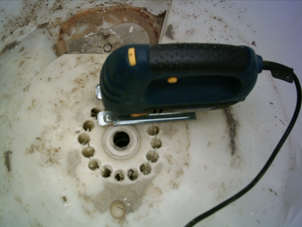

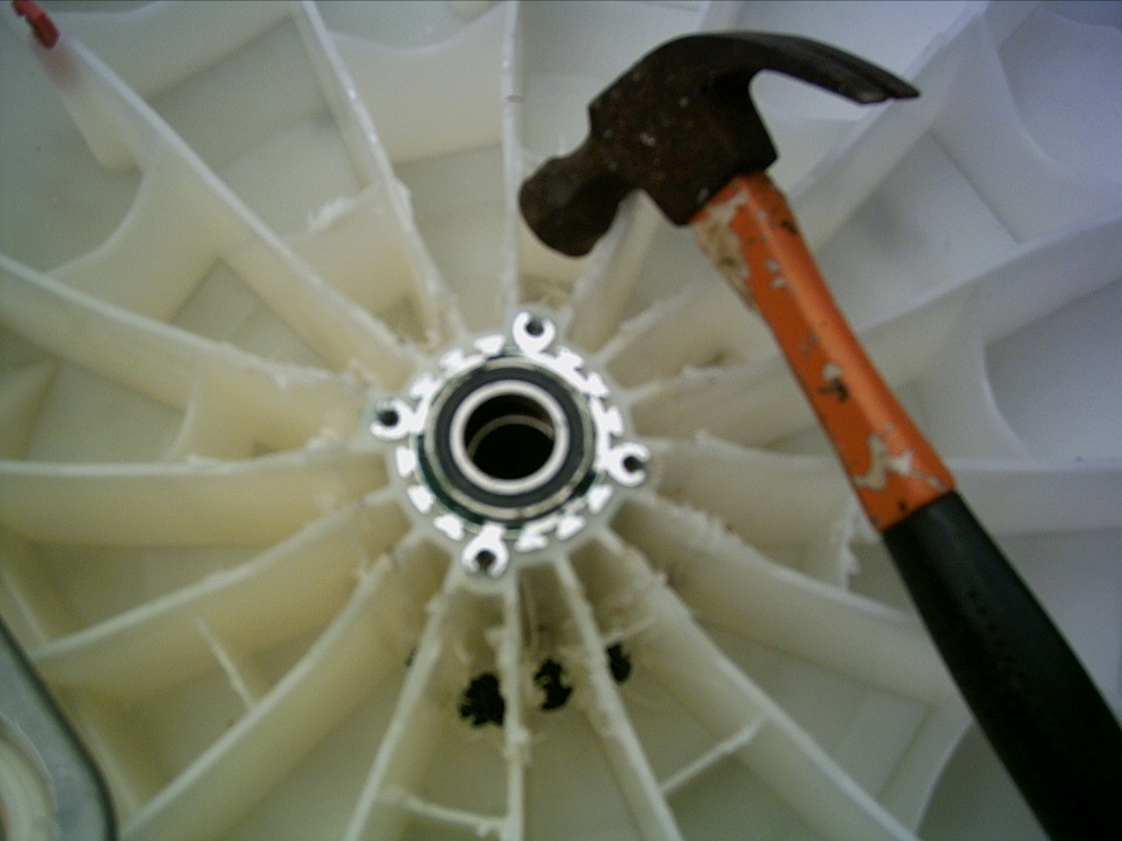

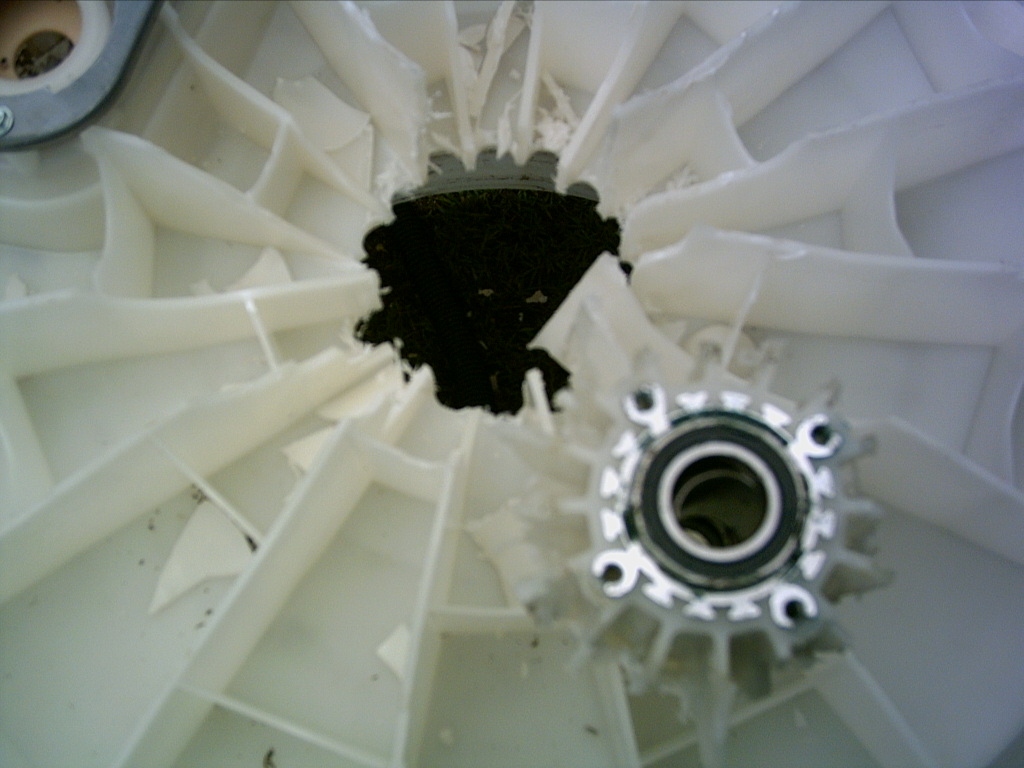

Hi this is the method I use to remove the plastic bearing holder from the base of the machine.
Use a large drill bit and drill out around the bearing holder. next from the inside& outside use a jigsaw and cut between the holes.
Next use a hammer to breakout the bearing holder from base. use safety glasses also.
holder should break free
AJ

I contemplatd drilling one hole, then using a jigsaw to cut out around it, but the believe it or not, I was actually hoping to leave the bowl intact.
The missus is a keen gardner - and it looks like it could make a pretty good fertiliser bowl. Drop a large bolt through the old hole where the shaft was, with a neoprene washer. Do up tight. Re-install the drain pump, add a mains cord....
Chuck in some moopoo, fill up with water, stir/agitate. Then, when she wants to fertilise the plants in the glasshouse, just turn on and she has suitably diluted liquid fertiliser "on tap" (or comming out the hose!)
I suppose if the bearing block were removed, I could make a larger cap... but it'd be a lot easier if I left it as it is.
Most of the pics I've seen *SEEM* to have discarded the plastic bearing holder anyway and turned a new holder down out of steel or something anyway?

            Well mate I used a similar method for removing the bearing holder then I rasped it down to fit snuggly inside some 75x75 RHS then I tapped4x 6mm holes in 2 sides and stainless capscrews keep the bearing holder locked in place. When I get the film developed for my camera I can put some photo's up of my first F&P wind genny as my digital camera went for a swim and I aint replaced it yet.

Hi Tom , been using the Nylon / Aluminium bearing housing for 10 years --perfect--- Have them on a test bed and in the air,no problem at all . I actually use a Sabre saw to cut them out ,5 minutes work . They secure it in the vice and shape it with a spokeshave -works a charm. I then go ahead and fit the shaped bearing holder in some rectangular or circular pipe and drill and insert a few pop rivets or self tappers in there --solid as a battleship

i used a wood splitting axe to remove the first bearing holder, then for the other 2 i just used a long bolt and a hammer to bash the bearings out and threw the rest away.

For the not so frightened amongst you a chain saw is the fastest way to remove the guts. About 30secs with no sweat.
