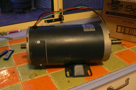

Hi All,
I scored this motor on Ebay, thinking it would be good for my new project:
It creates 6.2 volts when turned by hand.....great!! It has 2 shafts, the short shaft is 5/8" in diameter, and the longer shaft is 20mm Diameter, so I plan on getting a 5/8th Arbor to mount the hub on.
BUT when I put my multimeter on AMPS, it becomes REALLY REALLY hard to turn by hand, although it does produce 1.32Amps by hand. Is this normal to become so hard to turn? I have been in contact with Windy Nation and they recommend I use their 5 Blade Hyper Spin System, which I was looking at anyway, but I fear I will need a hurricane to get the blades spinning
What are your thoughts on this please? (Be gentle on me tho )
Also, do I need to waterproof the housing and brush area with it being DC voltage?
PaulEdited by paul_mac1 2010-06-18

Hi Paul
Looks like a good bit of good gear but the blades you mention will have a hard time driving it to any reasonable output.
The reason that it is hard to turn when you put the amp meter on the output is because you are in fact shorting out the output through your meter, in practice it will have no load on it until it exceeds the battery voltage its connected to as it would be isolated by a diode in the line to stop reverse current flow.
The loading the blades will see is what you feel when turning it without the wires connected to anything.
I would look at the 80 inch five blade combo that they offer if you are going to go with their blades for better spin up torque.
You may also need a dc/dc down converter to get the best out of it as I see it is rated at 180 volts so its output may be around 80 volts at reasonable speed as the windy city blades are designed to do.
I think it would be well suited for a 48 volt battery, but others on the forum will have all sorts of ideas so listen to all and do the best suiting what you want.
See if you can set it up a drive to it to try it at various rpm's and volts and amps that will give you the best indication of what it can and cant do.
All the best
BobEdited by VK4AYQ 2010-06-18

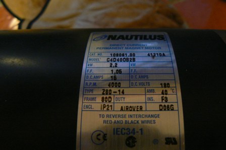

Its a good motor, and should be ok. I tend to disagree with Bob a little though. Its rated at 180v at 4000rpm. These motors make a little less when used as a generator than a motor, so if you spun it at 4000rpm I would expect maybe 150 volts.
Now a windmill will run at 100 to 1000 rpm, depending on diameter and blade design. This motor would make ( approx ) 0.0375 volts per RPM ( 4000rpm / 150volts ), so it will start charging a 12v battery at 320 RPM, not to bad. 24v is 640 rpm, too high! Stick to a 12v system.

That motor is rated at 2.2kw ( 2200 watts ), but as a windmill it will only make maybe 200 watts tops. This means its under-rated, and wont need those cooling holes. I would block them off to keep water out, and your brushes will last longer. Just leave a small hole at the bottom somewhere to let any moisture escape.

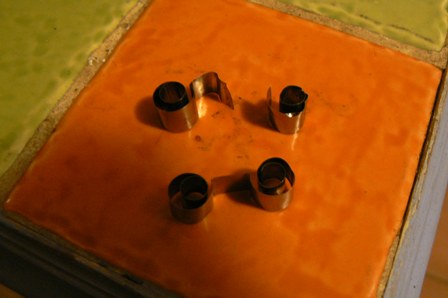

BUT the person I bought it off put the small metal coil things that hold pressure on the brushes in the wrong way, so when I pulled them out, one came out in 2 parts.....bummer!
Does anyone have any ideas as to where to get these things from? or what is a suitable replacement?

Can you post a photo of the "little metal coil thing" thats broken.

  Downwind said   Can you post a photo of the "little metal coil thing" thats broken.
Pete.
Here you go Pete:
The top one is the broken one, the bottom one is how it should look.

Gee never seen any thing quite like that.
I had wondered if you could use the spring retainer from a starter motor but havent seen any like those.
Send the seller a email and say you had trouble with the motor and on inspection you found a broken brush retainer clip.
Under ebay rules he should replace it or send a replacement part.
If you dont ask in this world you dont get.
Worth the cost of an email i would think.

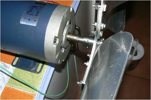

OK, well......My 5 Hyperspin Blades, Hub and Arbor have turned up from Windy Nation, 1 week from ordered to delivered, that's pretty good, as they came to Adelaide from the US.
I am just making a mount, to mount the motor on, it looks like I will have to cut the metal stand that's welded onto the motor off, as the weight is off centre.
Am I best off just using a car hub and bearings from Supercheap Auto or what? Or am I best just manufacturing a plate with a bar that inserts into a bearing assembly?

Hi Paul
The stub axle and bearings works well, the brush springs can be made from some modelers spring wire available from aircraft model shops, you make a pin jig and wrap several turns around the pin to duplicate the shape and size of the original, I am assuming the brushes have a pig tail wire attached, if not you will have to make one by soldering pig tail wire to a piece of copper and place it under the spring in good contact with the top of the brush, this is necessary as the spring wire will heat and soften if you run much current through it.

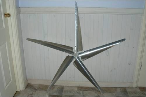

Posted: 02:15am 19 Jul 2010

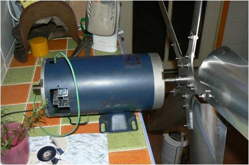

OK, here's a pic of my blades from Windy Nation:
I also got an arbor to mount the blades onto the motor shaft, fits like a glove.
The problem I now have, is that I don't have access to welding gear, and the motor has a stand spot welded to the outer frame, as shown in the picture below, But the weight is off centre would it be worth removing the stand somehow and attaching the casing directly to some sort of mount or just leave it as it is?
The smaller shaft on the left is the side the blades go on, but the stand is off centre, would this matter? As long as the head of the mill is level horizontally, it should have no problems in turning into the wind, right?
Next problem is mounting it onto a pole. What is the best set-up for a bearing mounted onto a pole?
Thanks Guys.
Paul
brucedownunder2
Joined: 14/09/2005
Posts: 1548
Posted: 02:28am 19 Jul 2010
Hi Paul , the stand will be ok left where it is ,I've a couple of those motors , that stand saves you lots of welding work which ,by the way, you would have to remove most of the "innagds" before welding. mounting on a pole ,, try a flat plate ,say 1/4 inch thick mounted on a pipe..put a collar on the pipe and it then slides into the mast pipe and revolves ,easy, feed you wiring down the inner pipe and untwist every few weeks ,plenty of info ,just read about it on this forum.
