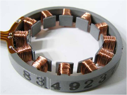

How cool is this?
This is a stator out of a computer hard drive. Looks almost exactly like the F&P
guts without any cogging iron cores (although they may actually be there, merely
hiding under plastic). Still, it's pretty cool that you could save weeks of shop time
short-cut by a little creative dumpster diving!
Just a thought. Of course, you know what they say about "idle minds"!
Edit: I just figured out that if 4 coils were wired in series and the magnets spinning inside the core were arranged properly, it would make this puppy a 3-phase alternator, right? (Thanks to Oz for that cool link!)

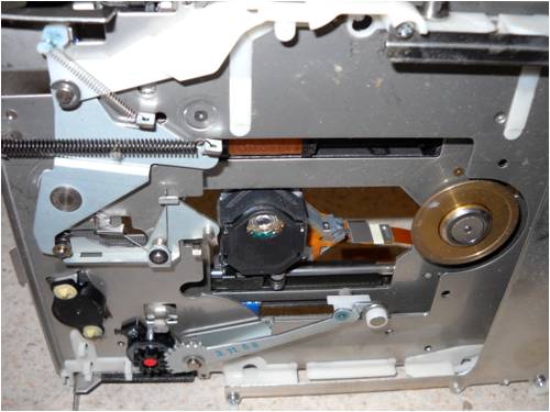

I scored a throw-away-ready hard drive from a neighbor. I took it
all apart to find that cool motor pictured in the first post.
Ain't takin' stuff apart a gas?

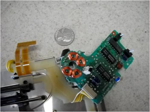

Here's the part I thought I was looking for. That's a quarter next to
it (American 25-cent coin) to give you an idea of its size.
As most are already aware, I'm into "small" but this is even beyond me. There's a country-western song sung over here and the guy singing says something like "It's okay to be itty-bitty . . . etc." so I just figured that if small is cool enough for the s*!t kickers, it's okay for me too. Well, small is cool, but this is way too small, even for me!

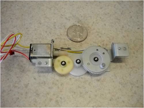

Don't quite know what to make of this. It's an itty-bitty electric motor
with a worm and down-gears. Too cool to toss. It's headed for my
"Damfino" drawer. Damfiknow what's in there!

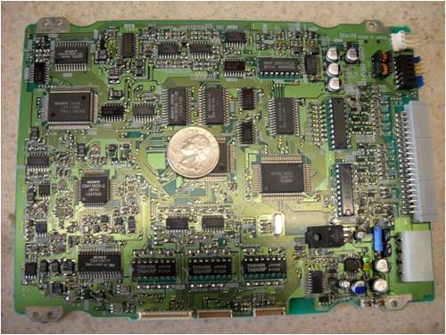

Remember that Barbara Striesand song, "Memories"? Here's some for
ya. This is the hard drive memory, I think. That's the same quarter
sitting there, by the way; everything here is rrrrrreally small!
I feel the dumpster-diving urge comin' on me! I'll find one sooner or later and when I do, I'll post it here.

They are the same as what some of us have used for ages in anemometers and phone charges, rotory encoders, etc.
You will find they are already a 3 phase motor and no rewire of the windings needed except for the same reasons as we do with a F&P.
You will find these sort of motors in many things from HDD, to pc fans, video heads..........and the list goes on.
A lot of times you will find there is 4 wires because they bring the star connection out and tie it to +v and then phase the 3 sets of coils in sequence with V- to give rotation.
If you want to use it as a generator than forget the star connection and rectifie the other 3 wires and ...presto.. instant generator.
