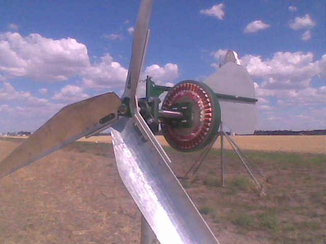

Hi all,
i have built 3 F & P mills and have one on a test stand & the other two in the waiting till i get everything right, i'm new to diy wind power and was wondering if there is any difference in performance when you run DC from the generator to storage (rectify at top of post) or run the 3 AC phases to just before storage (rectify immediately before charge controller and storage)
thanks glenn

Rectify at the pole on the ground.
there are heaps of posts on this topic but trust me, rectify at the pole.
Karl

Hi Bigdog,
It is really a matter of how long of a run you need to do from windmill to battery.
Karl is correct but there is advantages in running the AC to the batteries if the distance is not too far.
If practical i for one would much rather have 3 phase to batteries and all my control gear together in a shed.
This also allows greater flexability.
For long cable runs this is not practical as the cable loss is higher with "Wild AC"
I would not have the rectifier up the pole with the mill.
If need be have it at ground level and Dc cable from there to the batteries.
Pete.

pete,
thanks for the reply, the distances will be 6.5mtrs gen to ground and 5mtrs to battery bank, where would be ideal? thanks for your help.
thanks glenn

Hi Glenn,
you are talking a short cable run distances, so rectifying at the batteries is OK.
Gordon.

Hi BIGDOG,
My short answer to your question is that it is better to take three phase AC to your shed. It is interesting to look at some numbers for comparison.
First, to take the cost of 3 wires versus 2 out of the argument, let us assume that you already have 3 wires in place, and that each wire has a resistance of 0.1 Ohm. This resistance is higher than you would expect, but it simplifies the numbers in the example.
Because your wind generator operates at low frequency, we will also assume that the AC resistance of the wire is equal to the DC resistance.
Next, let us assume that you need to get 10 Volts at your shed to drive 10 Amps through your 1 Ohm load. The power into your load is therefore 10V X 10A = 100 Watts.
The bridge rectifier that converts AC into DC will have its own losses of probably about 15 Watts. If you put it at the shed and run AC, then the wires between the pole and the shed will also have to carry a little more power to supply this loss plus that of your load, making the total at the shed end for AC of 115 Watts.
As you have 3 wires, for the DC case, two of these will be paralleled for, say, the positive run. Therefore, in the DC case, the resistance of the positive wire will be half the 0.1 Ohm resistance of the negative line, or 0.05 Ohm.
The voltage drop in any wire is equal to the current multiplied by the resistance. In the case of the positive wire, it is 10A X 0.05 Ohm = 0.5V. In the case of the negative wire, it is 10 X 0.1 = 1V. The total voltage drop in both wires is therefore 0.5 + 1 = 1.5V. This might not sound like much but, when your load voltage is only 10V, this is a 15% voltage drop.
The power loss in any wire is equal to the square of the current, multiplied by the resistance. This is an important point to remember, for, if you double the current in the wire, you will get 4 times the losses.
The power loss in the positive wire is 10 X 10 X 0.05 = 5 Watts. The power loss in the negative wire is 10 X 10 X 0.1 = 10 Watts. The total power loss in the wires is therefore 15 Watts, or 15% of the “useful” 100W power delivered to the load in the shed. Remember also that this is the loss using 3 wires. If there were only 2 wires, the voltage drop would now be 2V, or 20% , and the power loss would be 20W, again 20%.
In the AC case, each of the 3 wires delivers 1/3 of the power to the load. Even allowing for the extra 15W the wires have to handle by having the bridge rectifier at the shed, the current flowing in each wire is still only the DC equivalent of around 6.6A. The method of calculating this number involves some AC theory which might be confusing, so I have omitted it.
If each wire now only carries 6.6A DC equivalent, then the voltage drop in each wire is now 6.6 X 0.1 = 0.66V, and the power loss in each wire is 6.6 X 6.6 X 0.1 = 4.36 Watts. The total power loss in all 3 wires in the AC case is therefore 4.36 X 3 = 13.08W.
So there you have the comparison. In the (3 wire) DC case, the total voltage drop in the wires is 1.5V, or 15% of 10V, and the power loss is 15 Watts. In the AC case, the voltage drop is 0.66V, or 6.6%, and the power loss is 13 W, or 13%. In the DC case, the losses are substantially higher again if only 2 wires are used.
One final comment. Many wires have a “current” rating which is based on the current that they can carry at a power supply voltage (eg 240V AC) with only a small percentage voltage drop (ie 2 or 3% of 240V) when used over a typical household route distance. The wires can certainly carry that current at any voltage but, as the operating voltage gets lower (say down to the 10V used in our example), the voltage drop can be a real killer over even short route lengths.
The message is that, with low voltage systems, always use the biggest wire that can fit in the terminals. If this is still too small, get bigger terminals.

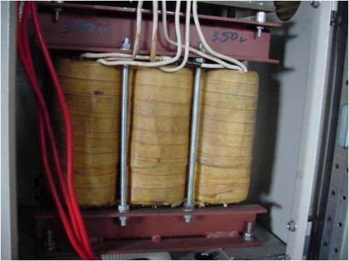

Up on the mountain, we have the AWP. It transmits the AC down to the shed at 300-500v or so. It is then transformed and drives the 24kwh battery bank. It's rated as 1kw, but drives the batteries at 1.5kw and more.... ac is handy. The line length is probably 3-400 meters... never measured it properly.
I'm surprised this solution has not been applied to F&P's too. It gets the ampere turns down in the salient poles, and should lead to better outputs from the stators from less reactance. It is not like microwave transformers are scarce, or not easily rewired to spec.

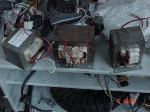

<It is not like microwave transformers are scarce, or not easily rewired to spec.
Where are you suggesting using re-wound microwave transformers?
oztules
Joined: 26/07/2007
Posts: 1686
Posted: 11:19am 26 Jun 2010
in a word yes

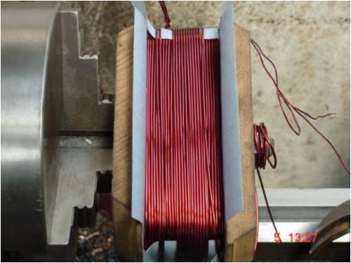

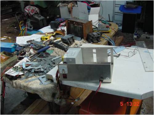

like this:
and this:
and using 2 lots of plates for a 1.5kw unit..... like this
And here we are winding the primary for that big one. .... it's 1.8mm wire.
Those microwave transformers are the best thing I have come across for good laminates. Their original primary is no good for 240v operation, as it is designed for ferro resonance application (hence the shunt in between the windings). It is designed to run over saturated.... which translates to HOT.
So the windings are only good for spare wire. But the plates are great, and a lot of them use the same size stampings, so you can design your core for whatever cross section you want..... just keep adding plates until you get the square inches that you need to fit the windings in the window.
Strangely, for laminates that are welded together, the eddy currents are not too bad, although I like to separate them, and assemble them in the traditional manner. (the mess in the picture above)
The only exception to this is making low impedance transformers for electric fencing. There I just cut the transformers open at the weld, wind the new windings, and weld them back up. One 40 microsecond pulse per second or so, is not a duty cycle as far as I'm concerned, and they will run fully saturated in this application ..... so niceness is out..... I also use the secondary winding as a source of wire for winding the secondaries of the multivibrator transformer (ferrite core) that supplies the 700v to the primary of the main transformer in this instance
Yes, it will take 3 transformers for a 3 phase unit...
Here is the one off the AWP system.
................oztules
