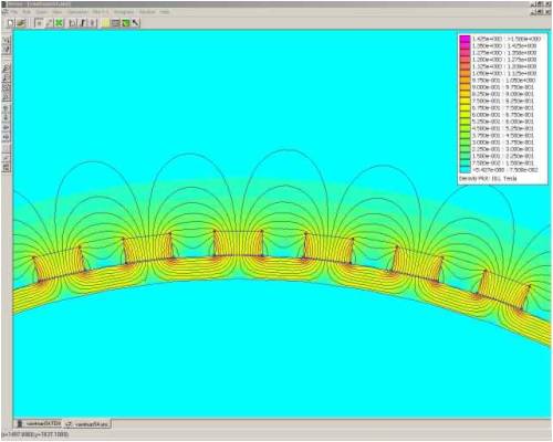

OK, maybe I have been working under a misconception. I was thinking that the highest point of magnetic flux is in front of the center of the magnet. But what I think you are saying is that when an appropriate metal is used then the highest point of flux is actually between the two magnets.
Lets say my steel disk is 5.5 inches in diameter, my neos are 1 inch wide, and the gap between the neos is about .125 inch. Like this.......
Then the flux bends around like this....
Am I correct?
Thanks again!
"As for me, all I know is that I know nothing." - Socrates

No. Not quite. (EDIT: Looked more closely at your pics, and yes they are close to the same thing)
This is what dual magnets without disks look like. The darker the background, the stronger the flux.
Thanks to Peter Dingesman
Using the same dual magnets, with steel plates, and equivalent color scheme, it looks like this. Purple is strongest, light yellow is the weakest
Peter Dingesman again:
Short magnets will exhibit much worse leakage, as it is easier to "short the magnet from top to bottom", as the distance from the N face to the S face is quite short.
The magnet gap will also dictate how much inter magnet leakage occurs out the front. These pics are for dual axial flux, where you can see how focused the fields are before we move the plats apart. At short air gaps, the thing hardly changes, but as we move out further, small intermagnet gaps look more appealing to the flux, and we "leak" between magnets without traveling out into the air gap we want them to.
These show how the steel focuses the flux lines where it is not dual axial, but single as you have depicted. (Peter Dingesman again)
So with the dual, the max flux is where you predicted, but with a single plate, it is shifted to between the magnets..... not where you originally felt was the right place.
And no, I can take no credit at all for what McGyver has or hasn't done, as he takes not the slightest notice of me anyway.. It is all his hard stubborn work that will get him there eventually. He's keener than mustard..... but a born maverick I think.

Oztules, Thanks for the picture show. It really helped me get a better grasp on this part of the subject. I think I am beginning to understand the magnetism part. I didn't really understand the flux as a circuit concept, or the peak point of the flux-arch between two magnets. Now it is beginning to make sense to me.
Although my bigger magnets are a paycheck or so away, I will start the planning for the beta version of this experiment. I will wind some different coils for testing and let the group know how it goes.
I do have questions though.
Is there any value in magnet proximity to each other? In other words, should the edges of the magnets touch each other, or are they better separated.
Once it starts producing electricity, how-ever little, what is the best way to get it into a 12 volt battery?
Do you have any opinion of capacitors on the AC side of the rectifier? I know by adding a couple of capacitors after the rectifier the ripples in the DC can be smoothed into cleaner DC, but I am not sure what value capacitors would have pre-rectifier.
Thanks again!!!

Magnet proximity:
This is fairly flexible, and is really a function of how desperate you wish to throw money at the project, and your air gap.
General rule 1 is about 1/2 a magnet width between magnets.... (unless of course general rule 2 ....at least the air gap width...suits us better )
Now like all general rules, they are there to be broken, and in this case it is true as well. If you need to get more power into a given design, then more magnets will do it, even if used poorly (from a purists view perhaps), so you can squeeze them up a bit and still get better results... despite massive leakage.
In essence, for reasonable performance from a GIVEN set of magnets, then it is the air gap that will dictate the closest inter magnet spacing.
The only reason we have to space the magnets apart is to stop them leaking flux to each other, rather than crossing the air gap and passing through the coils..... so it stands to reason, that if the air gap is such that the majority of the flux crosses it, rather than leaking next door..... then we are on a winer.
So the second rule of thumb, is ignore first rule, and instead, if the inter magnet space (side by side) is the same or more than the plate to plate magnet airgap, then leakage will be very minimal. This turns out in most instances to be closer than the 1/2 magnet width in the case of round magnets, and not so with rectangular ones.....hence the general rule stated in the first place..... it is reasonable in most cases.
Eg, for round magnets 2" x 1/2 inch thick, best air gap will be about 3/4", and so magnet side by side can be as close as 3/4" for low leakage. Here 1/2 a magnet width would have been 1", so we can close it up a bit more than the general rule would have us believe IF we need to..... but winding window is better if left at 1" at least....
For the other popular size, 2" X 1" X 1/2" rectangular ones, the air gap will still be about 3/4", but this time the most compact size will be 1/2 magnet width.. which is 1/2".... at the closest point. (inner radius). Leakage will be a little higher, than 3/4", but will perform well. (3/4" probably a bit better... and more winding window as well)
I said it was flexible, and luckily so. If we want maximum power, we can space the magnets further apart on a slightly larger disk to get bigger winding spaces, for more copper... more current, if were light on magnet, we may do this just to get more copper in there to lower our losses on the greater number of turns we will need with less flux... it's all just a compromise between what you want and what is available to you to try and achieve it.
But no, we definitely don't want them touching.
