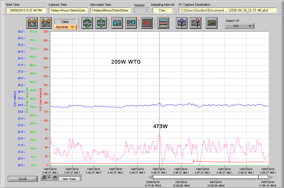

The other morning when the strong cold front came through, the wind picked up a lot- 10 min average around 30km/hr with gusts a bit over 50km/hr. The 200W WTG (as sold by Jaycar et al) I have up at the moment has a nominal rating of 200W, with a supposed max of 300W. Maybe it has if you use the junk regulators they come with, but I've tried 5 of them, and they were all faulty, so are best used as a source of diodes to rectify the 3phase AC only.
Here is a trace of a short period from Wednesday morning showing a peak of 473W. When the wind is coming from the west at home, it's quite turbulent, as I am right at the base of a very steep 150m high hill, and there are plenty of large trees nearby, so the output varies a lot. Also after big gusts the tail furls. The pink trace is current, using the same scale as the green trace.
I'm running this WTG through a BlueSky MPP regulator, which no doubt helps get the most out of it.

Hi Loomberah
Thats a good result. I have see those cheap mills pump out over their rated pwer before. There is a article on the site about modifing the blades for berrert top end power...
http://www.thebackshed.com/windmill/articles/ChineseBlades.a sp
David up near Townsville has seen over 350 watts from his.
A lot of the Chinese stuff is like that, a good design or core component, that was put together badly in the factory, so you just need to re-engineer it to get better results, a bit of fine tuning.

Hi Loomberah,
the best way to confirm the mill is performing well is to monitor the input voltage of the Maximizer, with the associated current.
The input voltage to the maximizer should indicate rpm with some correlation. The output power can be calculated and plotted against this voltage. I would think that if the result approximates somewhere between a squared and cubic relation that the windmill would be tracking the wind reasonably well. If the output power increases by a factor of 8 for a doubling of the windmill output voltage, then this is the ideal relation.
My windmill analyzer program plots this type of relation with the windmill rpm. The program you have seems to only have a timebase x axis, so you may need to spreadsheet the data.
I think the 12V/24V chinese mills have been recorded at producing over 700W, with original blades[balanced of course], but not into a battery load.

Posted: 11:33am 15 Jul 2010
Near 500W from a rated 200W mill with crappy blades tells me it is working well enough
I'm making some new aerofoil blades from plywood for it... but finding a spare day to finish them is the hard bit. I am away from home a lot, and there is plenty of higher priority stuff to do when I am home.
The plot I posted is only the basic plot from the data logger software, I could plot input V and A vs output V and A on an XY graph if I needed to measure them.
I am planning to test the alternator from one of these (I have a few) on my hydro power system sometime soon, and put the 500W one up a 17m tower when I finish the blades for it.

Hi Loomberah,
The data you have published shows that the windmill does not seem to load optimally, even though there seems to be good power at the top end. The current tells me that the windmill seems to favour top end power. The maximizer seems to give good results, but I think the low end is missing. Without other data, this is speculation though. I have many years of my own windmill and weather station data now, and this part of your data, and the flat topping of many of the peaks suggests to me that the mill if furling heavily at the top end, and the higher peak was a result of the windmill just happening to hook into and out of furl, with the resultant characteristic current trace.
In the 10 minute time segment, there are times when the current drops close to zero. You say the windmill furls when this happens. On my own windmills with a maximizer, the current does not drop to zero unless the wind stops [drops to under 5kph]. My own windmills are slightly higher than my house, and are in a lot of turbulence as well from other buildings close by.
The main thing is that you are happy with the way the windmill works.

Posted: 02:17pm 15 Jul 2010
The mill is actually much lower than the trees to its West side, so the air is very turbulent, hard to avoid when at the base of a very steep hill, without a 50m tower. Its on a 10m tower now. It starts producing power at 12-15km/hr, depending on direction/how turbulent it is, and turbulent air has much less power in it. The power drops to near zero after a big gust are generally due to furling and/or lulls, and it does sometimes stick in the furled position for a bit. Turbulent air makes it furl early sometimes too. All the rest of the ups and downs are due to varying wind speed, it is never smooth from that direction.
I'll be modifying the furling arrangement so that it doesnt happen so early, max gusts I see at home are generally only 50-60km/hr. It furls before 40km/hr by design at the moment. I'll adjust it when I redo the blades and bearings before putting it up a higher tower.
I do not live in a good position for wind power- average wind speed over recent months is 3-4km/hr! The WTGs are just there to generally collect SE winds on summer afternoons, and during extended cloudy periods when strong SE wind can blow.
