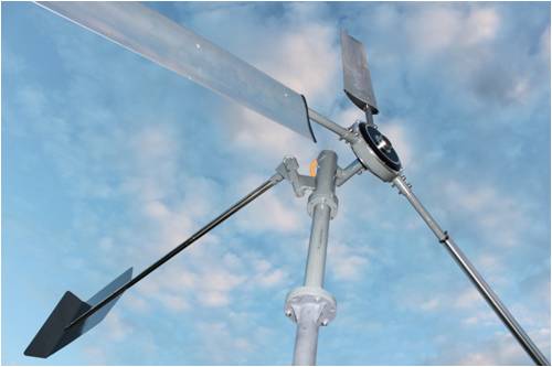

Its been a while since I have posted anything as I have been fairly busy with a couple of projects . I was full steam ahead with the design of my new Ax 300 & Ax 400 when these kits landed on my door and then the fun began .
The first 500w Kit went up to Mackay with the dual F&P that was going to be set up to the Mega Piclog project , this was postponed indenfinatly due to problems at the site, I left the 500w kit with Glenn who set it up at a freinds place which turned out to be not a good wind test site . Since then Glenn has moved it to where he is living and has it set up on his logger and hopfully soon some data will be available to be viewed on the site .
On first appearance I thought it was a piece of Junk and was happy to be rid of it and get back to my Ax Fx builds, but I bought back a one of the generator heads that Glenn had been given and set it up in the lathe and carried ot some tests on it in 12v & 24V . It was designed as a motor to fit into bikes and there are a wad of them advertised on ebay , it has 51 poles and 46 Neo magnets a strange little motor/generator . As a 12v in its origional wiring config it was hopless and loaded to heavily at low Rpms , 24v was reasonable with 700w @ 350Rpm ,which I think is still a bit low in rpms for the 2.4m Aluminium blade set to deliver that kind of power .

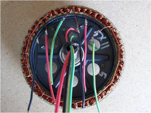

I then pulled it apart and found the star point and reconfigured it into delta , put some 2.5mm wire to the stator instead of the piddley 1.5 and wacked it back in the lathe . The difference was a eye opener for 12v and 24v especially . Torque was almost 1/2 at the same output in 12v @ 350rpm @ 550w with a lot higher cut-in, but in 24v for a lower torque @ 550 Rpm it was punching out 1065W and my lathe motor could not go to the next level .
Pic of Modified stator , drilling has to be enlarged a bit to fit 3 x 2.5mm
However the draw back is the high cut-in Rpms of 330 in 24V, which makes it an ideal canidate for the Cap/dblr to take care of the low wind power
The one that Glenn is testing has only 1 main modification done so far that is he lengthened the tail approx 250mm to make it track the wind a bit better and adjusted the blades to 10deg . He had some good wind a few weeks back and saw 540w peaks but the low wind is not very good.
The kits that I have are the very first models to be produced and I have found quite a few areas that need tweeking , but on the other hand it is a very sturdy little unit with some very good points and with a few mods can be a 1kW mill with good all round performance for the price ,( The kit price and more pics/info is in the For Sale section ) it also comes with a 6m mast that is not a piece of junk. I can't match its performance or cost with my F&P duals and will not be making any more .

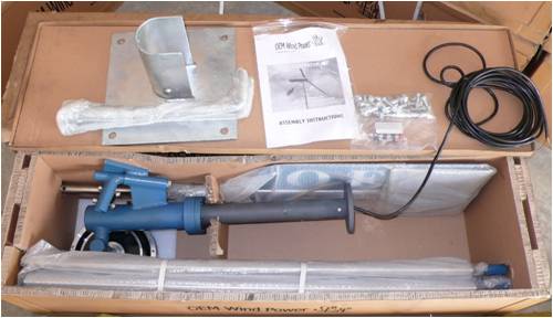

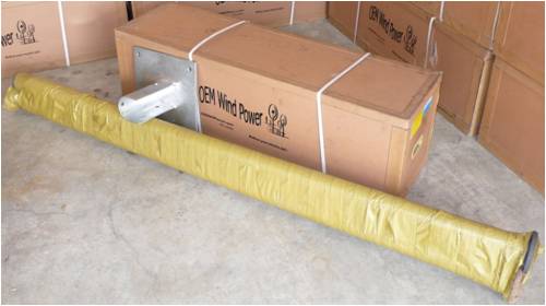

Kit and the tower in packing .

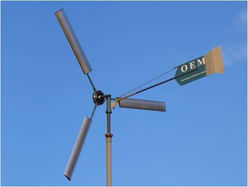

I have one up and flying on one of my masts with a logger to monitor performance and it went up at first straight ot of the box , as you can see from the pics it has the Aluminium GE222 airfoil blades on full length steel tubes @ 2.4m Dia , I had fitted a shorting switch first up because these do stop when you short them , I went out for a couple of hrs and of course the wind started and I got a call from the wife to say the mill is shaking the hell out the tower , she threw the switch and it stoped .
Straight out of the Box .
At this point I started to do some mods to get the performance up to what I had seen on the lathe testing , as the blades were on full length steel tubes I decided to move them out to 2.8m, balance them, get the angles right . I am very fussy about 3 main areas- Blade balance , Tracking the wind , Furling that works .
Below is the list of what I have done to get it performing
1 ~ Lengthen Blades and dynamic balance & design a simple balance tool for future use
2 ~ change furling angles and also give the tail off-set
3 ~ Increase the tail length and add a kicker to the tail end
4 ~ Strainer stay wire to assist in carrying the tail weight .
5 ~ Re-Wire stator with 2.5 mm wire and set up so Star & Delta can be changed by removing front cover .
6 ~ Increase wire size into and out of slip ring assy
7 ~ Weld in a strainer inside the tube to take the weight of the cable of the slip ring connections
8 ~ Fit a Cap/dblr for low wind performance

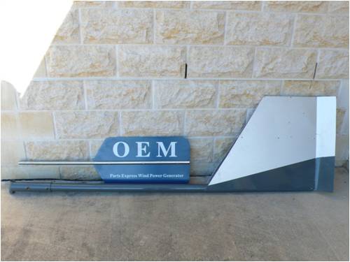

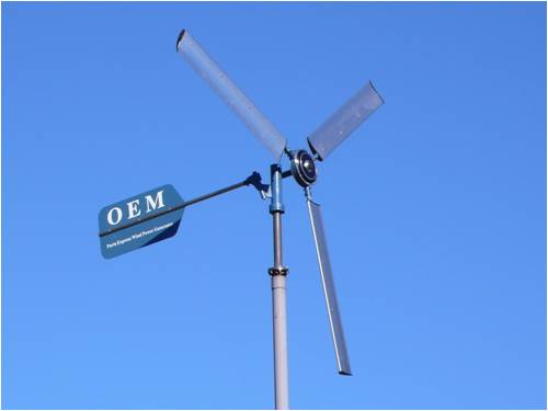

This is the origional tail size against the tail I put on the F&P Duals .
This One I have now done all the Mods to .
The Pic below is one that Forum member Amac has purchased, I have done all the mods to it and is on the way to him at present, he lives in a high wind zone and is setting up logging as well , he will be doing his own thread on how it all goes .

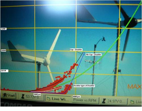

This Pic shows the difference a Cap/Doubler makes on " Gordons Windmill Analyzer" , this is a great tool to use when comparing changes to performance .
With all the changes it is now producing good power in low wind , all the readings in the pic above are in wind below 15-20 klm and it starts producing in under 10 klm .
