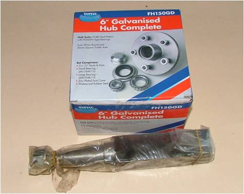

Well after a conversation with one of the long time forum members, I've decided to get my act together and start work on the Axial Flux windmill I mentioned in a previous post.
The big hold up has been location, I'm still living in a rental till my place is sold and very limited in what I can do. But Trev is going to help out with a location for testing, and his fiberglass skills in making the stator.
This is the new windmill so far, impressive isn't it.
OK ok, not much to look at yet. Now that I have the hub I can finish the design work on the PC and get the magnet plates and stator supports lasercut. Its going to be a 24 magnet 9 coil axial, magnet spacings and coil winding based on the Other Power and Hugh Piggott designs, but using a different construction.
While a wheel bearing is not the most energy efficient bearing I could use, it is by far the easiest. The turbine will be 4 meters in diameter, and the blades built using Oz's chain saw technique. This will be the prototype, to iron out all the bugs. We'll then build a second and put the plans on paper ( the web site ).
I'll update this thread as it come together.

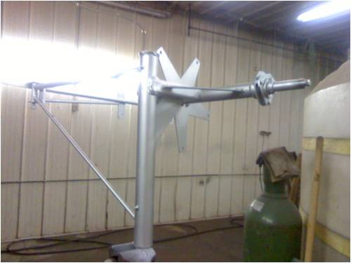

Based on information from a couple other 4m members, I've decided to use a shaft on bearings separated by several inches instead of the Timpkin tapered roller bearings used in automobile hubs. "My" reasoning is different from most, as I build only small stuff and the internal friction of a tapered roller bearing (especially a new one with no run-in time) is too great for my small blades.
Chris Olson has said he doesn't use the hub bearings either, because they are too difficult to adjust, especially when they're 80 feet up in the air.
Another reason for my choice is I have gone to using multiple rotors in an attempt to garner more current from a small-diameter alternator. I don't know how much weight you can cantelever on a single tapered bearing before it starts to wear excessively, but adding more rotors would do just that. My small toys have sealed ball bearings at each end and can support any load I throw at them.
Just some stuff to think about while you're in the planning stages.

Posted: 06:06pm 27 Jul 2010
True, but roller bearings dont take sideways thrust very well compared to a taper bearing.
I know there is drawbacks with taper bearings but i do like the "off the shelf" approach for a base model.
Then a 4m prop should have a good torque range to boot.
Pete.

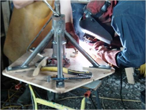

the bearing in here is out of something big and ugly from a nearby agricultural scrapyard .. it cost 20 euros (about 28 Aus dollars)..the whole machine is built around it
the bearings and shells were replaced before the mills final assembly ..
i think (...and its just a thought.) with thrust bearings like this, running with as big an air gap as the mill is comfortable with is the balance ...air gap (including play tolerance due to wear and tear ) seems the deciding (..builders choice..) factor
ps...the welder in the pic is called Sean... very nice welder too Edited by niall1 2010-07-29

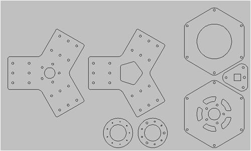

Posted: 08:21am 29 Jul 2010

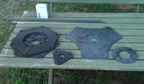

I've finished the cad for the steel magnet plates, stator supports and blade mounts. I'll send these off to get a couple of quotes from the local laser and waterjet cutters. I also need to cad up the mould, and get that cut from MDF. All these bits could be cut by hand, but I'm lazy. Besides, its a new design and there are bound to be little changes needed along the way, so I'm going to make it as easy as I can for myself.
Magnet PCD is 270mm. I wont go into what the individual bits are.

Posted: 09:50am 10 Aug 2010
Have a few quotes back from a couple of local metal engineering firms. The laser cutting came in cheapest, but I was expecting that.
For cutting mild steel, plasma cutting is the cheapest, but the least accurate. A cnc plasma cutter would struggle to cut a nice a 13mm hole in 10mm plate. You could get away with plasma cutting the outside shape, and then mark and drill the holes yourself, but I dont have my workshop set up for that sort of work, I wanted all holes cut out for me.
A waterjet will cut out the holes easily enough, but waterjets cut mild steel much much slower than plasma or laser, so even though the process is cheap enough, the extra time taken to cut mild steel makes it a more expensive option. However, waterjets cut aluminium much faster than a laser cutter, so if you ever need to cut aluminium, take it to a waterjet cutter instead of a laser cutter.
Lasercutting is by far the cheapest way to cut mild or stainless steel, especially if you want some accuracy. As a rule, in mild steel a laser can cut a hole as small as the material is thick, so if its 10mm thick plate, the laser can cut a 10mm hole with reasonable quality. I need 13mm holes in my 10mm plate, so they will cut out fine.
To cut out the two magnet plates and stator bracket from 10mm mild steel, and the two stator sandwich plates and two blade mounting plates from 3mm mild steel, will cost approx $230, including material. Here in Mackay we pay about 30% more than other regional centers, so I would expect it to be less than $200 everywhere else.
I've placed an order and should have them by the weekend.

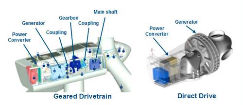

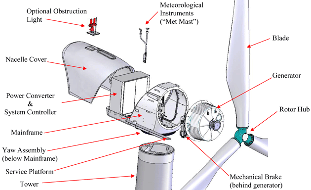

Perry
Joined: 19/11/2009
Location:
Posts: 190
Posted: 08:38pm 10 Aug 2010
  ChrisOlson said
They don't build utility-scale turbines by hanging a generator and set of blades on a Kenworth steer axle spindle and hub. They build them with mainshafts riding on self-aligning bearings of various designs, and either drive the generator and hydraulic systems with a gearbox or direct-drive PTO. The same concept can be applied to homebrew turbines. I've built lots of them such as this one with a PTO-driven, direct-drive, rear mount generator:
Chris
True but they are starting to design big turbines like that. Recent trends in the industry are leaning towards direct drive PMA turbines. They actually have a 'truck looking' spindle the size of a Volkswagen that the generator hangs off the front of.
It's funny because I always thought small wind would start to emulate big wind. I see more of the opposite happening.
Perry
ChrisOlson
Joined: 19/01/2010
Posts: 60
Posted: 01:42am 11 Aug 2010
Some are permanent magnet, but they're incredibly expensive to build. Enercon in Germany has long favored wound-rotor generator technology in their direct-drive designs, although permanent magnet technology is now the choice of most manufacturers of direct drive units under 90 kW.
A direct drive generator, with a wound field rotor is more complex, requiring excitation power to be passed to the rotor, but it benefits from additional controllability that you don't get with PM rotors. Without that controllability it requires expensive (and usually inefficient) onboard converters to sync the machine with the grid.
Chris

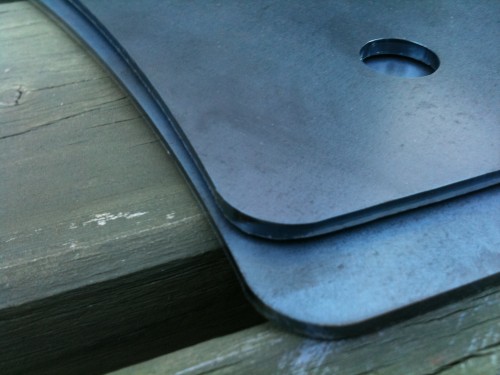

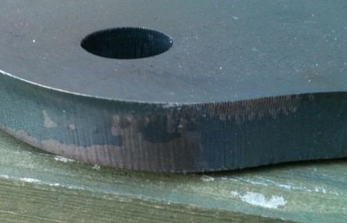

Posted: 08:17am 13 Aug 2010

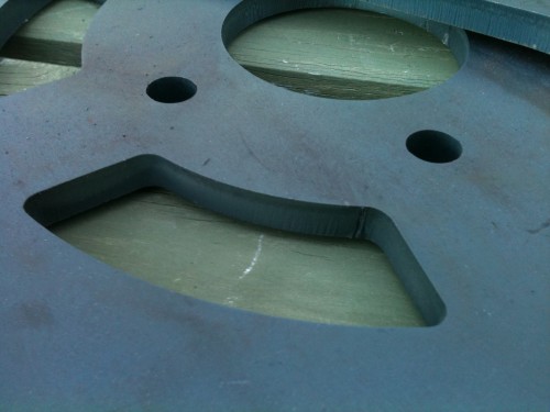

The laser cutter (http://www.lrsmky.com.au/) phoned to say my parts were ready, so I dropped round to pick them up this afternoon. While I was out I bought some 12mm and 5/16 threaded rod. I picked 12mm (M12) over 1/2 inch because it has a higher thread count, so should make jacking the plates apart easier. If I find the 12mm it just to small a thread, I can drill out the holes to take a 16mm thread, there's enough clearance in the design.
I'm pretty happy with the cut quality. This is the 10mm
and 3mm
Below is a close up of the 10mm edge. You'll see a thin layer of dark scale flaking off to show the clean steel underneath. Whenever you get steel lasercut, hit the edges with a wire brush to remove this scale. If you dont, and you paint the edge, the scale will eventually fall off, with paint, to expose bare metal that will rust. Also worth noting, the laser cut edge is hardened steel, if you intend to tap a thread into a laser cut hole, its better to laser cut a smaller hole, then drill it to suit the tap. That way you remove the hardened layer and wont wear out your thread tap.
Next step is a trial assembly.
