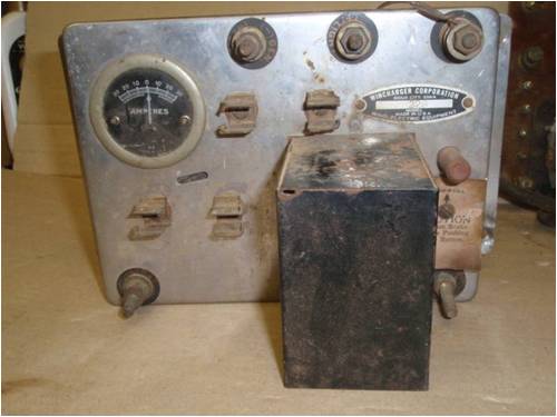

Had this old generator(1930)for a few weeks,I got from ebay 3 panels made by wincharger the main is a WINCHARGER CORPORATION SERVICE PANEL MODEL #326,now question,Can I use this panel with my wincharger 12 volt or is it for a diferent unit from the same company(32V,40V or may be 6V)I have photos of the 3 panels
Thanks for your help,Trobador

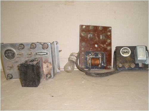

I really dont know myself, but it looks like you have panels from 3 different windmills.
The one you show looks to be the same as the one in the photo on the manual.
Others here might be more tuned in on the earlier Windcharger systems.
If i am correct the wind charger is self governing and you could just use a later electronic controller. (even a solar controller)
I am guessing the silver box on the panel is a voltage controller that is simular to the early voltage regulators used on cars with a double relay type arrangement.
I dont think these systems used a diversion load and the voltage regulator just cut in and out to maintain battery voltage.
As the mill is self governed it is allowed to sipn unloaded and the blade pitch is adjusted to control the mill rpm.
For this reason i would think a solar battery controller would work with this mill.
Lets see what others have to say.

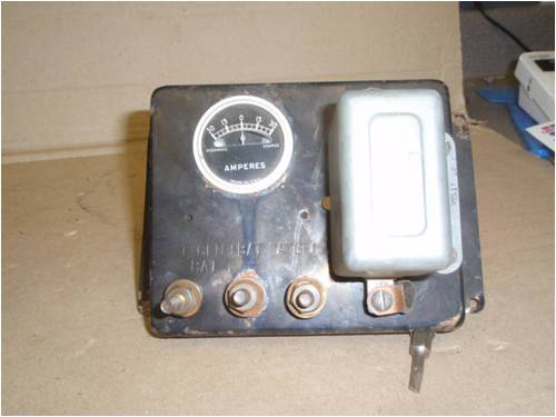

This kind of stuff is simple and it looks like it is salvageable, you will need a circuit diagram of the regulation system of the generator to get it going, I used to work on this type of equipment many years ago and it seldom dies.
Check the things for continuity with your ohm meter and check for shorts to earth, the left hand board looks like the regulator for the mill, in the box on it there should be a isolator relay and a regulator relay, check the coils on both for continuity and check the points to make sure they are clean, clean them with a piece of cardboard to clean their surfaces, if badly corroded use a piece of 600 grit wet and dry with some contact cleaner spray.
The clips are for the old type fuse, cant get them any more here, but you can connect them with a piece of fuse wire to get it going.
The center relay may be an isolator relay for 32 volt, the third panel looks like the battery feed panel.
Best of luck with getting it going.
The generator can be checked by putting a volt meter on the output and turning it by hand. Give it a full service Brushes, Commutator clean, New bearings, or repack the old ones if they are still in good condition. Check the propeller for damage , cracks and Balance re finnish with good quality marine paint and re balance, check the speed control vanes for mechanical damage and wear and freedom of movement. be sure balance is maintained.
