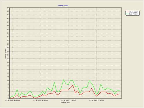

Hi All
This is a wind speed ms chart during testing of the dual voltage setup.
All the best
Bob

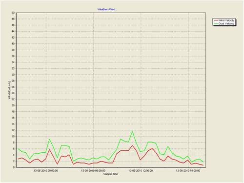

Posted: 11:24am 13 Aug 2010
Hi All
Back again for the second day of windy test weather the wind has been light and usable to test the GTI.
It has been connected for the last 24 hours and has been ticking away most of the time, I found that it needed a capacitor across the input to keep it from loosing synchronization with the mains, a couple of 500 uf in parallel to give 1000uf sorted out the problem of it dropping of sync between syncable events, it would hold sync down to 10 volts AC from the mill. At 15 / 16 volts AC it was doing rated output of 300 watts.
Wind Chart for the 24 Hours
It has contributed 1500 watts + for the 24 hours, not a lot but every little bit helps.
The wind has been variable for the 24 hour so give a fair idea of the yield.
