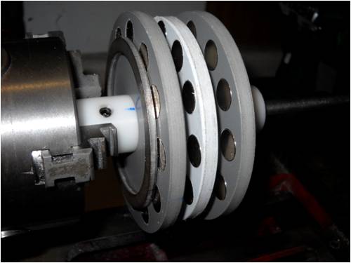

MacGyver
Joined: 12/05/2009
Posts: 1330
Posted: 01:27am 14 Aug 2010
Crew
There's a commercially-manufactured VAWT called the "Wind Spire" and there are several videos on youtube. If you count the rpms of the one shown "generating at speed" it looks like it's running somewhere in the vicinity of 300 to 400 rpm. One must assume, therefore, that the "cut-in" speed is somewhere at the low end of that range.
One nice thing about the axial-flux design is, you can build around the "cut-in" speed. There are many trade-offs, but if your mill only turns 400 rpm maximum, all you'll have to do is figure out a way to get more windings inside the air gap.
One way would be to decrease the wire size, but that increases the resistance; not the greatest choice.
Another and perhaps better method would be to increase the magnet thickness, thereby increasing the "sweet spot", which is at the middle of the air gap supposedly.
The gap size is calculated: 2 x magnet thickness x .75. So, if you were to build a ginormous-diameter and subsequently slower-rotating mill, the ax-fx alternator could be augmented to handle the slower rotation (I think).
In conclusion, I think a 'bigger-than-normal' vawt is a possibility. For me it'll never happen simply because I live in a city and the last thing I need is a hot-air-balloon-sized gadget whirling around atop a tower in my back yard!
. . . . . Mac
Copeville, Texas

MacGyver
Joined: 12/05/2009
Posts: 1330
Posted: 03:36am 14 Aug 2010
[Quote=itsandbits1] . . . doubling the rotor; one on each side of the stator . . .
FYI, this (two magnet rotors) is the 'standard' build. If you want to up it even more, you can place a additional set of magnets between the existing two plates, allowing each of their faces to see the opposite face on the wheel magnets. I've done this and I have a picture so you can see what I mean:
Doing this allows the intermediate magnets to force the magnetic flux lines to travel in a straight line while providing a 'return-circuit' for the flux at the same time. I'm not sure if when doing this trick the air gap is figured in the same way, but it's likely the same. When I did it, I used the same air gap as I would have used for just two wheels.
The magnets in the center wheel are press-fit and glued into a HDPE (high density poly ester) wheel I cut out from a flat sheet using the faceplate on my little lathe. Now that I look more closely at the picture, maybe I used foam-filled PVC; I dunno!
Hope this helps.
