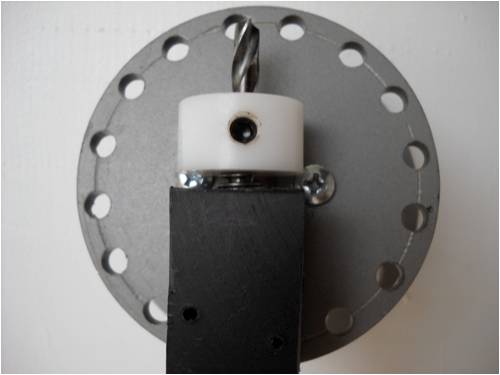

This shows the mechanism ("Tool") mounted to the root of a 3" x 2" x 4'
Coroflute blade. The shaft of the tool pinches the blade spar with two
1/4" x 20 screws tapped into the shaft. An old drill bit is positioned
inside the shaft at its center and held in place with a set screw. The
flutes of the drill bit extend through a block that has a "pin" (another
set screw threaded into the block) inserted so it is housed within the
bit's flute. Atop that is a spring and another block (round) used to
adjust the travel as well as spring tension against the block.

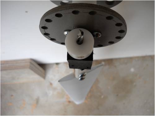

Here's a tight shot of the spring and keeper. The spring pulls the drill
shaft towards the center of the hub and the pin is set in a position to
hold the blade at 40*. As the wind spins the blade, centripetal force
throws the blade and attached drill bit outward, away from the hub,
compressing the spring and causing the drill-flute-pin combination
to twist the blade into a new position at 15* where the mill runs.

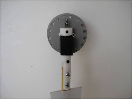

Here's a shot looking down the blade from the hub. This is the static
or stopped position of 40*. In a perfect world, as the wind increased
the speed of the blade, it would twist smoothly into its final "run"
position of 15*. In the real world it's all or nothing. I spun it with a
drill motor and it's either at 15* or 40*. That's okay, because in reality
all I was after was a way to get the blade to a steep pitch so it would
start in low wind. It does what I designed it to do.
