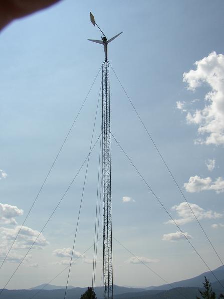

Hi
I put a bigger tail on my mill and now
it's working pretty nicely. 2 foot by 3 foot
3/8 inch plywood. I also added about
10 pounds in the tail boom to get it to
furl later.

Zowie! That tower and turbine look huge; nice work!
. . . . . Mac

that tower is huge~why don't you put a bigger turbine on it?

I'm working on it. I just got this one working.
1000 watt turbine is really about all I need.
When the wind comes up I am dumping most of
the power. Solar panels supply most of my power.
But solar panels are expensive and I have figured
out how to harness the wind for cheep. I am addicted
to building wind turbines though and playing with
the wind. So of course I'm working on a bigger one.
That's why I put up such a stout and sturdy tower.
I'm just getting started, its only been 20 years
of tinkering to get this far. I should have 2 or
3 times that still left in me (knock on wood).
