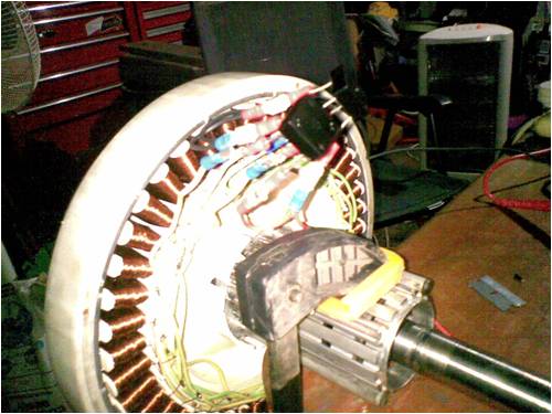

Hi Guy's have been reading your 4m's now for a few days and am liking what i read I have not gone into average wind speed as they have just built a wind farm down the road tower height is 65 meters (not that i can get that high)
What I'm planning is a duel F&P smart drive i got interested in these when i saw them on ebay rewired and decogged for around $90au + PH turns out 2 was going to set me back about $250 to get them so i went to the local tip and found 1 almost straight away I'm in the process of rewiring it now using 7x2c Delta trying to get the best from our weather conditions.
What I want to know is what coil con fig would be best for the second 1 I was thinking of 1x6c and 2x4c as in gizmo's rig would these coil config's work together?

i would suggest having both stators use the same wiring config or else youll get different voltages from them.

You do not have to have the same wiring configure on all motors. You can stagger them if you want. Staggering will not affect the output so to speak it will just change the cut in speed and the amount of power you get at different speeds. There are allot of posts on this topic. Some say this works better and someone else will disagree, it will depend on the site you have and the output you want to get. There are so many things to think of before you go into it so keep reading and asking questions as the only silly question is the one you don’t ask. Most of the members are very willing to help and will give you allot of information to think of before you take the leap.
You can mix DC voltage but DO NOT mix AC or it will fry the lot.

Hi all thanks for the welcome i have just finished rewiring my first of many stators today as I said earlier in 7x2c delta, and decided to do a test using a power drill to run the mill. and got around 70vac at 5 amps on z and z1 i guess your all familiar with the wire output code for what i have done but when i tested over x - x1 only got around 50vac at 3 amps is this typical behavior for the stator or have i made a mistake in the wiring? or am i testing across the wrong coils?

You are far better to rectifie the 3 phases and measure the DC voltage.
Doing a test with no load connected is a little useless as it tells you nothing really. (other than you are making voltage)

I took your advice pete and wired in the rectifiers still only using 2\3 the power output (thanks dick smith only having 2 rectifiers) Then loaded it with a handful about 15 100k resistors (they popped but it was fun to watch) my poor drill didn't like it much either it looked to be running at around 50 - 100 rpm putting out about 6v didn't get time to test amp's need a better load controller will put something together and do some more testing
Here's a pic of the test unit sofar
I know its rough but it works
I'm also thinking of making a coil face plate for the test unit the face plate will be a bread board of sorts so i can chop and change coils (without the need to solder all the time) to find the best results and tune the stators to the mill.
