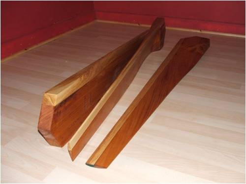

a while back i did try Altons calculator ...(apart from the ideal big root angle) i,m not sure if you mean extending the blades or eliminating the inner section ...
i think if the roots were trimmed a bit and blade extenders were used the drop angles at each station would be confused a bit ..the tsr would be different as was mentioned before and the blade sections wouldn't be as well matched to the swept area they rotate through
...plus you'd miss out on a nice big mounting area to secure them together and onto an alt Edited by niall1 2010-09-08

ps. Nice set of blades there naillEdited by Gizmo 2010-09-08
