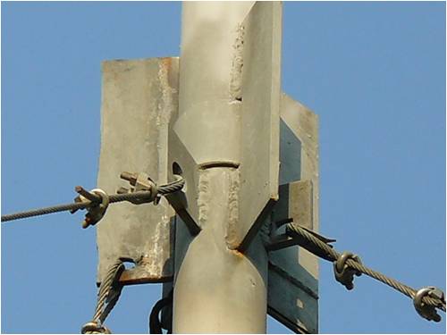

imsmooth
Joined: 07/02/2008
Posts: 214
Posted: 03:01am 19 Sep 2010
This has worked out very well for me.
guy wire attachment for tower
Robb

This is what I use. Only one guy is shown for simplicity. The guy goes right around the tower inside plastic hose and the welded peg stops it going down.

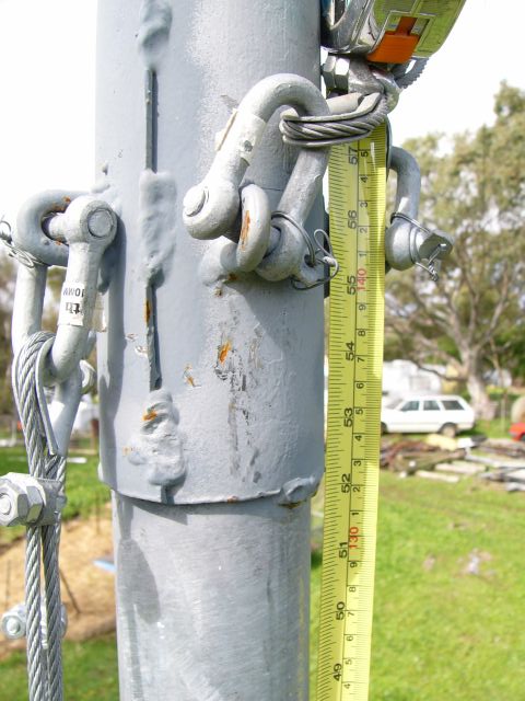

Foolin Around
Greenthumbs
Joined: 05/12/2008
Posts: 40
Posted: 12:02pm 20 Sep 2010
Hi guys,
I used chain links cut in half then welded to a outer pipe which was too big so I cut it lengthwise then welded it together after clamping it hard up to the mast.
Then small staggered welds top and bottom to hold the outer pipe from moving.
The idea being that the less you weld to the mast the less weak points you create.
I like imsmooth's idea too but my idea is a little less sophisticated.
Robb I hope you have staggered the welds up and down the pole a little so you did not create weak points. I did something similar with the cable that pulled the whole tower up into position.
Dom I know exactly what you mean, they use them on 4WD bull bars.
I was going to do it the same way but they do not do them with long threads. I wanted to put the thread right through the pole like a bolt and put a hude washer on the other side with a nut and lock nut.
Welding a nut to the pole is dangerous as it could come undone.
My father in law used to be a ham radio operator and made many towers, so high they had to have a flashing light on top for planes.
He said that it was most important not to weld all around the pole because of weakening. Every weld is a weak point.
Oh and note the bits of wire twisted through the D shackle bolts.
That is a safe gaurd for vibration. I did the bolts up with a spanner and dought they will come undone but my father in law said I would be suprised what could come undone.
So I followed his advice because he is rarely ever wrong!
My tower and mill went through a massive storm a few weeks back the weather station I owned had its cups blown off. The mill had all its blades and tail ripped off too.
Just a stump on a pole left.
But the 13.5M tower did not move at all.
I live at the top of a hill and we get massive gusty winds so I hate to think what the max gust wind was.
My weather station has recorded on two separate occasions wind gusts of just over 300Km. It is a ebay cheapy so I dont know wether to belive it or not buit it has happen two different times....
Unfortunately the weather station was not recording at the time of the storm as it blew up a couple of weeks before when water got into the transmitter. It would have been nice to know what the max wind speed was at the hight of the storm.
Damo
