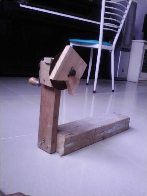

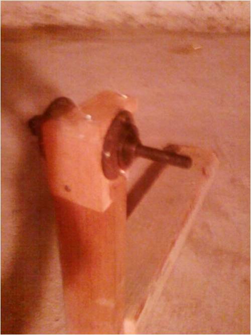

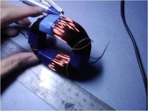

i made my first coil this morning by hands,and it looks horrible.
so i made a coil winder,it's not finish yet,i hope it works well.
my first turbine assembled by 8 magnets 6 coils,i expect it have potential to produce 200w at 4m/s.
diam of copper wire, 1.08mm , 130 turs per coils.
is there anything wrong with this design?

i think the coil just too thick.

Posted: 01:27am 23 Sep 2010
Yes, it is too thick. With my winder I have two plexiglass discs on each side to contain the coil. When I am done I use some superglue to keep it tight. I add the superglue and wedge the coil between two metal plates and some clamps. This keeps each coil fully compressed.
Downwind
Joined: 09/09/2009
Posts: 2333
Posted: 02:36am 23 Sep 2010
Hi you need to make a frame to wind the coil onto that has 2 plates 1 each side so it will keep the coil shape.
The coil will need to be 2/3 the width of you magnets.
So 4mm magnets will = 2x4 = 8 /3 = 2.667x2= 5.33mm thick
So for your coils they will need to be 5-6mm thick.
