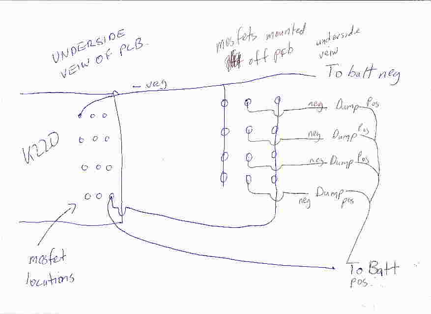

Also if you want to place the mosfets off the board is this how to wire it?

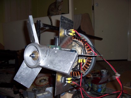

here's a pic of some dodgey welding, the big plates are aluminium where the rectifiers are mounted, I think they may be a little big and could effect furl action?
your input would be greatly appreciated

Yes you could use the mast connection as one electrical connection, but there are a few little things to remember. 1. The mast connection may be a little "dirty" for electricity, and cause one phase to be a little erratic in its output, and 2. You will have one phase connected to ground, this is OK so long as the DC after the rectifier is always isolated from ground, ie dont connect the batt -ve to ground.
Yes two Oatley regulators connected on the same battery will work fine, even with different switching voltage adjustments.
I dont have a copy of the Oatley circuit, but it looks like you could connect the MOSFETS off board like your drawing.
Dodgey welding is ok so long as there is lots of it

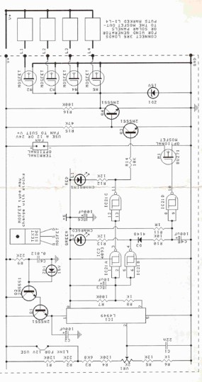

Here's the wiring for the 220.
I think my conversion is right but no harm to check.

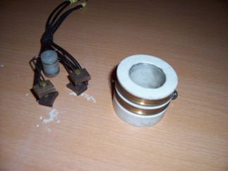

hi highlander where did you get the sliprings and brushes from and do you have some more pics of the brush holders? thanks matt

matt a neighbour gave them to me from an old mill parts box.
They are in the shed somewhere I'll have a look.
I wasn't going to use them as the wire can only handle maybe 30 amps.
The connections inside the sliprings are covered but the wire in there is probably the same size.
