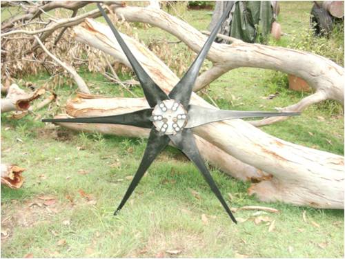

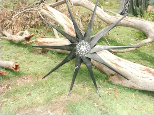

I have tried these type of blades and they are not like the Altons blade calculator, a 6 blade 62"diameter performs a little less than a 8 ft three blade and the 11 blade 68" one performs better than the 8 ft 3 blade above 8ms and also starts in less wind but is lacking below 6.5 MS.
Even though you can factor in the extra blades to the formula it makes no difference to the calculated results, but in fact there is a big difference.
Altons calculator works OK with a 2 to four blade clark Y type airfoil but doesn't work with the high speed airfoils on these blades.

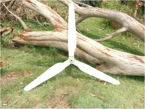

I have a 3 blade 62" clark y type blade and it wont even start till 4 ms, whereas the 3 blade 62" starts at 2.5ms and is generating 100 watts by the time the clark Y blades start up at 4 ms.
They have a lot higher TSR and during one heavy wind they got to 1600 rpm.
These are some of the blades I have been testing
The six blade was the best compromise for the alternator tested on a 600 watt unit
The white blades where the original blades and needed 12 ms to get the same output as the 6 blade at 8 ms, the 10 blade set started earlier and overdrove the alternator at 8.5 ms better for low speed power but not enough to go the extra expense.
I tried them on the other mill and they did over 50 amps at 30 volts in gusts of 12 t0 15 ms.
I found that none of the testing conformed with Altons formula with these high speed blades, but the 2.8 meter 3 blade I have on it at the moment is close to the mark.
