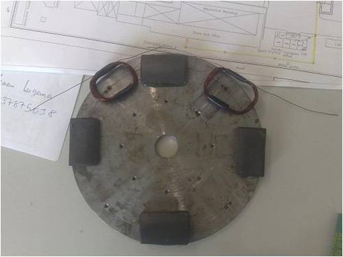

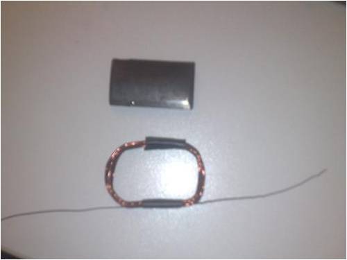

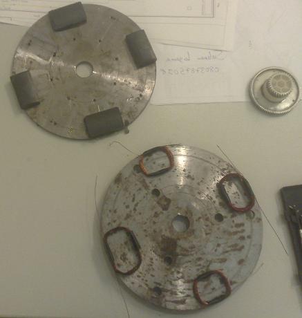

arewa
Joined: 24/10/2010
Location: Nigeria
Posts: 11
Posted: 08:32am 02 Nov 2010
Hello Mac,
Here are description on pictures of the rotor and stator discs.
the coil is guage #29
Magnets are N-S-N-S
Coils are in Series
Happiness starts with the begining of knowledge

Downwind
Joined: 09/09/2009
Posts: 2333
Posted: 12:50pm 02 Nov 2010
I see a few things wrong with both of what you guys have done???
Firstly why have you mounted your coils on a steel plate??
Secondly mounting your magnets on a wooden plate is wrong too.
The magnets need to be mounted on steel so as to complete the flux path of the magnet, ...wood is not good.
I am all for trying things, but some rules need to not be broken to get the best out of your build.
Pete.
Sometimes it just works

Posted: 02:13pm 02 Nov 2010
  Downwind said   I see a few things wrong with both of what you guys have done???
Pete.
Yes, I thought that was an odd idea too, perhaps learning to walk might help before attempting an alternator building marathon .
BTW Pete, there *is* a possible place for magnets on a wooden plate, it would be on the middle rotor of a 3 rotor machine . I built one but used perspex instead and the round magnets were sunk into holes in it.
Downwind
Joined: 09/09/2009
Posts: 2333
Posted: 03:46pm 02 Nov 2010
Good point Tinker but i don't think it is the case with kevindion.
arewa
The metal coil plate will cause drag on the alternator and make it stiff to turn.
Normally you would have a metal plate either side of the coils and magnets of opposite polarity on both plates, so as each magnet passes over a coil it has a north magnet one side of the coil and a south magnet the other side of the coil.
You may be better with the magnets and coils 90 degrees to how you show them.
I take it this is a single phase generator.
I am not sure what you mean by [quote]Also, i read something about coiling that: if the first is turned clockwise, the next need to be counter-clockwise.. does this law really matters?[/quote]
I thing you mean how the coils are placed in the stator...if so...........
As for the coil windings and the direction of the windings, they will all need to be in the same direction and not reversed to one another or they will cancel each other out.
Also the wire that is in the centre of the coil needs to connect to the wire on the outside of the next coil and so on to series them correctly.
With your coils so far apart you will have a very noisy generator, as you will get a donk, donk, donk noise as the magnets pass the coils.
Also your electrical wave out will be very strange with a peak and a big flat spot in between each peak.
Adding more coils will help and more magnets will increase the results greatly.
Your coils look to be different sizes and different shapes to each other and also different number of turns of wire on different coils, and if so, this is not good in all 3 cases. (bit hard to tell from the photo)
I don't mean to sound harsh, but you are putting a lot of work into a rather poor generator here.
If you are doing this for a bit of fun and don't mind a poor result then continue on, if you are trying to make something of a reasonable output than you will be disappointed with the results for all the work you put in.
Pete.
Posted: 01:31pm 03 Nov 2010
Pete, looking at that 'intriguing' design again, which I think is supposed to be a single phase affair, a thought occurred to me.
What if the fellow has only 4 magnets? Could he then fit the magnets on one steel disk and have the second blank steel disk also rotating on the shaft, with the fixed stator (coil) plate sandwiched in between the two? It would not cog. It won't be as effective as having magnets on each plate but much better than having only one magnet rotor.
Downwind
Joined: 09/09/2009
Posts: 2333
Posted: 02:31pm 03 Nov 2010
Hi Klaus,
Yes that will work, and has been done by several others on a different forum.
It is still a lesser design and needs very close air gaps, and with the curve shape of these magnets will add to making it even less efficient.
I often feel i am being negative to peoples designs, but also feel not saying anything dont help others learn and work to improve their creations.
I think with only 4 magnets and big gaps between each coil, it will be like driving with square wheels on your car.
With limited magnet strength it will be very dificult to stop the mill becoming a runaway in reasonable wind.
My guess is it will preform poorly and will self destruct in good wind, as a runaway.
There is as much work in making a lesser mill, as there is in a good one, but the magnet cost is the big difference.
Although we should no loose sight of the fun factor we get form building something.
Pete.
