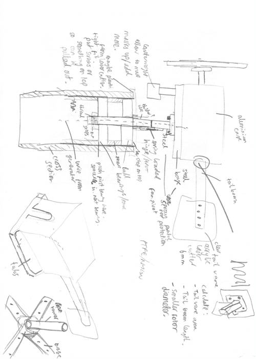

I am designing and making a wind turbine for my last year school project. The image I have attached shows the very rough sketch of my intial final design. The scales are off as the rotor diameter will be 0.8metres to 1.0 metres, but the drawing just serves as a way of helping me understand my design.
My problem is the pivot point which allows the top part of the wind turbine to tilt-back in high speed wind conditions. I went for this method of protection so I could simplify the design so to speak, due to limits of money and materials. The problem is that I dont have a great idea of allowing the top part of the wind turbine to tilt back.
If you have any advice on this problem, or on any other area in the rough design, could you please help me?

hodgepodge,
Welcome to the forum.
Your tilt back idea has been tried by several (not so much here on this forum) and it is far from the simplest design and has one great problem.
That is, as it tilts back it creates a big giro and has some very brutal effects.
The most simplest form of control is a tail and yawing the mill.
This is a much more user friendly method.
If you want information on tilt back systems i think i have seen several on "OtherPower.com " forum.
Perhaps you would like to explain you design some in words as the sketch is not over clear of what you intend to do with what components.

I think you picked one of the tougher ones to try. that being said. I had an idea for making one using a hood closer damper or one from the back lid on a hatchback. They have the iinternal pressure and a slow return so it would not slam back and forth. If you expect it is going to get used a lot I would put one each way. Or for hd use an ordinary car shock absorber with a spring

I did intend to use furling to protect the wind turbine but honestly could not fully understand how to use it on my design as you can see in the drawing above. I spent hours trying to understand and make up a furling system for the wind turbine in the drawing above, but to no avail. What would I have to do? I kinda get about offsetting the tail and whatnot, but fail to understand what happens when the tail furls and how.

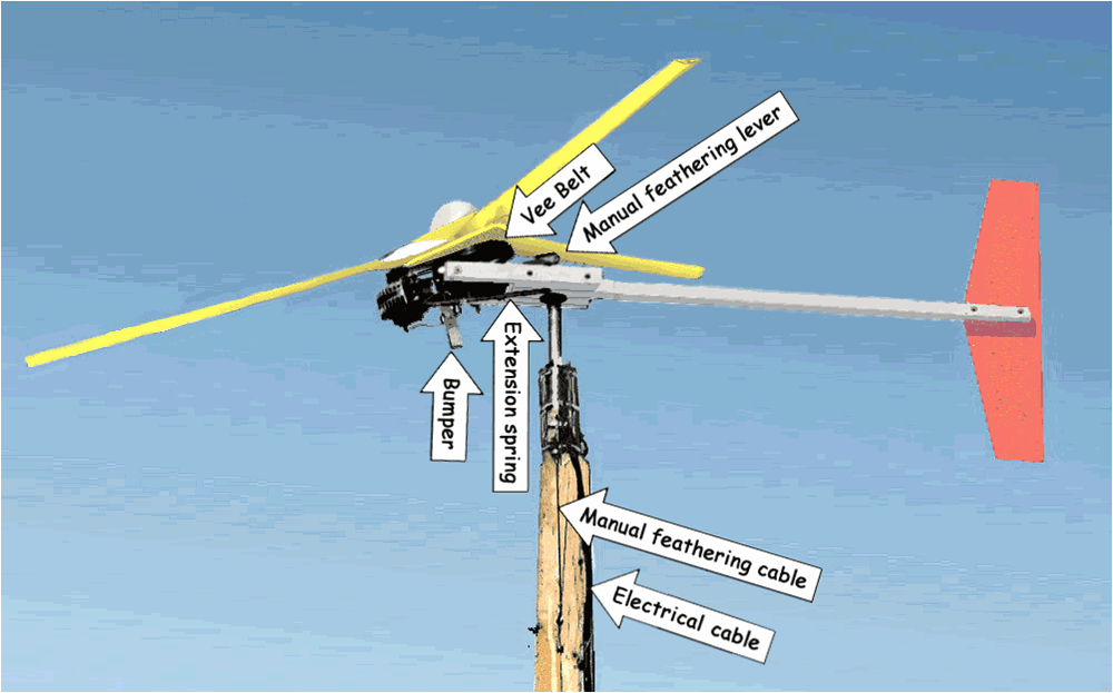

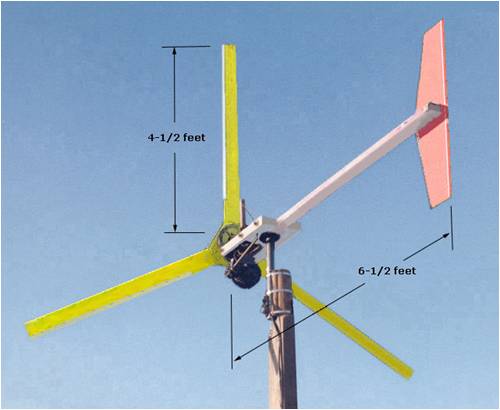

Here's a couple more pics. This isn't my turbine and I can't remember where I found them on the web so someone out there deserves credit but I think they illustrate an easy way to accomplish what you are trying to do.
Perry

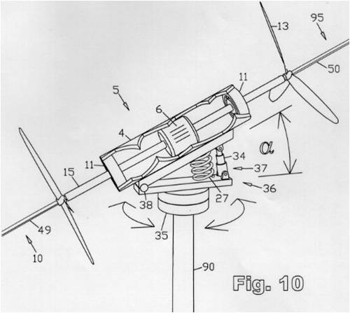

Here's another way to make a tilting system that looks to be pretty easy and straight forward:
I lifted this picture from here: http://www.speakerfactory.net/wind_old.htm
In your case, the spring tension could be such that at a pre-determined wind speed, the pressure against the blades could overcome the force of the spring. Also, an "emergency furling system" could be built by merely having a rope dangle from the top of the yaw platform; you could manually yank it down in a storm.
I know the picture shows it "running" in what would be a "furled" position for you, but I wanted you to see the spring-loaded platform. Instead of compressing the spring, yours would likely pull against it; same difference. Also, the emergency yank cord would likely pull a pin or you could even take up the tension with it and tie it off on your tower with a small boat-tiedown fitting.
