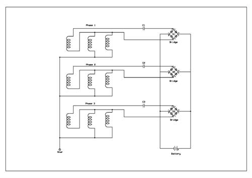

An idea i have been thinking about, is winding a set of coils for a 2 stage cutin.
The theory is to use 2 wire sizes in the windings, 1 large gauge wire as normal and a lighter gauge wire.
The large gauge wire would be wound as per normal for a standard calculated cutin, while the lighter gauge wire would be wound with up to twice the turns for a cutin of half the speed of the main windings.
The light windings would give a lower amp output but would contribute some current at low speed where as there would be normally no charging taking place.
It should work similar to a cap doubler. I am not a fan of cap doublers and think they are a good bandaid for a bad design alternator.
I have not seen anywhere where 2 stage coils have been tried, but like everything it would be foolish to think it has not been done before.
I have spoken to several people on using this method and so far no one has found a problem with the design idea, so i am asking the masses what your thoughts are and can anyone see a problem.
My thoughts was to wind the wire strands in hand within the same coil, a discussion with Gordon on this and his suggestion was to wind a lighter coil in the centre of the main coil.
A discussion with Glenn and his suggestion was to series both coils as you would with a centre tap transformer.
This has advantages, being the need for less copper wire as the main coils would be used in conjunction with the lighter coils.
It would make for the need to separate rectifier each windings on the mill head and bring DC down the tower or have extra sliprings for the second windings.
Looking at a F&P stator i see no reason that light gauge windings could not be added to the outside of the existing coils to achieve the same results.
The wire size of the light windings is not that important and would be what ever you could fit into the gap available,
as normal the larger the wire the greater the current output, but the current dont matter greatly as it will give something where normally you would get nothing.
1 or 2 amps at low speed i think is a great result, the wire could be as fine as cotton or as heavy as can be physically allowed by the space.
It would be a bugger of a job adding the windings to a F&P but think the results would be worth it.
Winding coils for a AXFX mill for dual cutin should be reasonably easy.
You would not want the light coils to heavy in wire size so as to load the mill excessively and prevent it from reaching the normal cutin speed.
Open to thoughts and ideas, and any information on where this has been tried before and the results.

Posted: 12:53pm 31 Oct 2010
Hi Pete
Yeah I think it has potential. I have a suspicion the AirX turbines use two different windings, one with many turns of light wire, and the other less turns of thicker wire. Each is rectified separately. One winding cuts in earlier, so makes use of low winds, and with its higher resistance, it wont load the turbine too much, allowing it to speed up as the winds increase. In higher winds the other coil cuts in.
I did some work with staggered stators a few years ago, similar idea, but using the existing windings instead of adding additional windings. My best performing windmill was a dual stator with staggered windings, it had 4 different cut in speeds! It would be running most of the day in light winds, making a amp or maybe 2, where the previous windmill wouldn't be making any power at all. As the wind picked up, so did the current, without a big increase in turbine speed. Each stage would add a bigger load to the turbine as it increased in speed. It matched the wind power very nicely. http://www.thebackshed.com/windmill/articles/StaggeredStator s.asp
Its a idea I wanted to develop further, but had to pack it all up. I still have the dual stator, and think it could match up to a set of the extruded blades well.
You idea of winding an addition coil over the existing F&P stator is a good idea. There is enough room, especially on a 100 series stator, a stator which could benefit the most I think.

Hi Pete
Sounds good to me as the fine wire would fit in the coil space of the larger wire with the balance wound either on the inside or the outside, the biggest drawback I think would be the extra set of slip rings required to keep all the guts of it in the shed.
The other one is to leave the standard windings and get an early cut in with a down converter taking the whole lot down to charge voltage.
I know that would require some electronics, but can be set up to bypass should the down converter fail. It could be made much more reliable than a lot of the regulators getting around.
On my old Chinese mill that I have had running for a while I use two sets of rectifiers one pull the lower voltage out to a grid feed Inverter, it works up to 10 amps 280 watts and then limits at that due to the internal regulation on the GFI, At about 5-6 amps it starts to feed the batteries and then goes to 30+ amps into the batteries wind speed dependent. An interesting point on this is that it makes the cut in to the battery earlier, I feel it is by loading the coils and making the generator work a bit better.
With the Cap doubler the best it would was 2 amps into the battery. 56 watts.

Hi Pete,
For those windmills already out there, the same voltage boost cct can be achieved with some additional low power transformers and separate rectifiers. The same 3 slip rings can then be used, so no tower/alternator mods. The transformers secondary windings would be star connected to the main 3phase outputs. The primary outputs would be individually rectified and connected to the main DC leasds after the primary rectifier bank. The turns ratio would be 2:1, primary:secondary.
For the F&P mod, or other alternator mod, resistance may need to be added to current limit and prevent blade stalling. The wire guage/total resistance of the additional windings has to current limit at above normal cutin.
Gordon.

Hi Pete,
I have been thinking about this dual stage cutin approach, following our telephone conversation and the only way that I can see it working is not with multi tapped coils, but with 2 sets of isolated windings in each coil. You could only use a tapped winding, if all the coils in each phase were in parallel, and not in series. [I think the potential for circulating currents with parallel coils would be high, as in a delta config on an AxFx].
I see essentially a normal star connected 3 phase, 3 series coil per phase stator, with a second set of 3 seriesed windings added to each of the phase ends. This would result in a tapped winding.
It would then be possible for a main low turn count phase and a higher turn count phase to be on each phase.
This combo would work in conjunction with a series capacitor/rectifier output arrangement on the higher total turn count output. The lower turn count output would be the normal high current output to the main rectifiers.
There would not need to be a capacitor voltage doubler in this case, as the additional voltage would come from additional turns.
This would suit a windmill that was wound for the winds normally expected. There would be a slight improvement in low windspeed efficiency, as there would be only 1 set of rectifiers working to direct the current, but the copper required for the additional winding would take up space that could be used for the main winding, that would reduce the resistance that could improve performance of an alternator that was wound specifically for high windspeed power.
There is another way of winding this alternator. There could be potentially a slight harmonic power imbalance but, this would involve winding say, 2/3 of the coils the same with an optimum wire size to get the max turns with the lowest resistance. One of the coil positions in each phase could be a specially wound coil, consisting of a remnant of the thicker wire to give a tapping for the bottom end, that could change the high power winding turns a small percentage. The rest of the coil space would be of a thinner size wire, that could have multiple tapping points. This would be added the the free phase ends to make up a higher adjustable output voltage.
I can see a very adaptable prototype alternator to be made, rather than making a swag of stators.
I think you were on to something with this thread.
The only down fall I see with this is that any rewiring would need to be on the stator, and will require rectifiers and caps on the mill head.
There is potential here for a windmill that would have a variable impedance that would have an output that closely matched the wind energy. This would be a slightly harder coil build, and would be a similar load matching as a cap doubler, but would require mill head rectifiers and a DC transmission line.
I have tested most of the aspects, and this method is a lot easier than any electronic boost arrangement.
Gordon.

What we are thinking of testing, is this configuration of coil windings as Gordon has explained above.
There is advantages and disadvantages to this configuration but nothing ventured nothing gained.
It will require for more windings per coil to get the higher cutin right but with parallel coils it will increase the current and with a series coil it will increase the voltage, giving a trade off with the best of both worlds.
Well thats the theory anyway. (yet to be proven)

Any idea how this turned out?
I'm new to this but am building a 24" diameter 36 coil axial flux with the thoughts I could make it maybe 6 phases and wire 3 of them with one gauge wire and the other 3 with thinner wire. Not mixing the wire on the same coil but wired on there own.
My goal is to get something out of the less than 5-6 mph winds we have here 50% of the time. I'm building a "stealthy" ducted drag vawt with 2x2 foot blades @ 12 foot diameter that will be directly on top of my shed so no poles or fast spinning blades for the neighbors to worry about. Ideally this large mill will be able to convert even a little wind and make some energy
I'm still reading the 41+ page post on using capacitors to step up the voltage but I'm not getting quite all of it yet...so I'm not sure which route to pursue?
Thanks, Jim
Posted: 02:19am 28 Jun 2011
Hi Jim
I think there is a bit of confusion between phases and output wires. Phases is determined by the number of magnets to the number of coils. Just about every alternator discussed here is a 3 phase machine, no matter how many coils or leds there are. For exacmple, the stagger coil alternator I was playing around with a few years ago had 2 separate coils sets wired up, to give 6 output wires, but it was still only a 3 phase machine, even though the two sets had no electrical connection. The number of phases is more to do with the timing of the output sinewaves, not the number of wires.
36 coils is a good starting point. I assume you have 48 magnets, making it a 3 phase machine of the usualy layout, thought there are other combinations of coils and magnets that can also make 3 phase power. 36 coils means 12 coils per phase, and thats a good starting point for a staggered stator. 12 divides down nicely, a string of 12, 2 of 6, 3 of 4, etc. You could dial up a wide range of output voltages. Would it be possible, if a bit messy, to bring all coil wires out of the stator?
jamesshaw89
Joined: 22/06/2011
Posts: 3
Posted: 11:21am 28 Jun 2011
Hi Glenn,
I was using the wrong words, 3 phase yes...I'm using 48 magnets and 36 coils with 72 wires coming out. I was going to put them all on a wiring block so I could rewire them with jumper wires...I'm going to gather some data this weekend with different test coils to see what different gauge wire will output and how many turns.
In my head I'm thinking of the output coils however they are wired are like batteries where I can put them in series or parallel to get the volts or amps I'm looking for...
If I need more volts/amps I will be able to add another set of magnets or maybe magnets on only certain output coils? Creating another stage or larger stage?
Maybe a combo of progressively thicker wired output coils, some/all with magnets on both side and still be able to add capacitors to step a low voltage up maybe? ...if I understand it right I can run the mill into say a 24 volt battery bank to clamp the voltage and wire the GTI into the bank to keep it's input voltage happy...
I'm thinking I'll be limited by the thinner wire coils hitting their max amps before the thicker wired coils will...unless I can drop/disconnect the thinner wired coils out at some point?
Thanks, Jim
