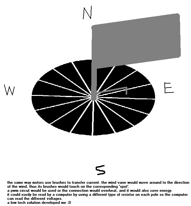

Posted: 05:55am 15 Oct 2006
the image is by now means how i would put it together but it illustrates what i am trying to say Edited by makourain 2006-10-19

Posted: 06:22am 15 Oct 2006
  sangeff said   Im in the middle of building a weather station and the wind vein will use a home made binary coded disk, 4 photo switches from an old brother fax machine and a 74/154 4 bit binary to 1 of 16 decoder chip that is now available as an 74LS154 , (check your altronics catalogue)
Suggest VERY strongly you don't use a binary code. Binary code may have multiple transitions trying to happen simultaneously - of course, they won't, and you get all sorts of bizzare things happen.
Use a "Grey Code" instead, if you want a digital output.
Alternatively, my professional Davis Instruments helicoid propvane uses a 360 degree "potentiometer". Ground on one side, excitation voltage on the other, and the wiper is between 0% and 100% representing 0 to 359 degrees.
In my own weather station, I simply read the analogue voltage, converted (ratiometric conversion) to degrees, and then added a constant for calibration and modulo 360 for the result. (Why do this? Well, it's a DAMN site easier to point the thing in a known direction, read the position indicated and apply a correction that then works across the board, than trying to climb up and down the tower tweeking the thing!)

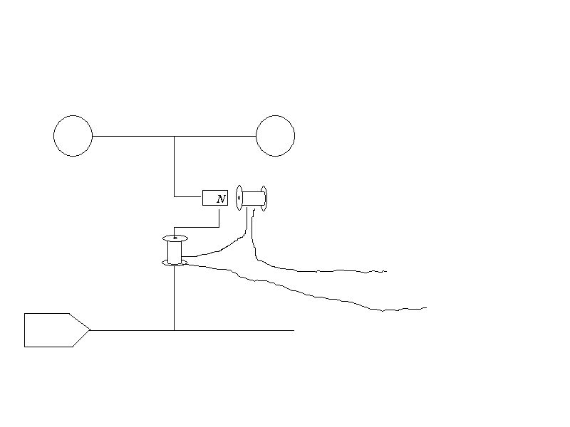

This is my scheme for an anemometer. There are wind speed cups on the top which pass a magnet over the pole of a pickup coil, every revolution gives a pulse down the line that is detected by the processor to give speed from the rate that pulses are received.
There is a wind direction vane mounted underneath and with its axis directly inline with that of the wind speed cups. This direction vane has a soft iron axis with a cranked end, there is another coil mounted around this shaft but not fixed to it, i.e. the coil is fixed while the shaft turns as the wind direction changes. Every time the magnet on the wind speed spinner goes past the end of the iron rod it causes a pulse in the second coil.
With the two coils in series the circuit gets two pulses for every revolution of the wind cups, one pulse from the fixed coil at the right of the picture and another pulse as the magnet passes the end of the wind direction cranked piece.
The repitition rate gives the speed and the time between the first and second pulse gives the direction.
Diodes, not shown in the diagram (because I forgot) fix the polarity of the pulses so that the processor can distinguish between them.
Two moving parts, no slip rings or moving reeds.
I hope someone finds it interesting enough to try and make one.

Posted: 07:34am 17 Oct 2006
No interest? No comments?
RossW
Joined: 25/02/2006
Posts: 495
Posted: 09:46am 17 Oct 2006
  KiwiJohn said   No interest? No comments?
ok, ok :)
Yes, I think it's interesting. The missing diodes certainly caused some confusion for a while though :)
I might knock something up if I get a spare hour, because it's pretty straightforward to prototype/test.

Posted: 07:04pm 17 Oct 2006
OK, diodes go across each coil and the coils arranged so that they produce pulses of opposite polarity. Maybe I should make one myself, Lord knows we have enough wind around here to test it!
RossW
Joined: 25/02/2006
Posts: 495
Posted: 08:24pm 17 Oct 2006
  KiwiJohn said   OK, diodes go across each coil and the coils arranged so that they produce pulses of opposite polarity. Maybe I should make one myself, Lord knows we have enough wind around here to test it!
I can think of only one "issue" - that is when the wind is comming from the same direction as your speed coil, you will have a cancellation of signals - either your negative pulse will cancel out the positive pulse and you'll get nothing, or they will *almost* cancel and you'll end up with only a small amplitude. If the latter, you could probably detect that and still deduce the right answers but you'd significantly reduce the noise immunity in so doing.
KiwiJohn
Joined: 01/12/2005
Posts: 691
Posted: 08:48pm 17 Oct 2006
You could be right Ross but I find it quite unlikely that such a state of afairs would exist for more than a very short time. Also I doubt that both pulses would be anything like the same aplitude unless deliberately adjusted. I think it would be best to engineer things so that one pulse is much greater than the other to avoid confusion.
Of course if noise immunity was a concern then four wires or processing at the instrument head would be options.
