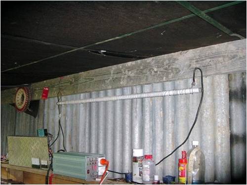

Hi duff one dump load I recomend is this it is is high tensile fence wire around an old tube light, Bullet proof and cheap!
I had lights but a power spike blew them!

A dump load is your last line of defense to keep the mill under control and it needs to be a reliable bullet proof system.
As Shawn quoted he had lights for a dump till a good windy day and the globes blew and the voltage went sky high and killed other electronic equipment, He resorted to running the vacuum cleaner for many hours to keep a load on the inverter to draw the batteries down so the mill remained loaded.
The fluro tube wound with wire was a quick and dirty way to get him out of a bind for the need of a quick dump load, it has worked very well for him and he has kept it as it was reliable.
Just wind some wire (steel wire)around a broom handle then slip it onto the fluro tube.
The longer the wire used the higher the resistance so the lower the amps it will draw.
If the mill is not being loaded enough in strong winds just shorten the wire length.
Shawn's system is 24 volt.

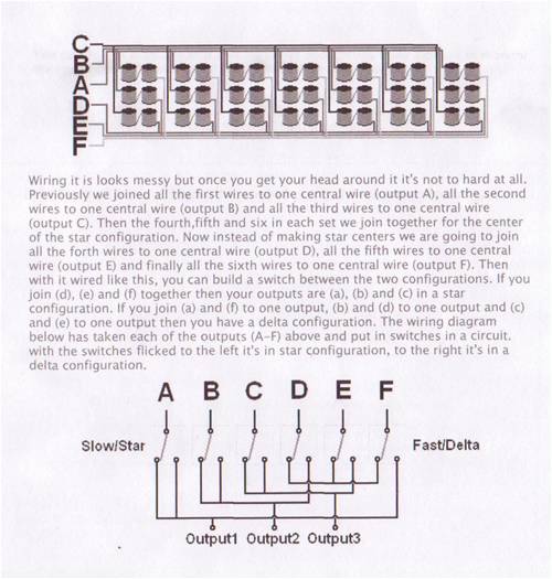

Anyway im not going to go on and on ,This is what i had i mind
Running a 24 volt system with a good bank of batteries .
here is a wiring diagram i was going to use .
Must say a big thanks to BigDog , he"s been a great help .
Anyway Thanks guys for all your imput its been great .
Slow down , little steps . Cheers Duff .Edited by energy man 2010-12-03

All very good, but what happens when the switch fails at some stage (as it will)??
What controls this and gives a hysterias or it my cycle a 100 times a second.
Star/delta switching has been discussed many times but there is always the chance of a runaway mill with a switch failure, if you are lucky it might just short the windings and hit the brakes.
Pete.
